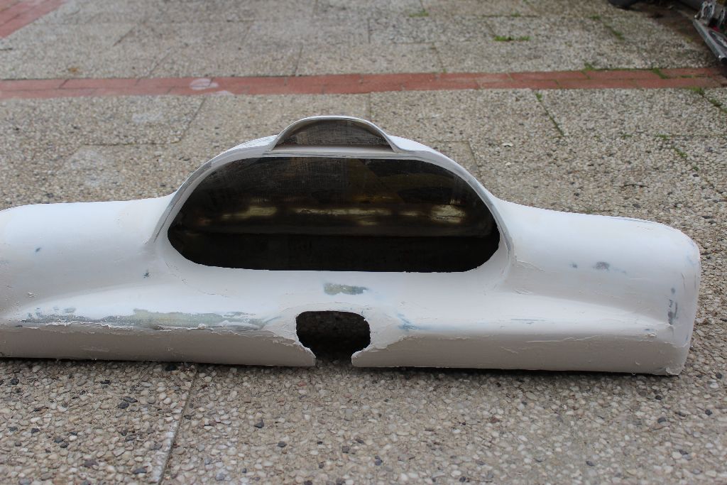

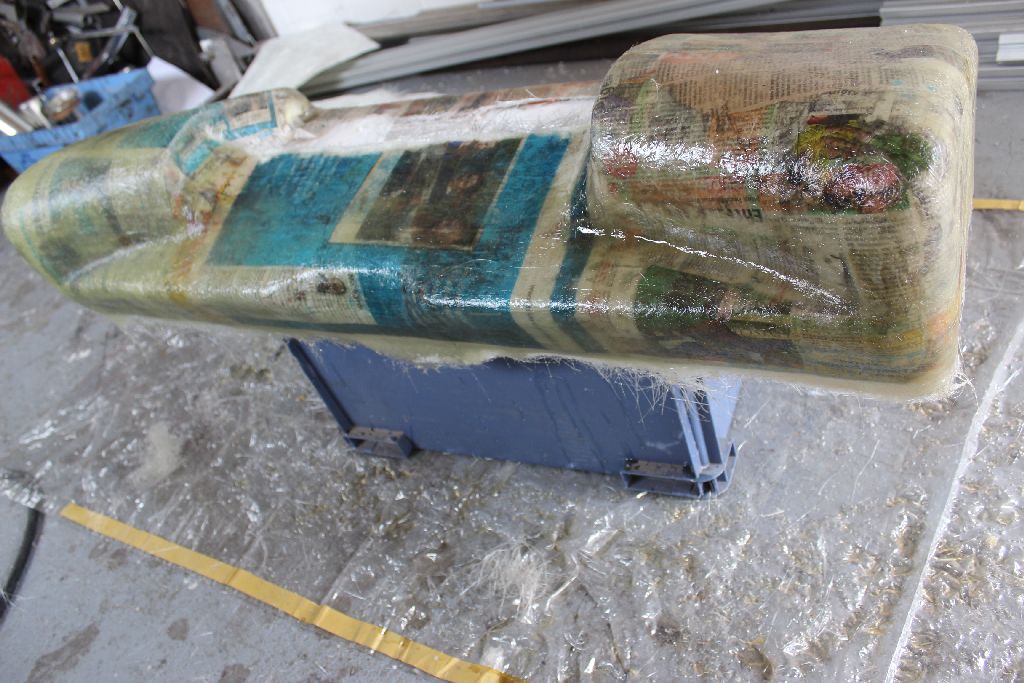

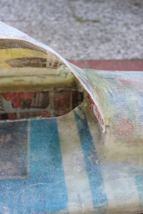

    Here is a short Tutorial how to make a Cockpit (or any other Case, etc.) from Polyster fiber.

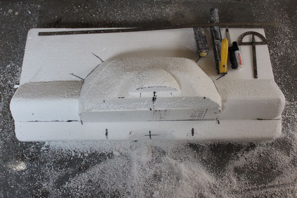

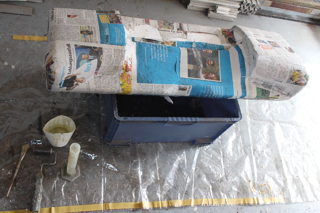

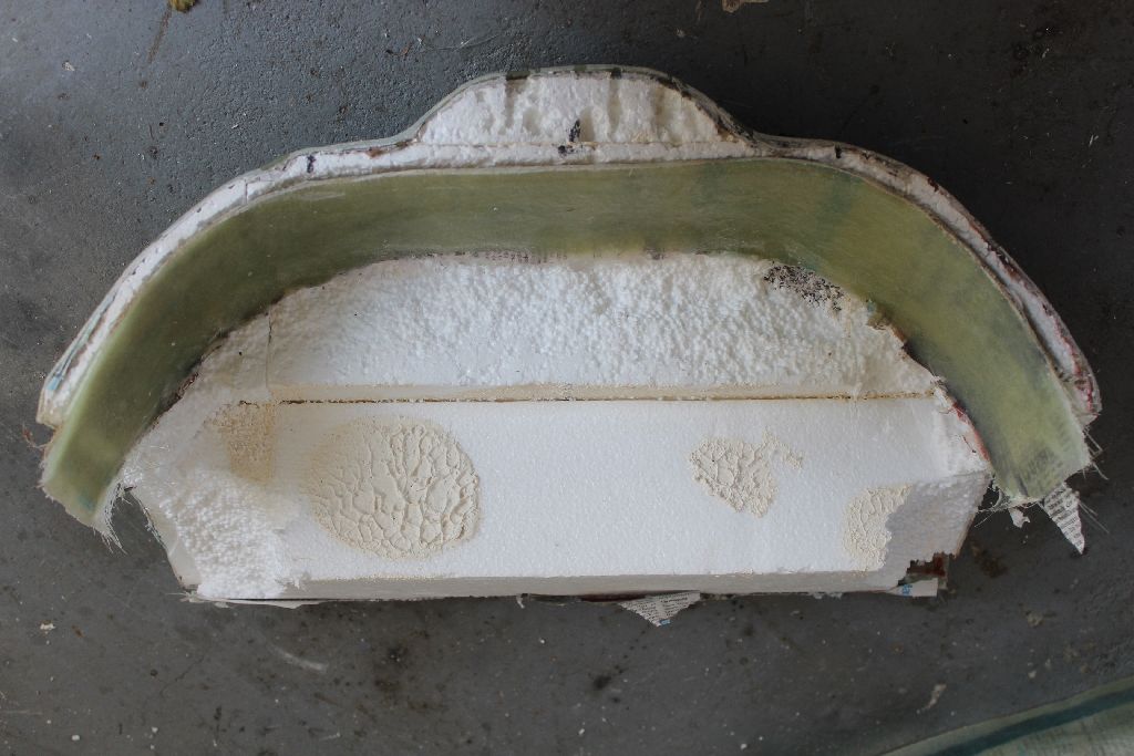

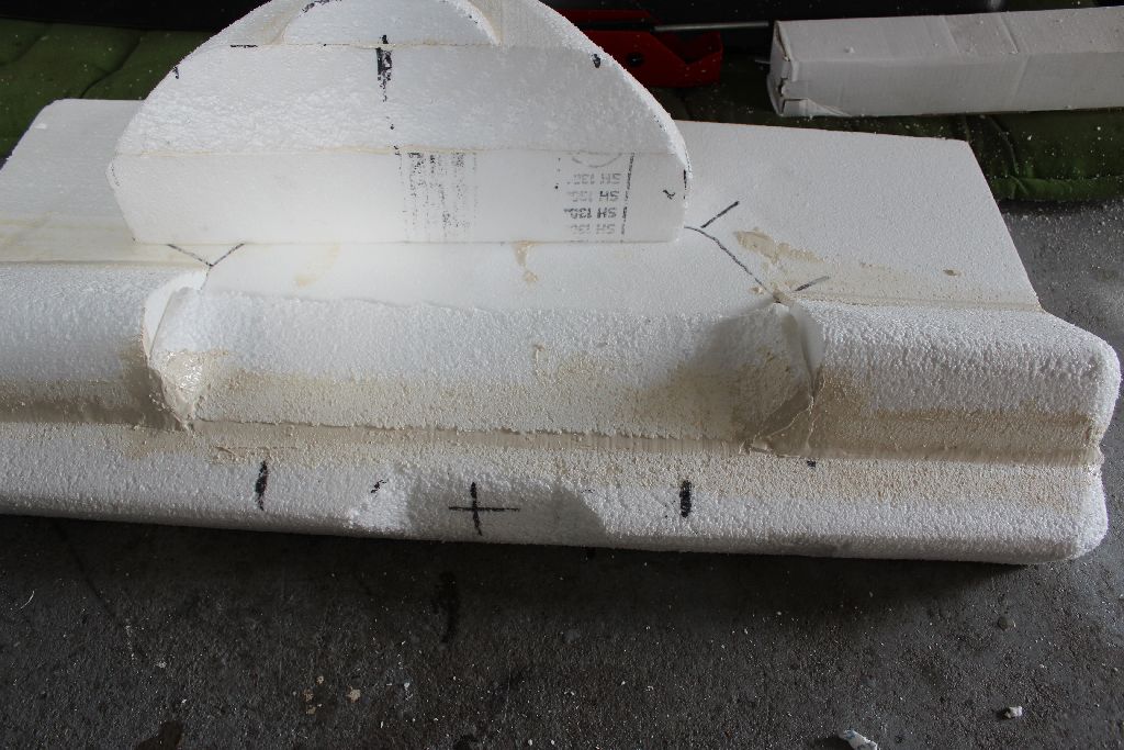

    First Step: We need a mold, here is shown how easy you can make a cheap lost mold.
    I took a block of Styropor an shaped out the form with a knife and a grater.
    The Surface should be smooth and symmetric.
    The Form of my Cockpit is a litlle bit to complex for a mold in one piece, so I had to split it.
    For a bigger form you can glue the Styropor togther with a special glue.

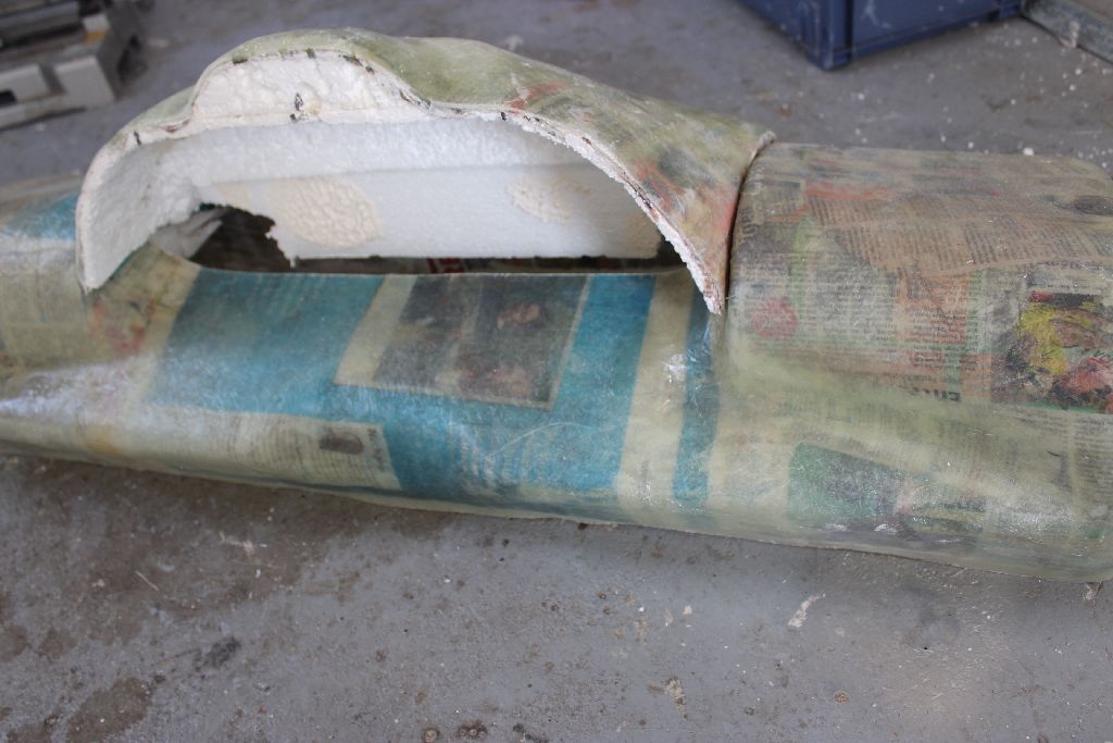

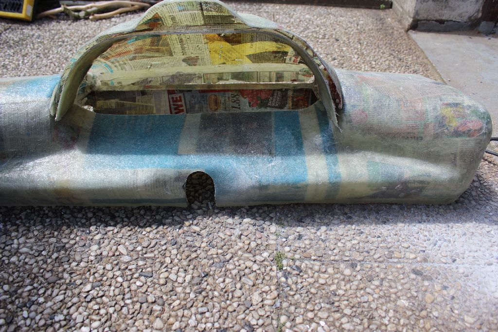

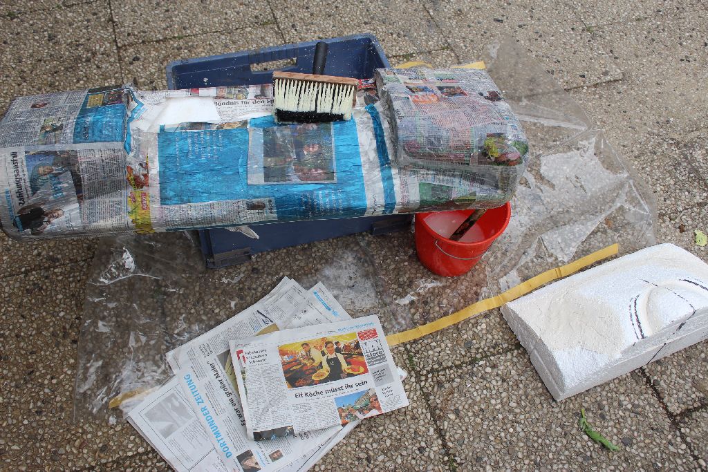

    Then you must cover the complete mold with wallpaper glue and newspaper.
    Cause the Polyester resin would dissolve the Styropor. If you use Styrodur you can skip this step . Styrodur is resistant, but much more expansive.
    Everything ready to laminate !

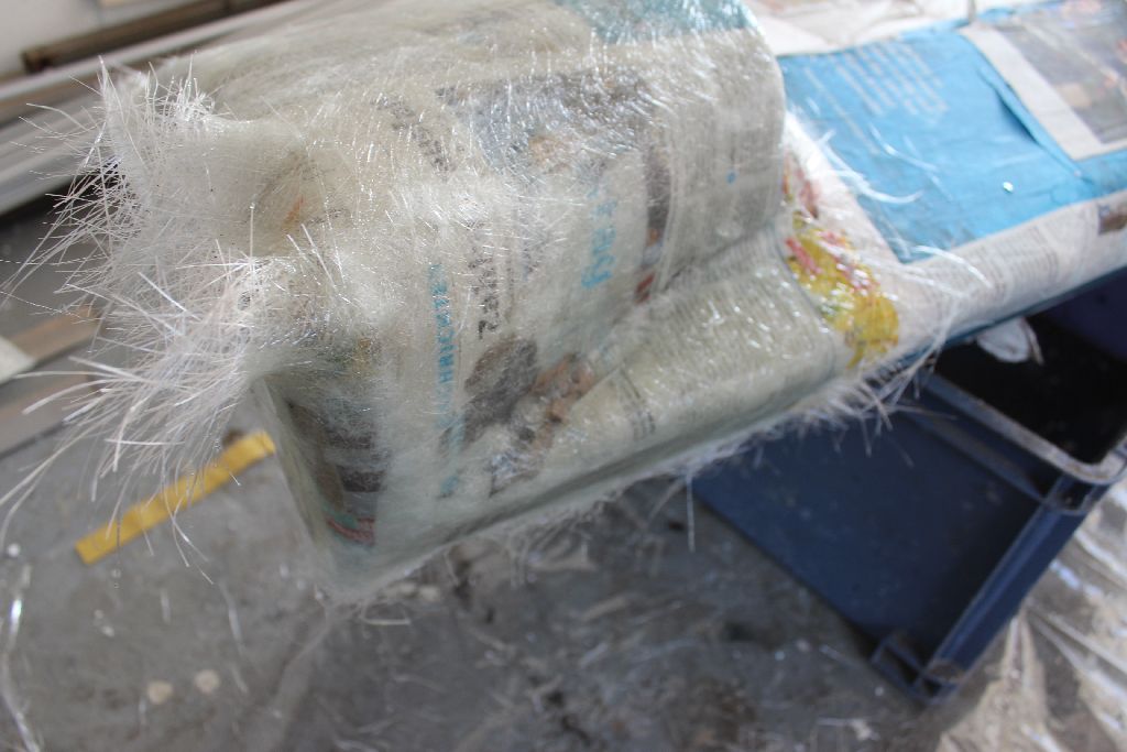

    Cut out some Fiberpeaces that fit the place you want to start.
    Saturate the mold and the Fiber and put the fiber in place.
    Then push out the air under the fiber with a short Hair Paintbrush.
    That is important for stability reasons.
    WARNING: Don`t mix more than 500g of Resin, the resin will get stuck in less than 20 min!
    Work in Progress!
    First Part is finished!
    Here the Parts for the Midle of the Cockpit
    Every thing fits together
    Cut off the outer edges and make everything ready for glueing together.
    Have an eye if it is symetric!
    you need special fiber-reinforced glue!

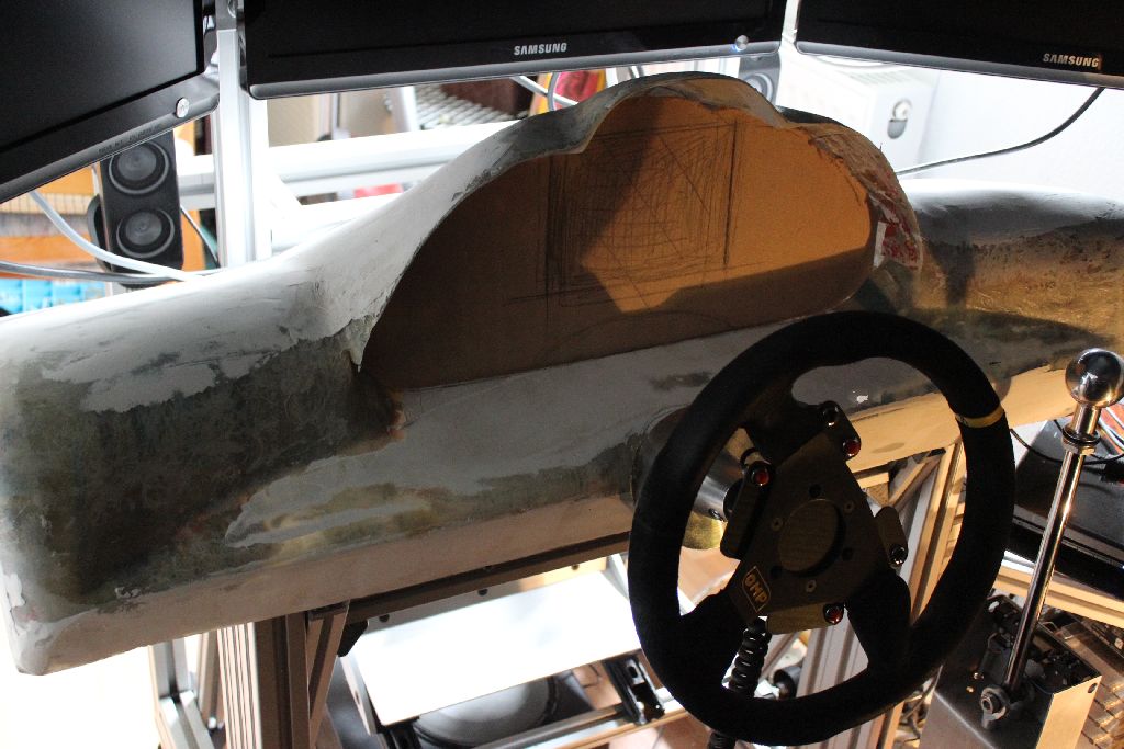

    First test, not too bad!
    You have to fill the surface for a perfect paint
    This is only a short Tutorial, there ar a lot of Videos on YT. Key words: Doorbords, RC Plane Body
    For a first attempt this is possible to difficult.
    Try to make a Button Box, You can use your Girlfriends Tupperbox as a positiv mold!
    It is really easy to get good results and it is not more expansive than Metal or wood .
    Find out a company those who make car Tuning Body work or RC Planes.
    Speak to your local Car Painter for hints!
    If you have found a company they will supply you with every thing you need !
    Thanks for your attention
    Kai

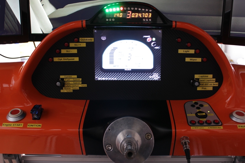

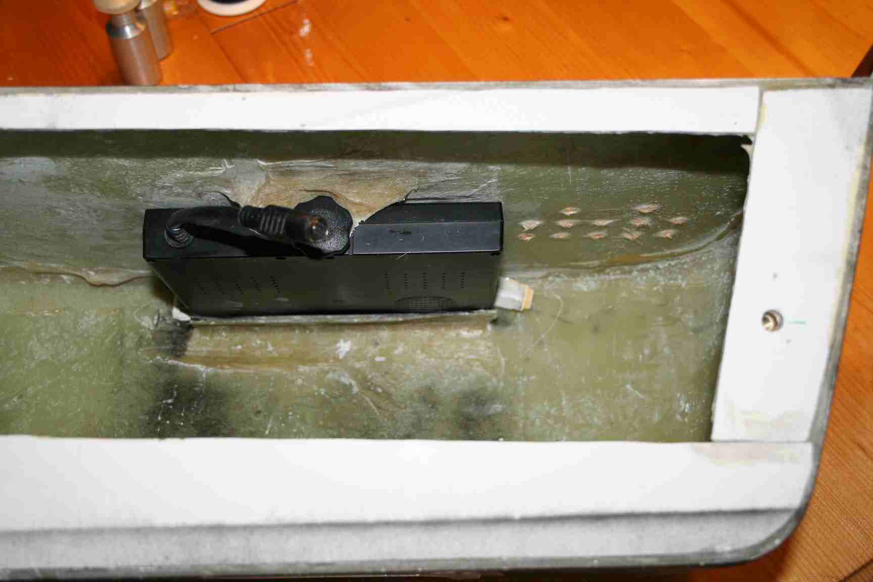

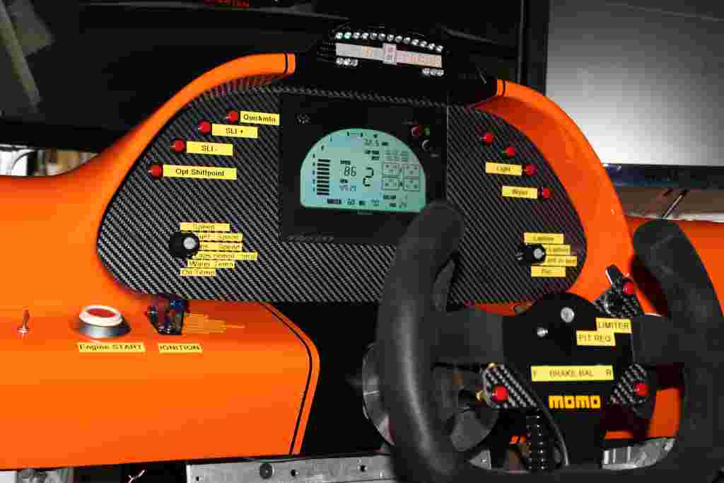

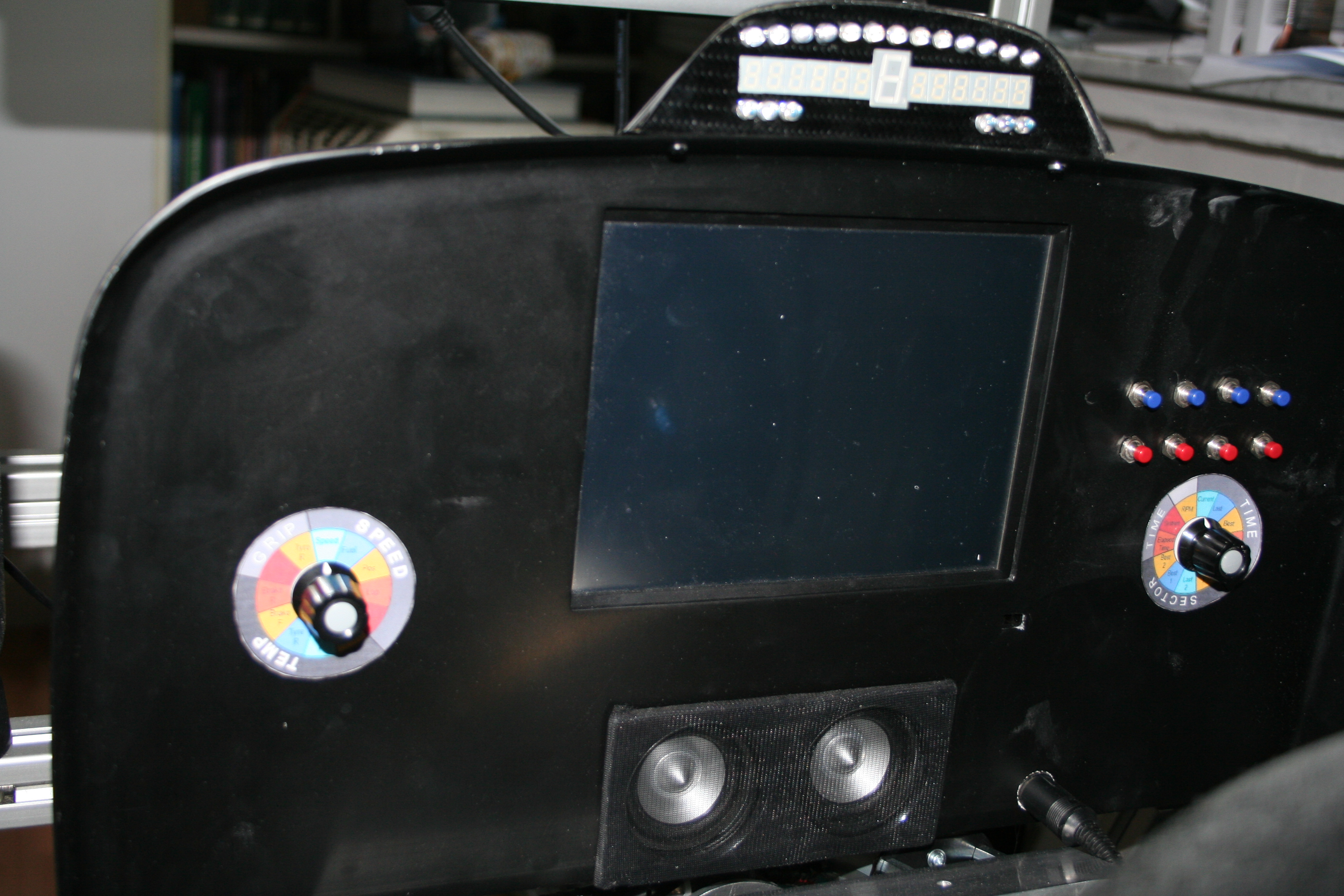

    Here some Pics of my first Cockpit.
    These is really easy to make, costs arround 50€ and takes 3-4 hours .
    Mold is an laundry Box (negativ).
    only put some molding wax in, as Formula 5, coating with gelcoat and 2-3 layer of poyester Fiber.
    The Frontpanel is made on a glasspanel to get an perfect flat surface.
    cut it out, glue it together, abrade the edges an give it a paint with the spray can.

    nice!
    how did you painted the orange one? profesional air compressor? like a car?
  8. RaceRay
    Nov 8, 2006
    4,657
    Hamburg, Germany
    23,875Coins
    +2,035 / 13 / -0
    Wow awesome job. I am also interested in your paintjob. Looks very professional. Did you paint it at a paintshop?
  9. pitstopp
    pitstopp Active Member
    Feb 12, 2009
    116
    Dortmund
    634Coins
    +55 / 0 / -0
    3DOF, SCN5, SimforceGT
    Hi
    I used a proffesional Spray Gun and a Compressor for the orange car paint.
    For the Black Stripes i used a Spraycan.
  10. mario318i
