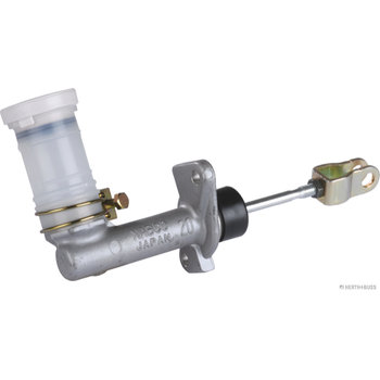

    First i bought a cheap cluch cylinder at ebay from a Mitsubishi Carsima DA II. It looks great, since the resevoir is included.

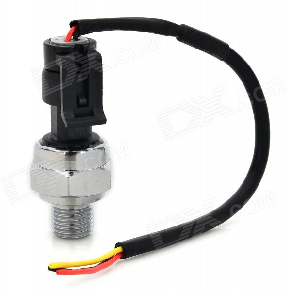

    It whas hard for me to find a pressure sensor for moderate price in Germany. The only one i found was at Dealextreme. But it has lower pressure ratings.
    http://www.dx.com/fr/p/carbon-steel...sensor-silver-black-dc-5v-343234#.VLKKpXtGQiA
    The sensor will output a 0-5V signal, perfect for the Usb Interface.

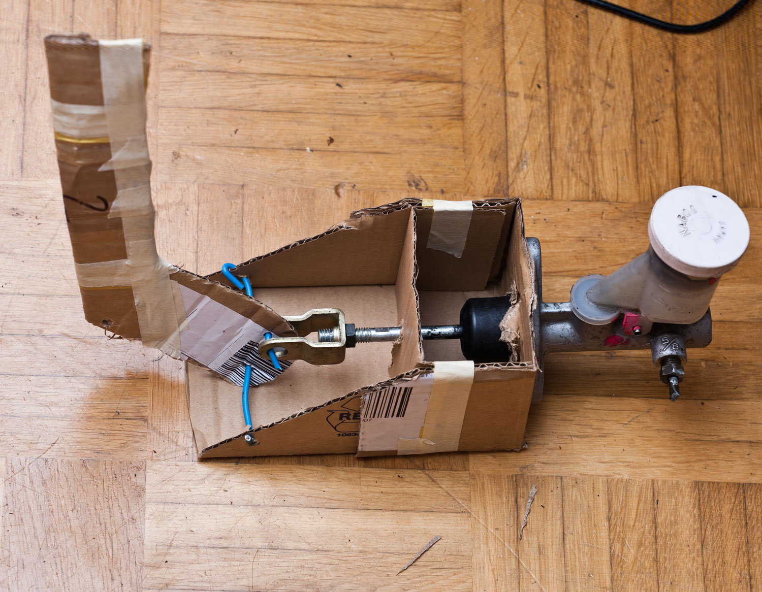

    today the Clutch Cylinder from carisma arrived. After cleaning i try out some holders with cardboard at the moment.

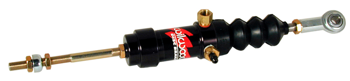

    I did a lot of research on the pulling slave cylinder. Most people use this one.
    More Information here http://www.wilwood.com/mastercylinders/MasterCylinderList.aspx?group=Slave Cylinder
    This one looks perfect for adding some skateboard DOH DOH's to create some force to push against.
    But these are no common cylinders used in car industrie. More established in tuning and racing scene.
    For me in Germany i didn't find any pulling cylinders. The wilwood is avalibe but is over 100€.

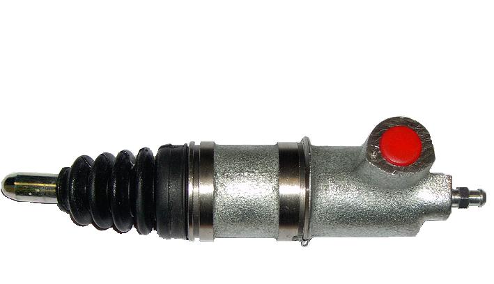

    So i talked to some people at work using a pushing type slave cylinder. There are many avalible for cheap prices. But make shure you use one from an older car like this in the picture. They are out of metal and will be more robust. The newer ones are all plastic. The should handle the force without problems. Even a master break cylinder would be better.
    Maybe someone has a good pushing structure idea?

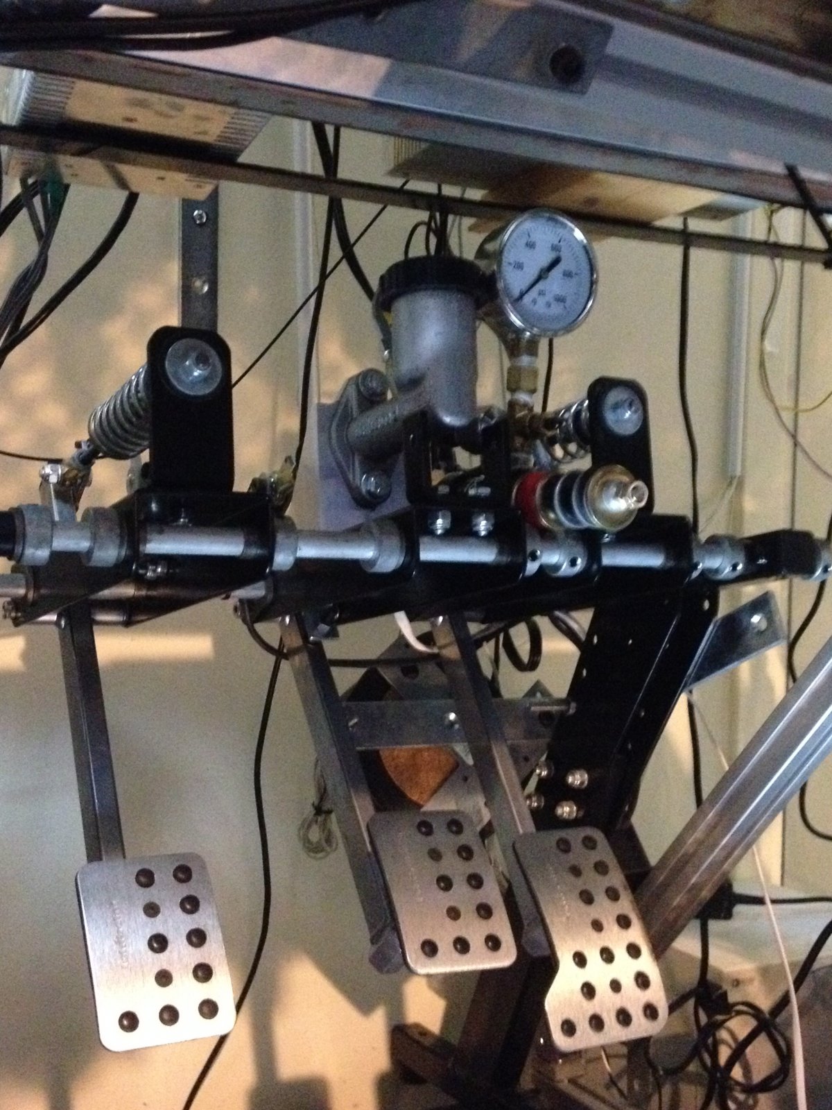

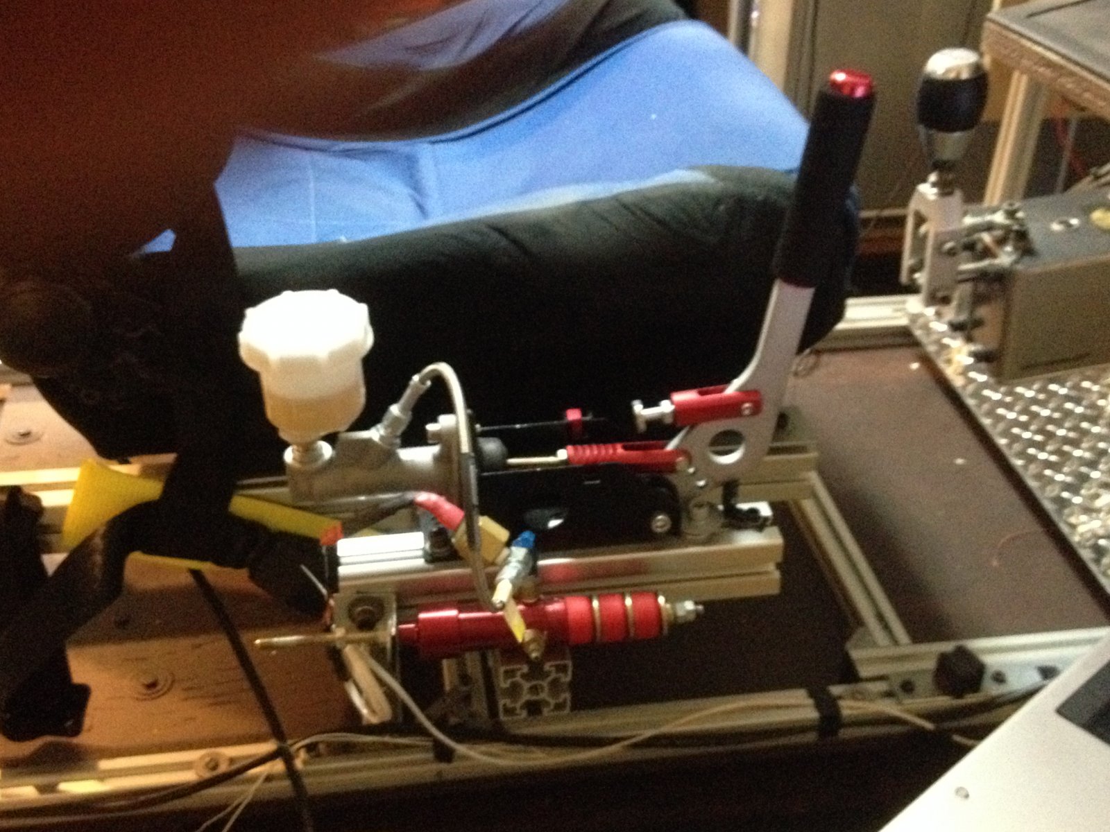

    Hello Tombo,
    here is the pic of my hydraulic handbrake .
    an idea of improvement (but expensive) is to use a Measpec sensor (4 wire) and use DSD amplifier to amplify the signal.
    this wouls allow more control . I would have to dig that info somehwre in my stuff. I beleive nobody did it for hand brake . I was intending to do it on my foot pedal.
    here is the pic . for educational pupose i added a pic of my modded cst pedal (this uses the exact same principle but purchase a bracket , instructions were given to me also)

    Thanks for your pictures. The paddle thing looks very interesting.
    I've seen you have a pressure meter on your brakes.
    Did you measuered the pressure in the brakelines of the handbrake too? This would be very interesting for me.
    I see you also use the clutch slave cylinder. Would love to use it too but it's so expensive.

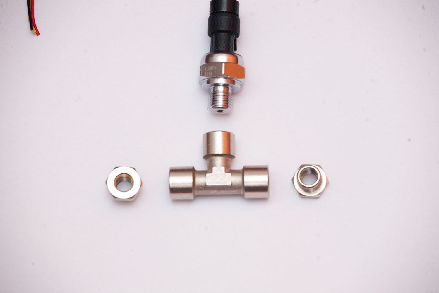

    I taked a look at the cylinder you mentioned, but with shipping tax etc is much more cost than the whole handbrake will be :D
    so i decide to continue with my cheap pushing cylinder and will try it out.
    I did not made any process now, but charged up my flash for camera and wasable to take some pictures of the connectors and sensor. The connectors are with M10x1 to fit a normal brake line. So it will be very easy to combine the 2 cylinders.

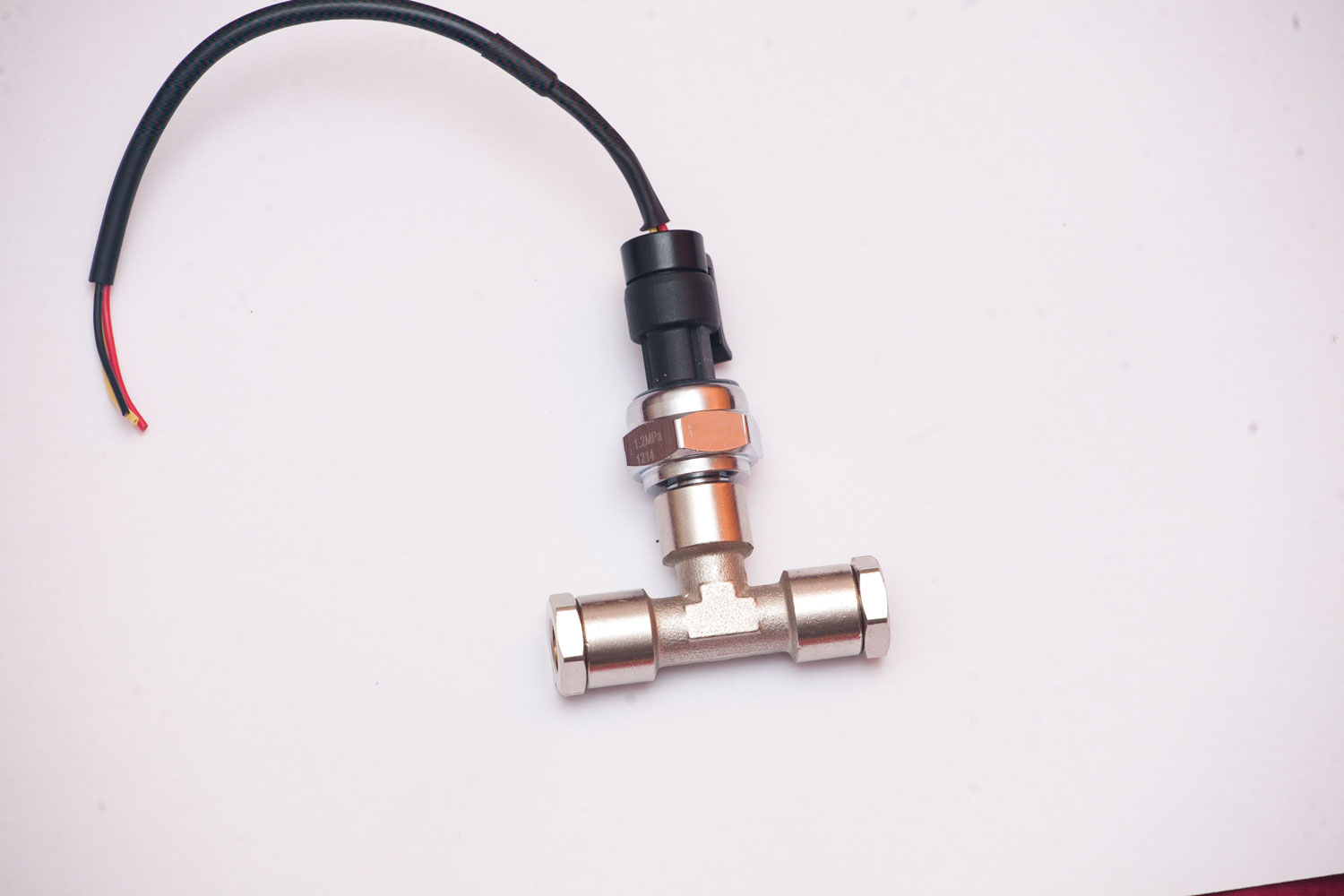

    I get all the connectors at my local pneumatik shop for free.
