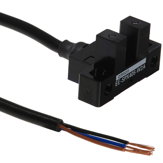

    Great work! Switches are your best choice for the price and simplicity. You won't really gain anything by using optogates,
    if you go that way, use something like this: http://www.electronicsinschools.org/ima ... pto008.jpg

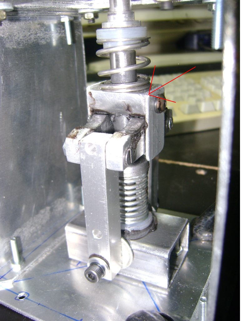

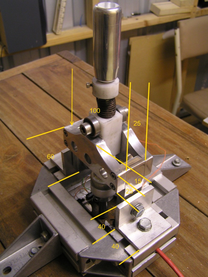

    Willy, Your design is great. I made my own shifter based on your design but with some changes.
    All the electrics are done with just microswitches with an actuator arm. They are the same as the ones found in a mouse etc but with an arm over the button to give actuation over a larger range of movement. I really think you are overcomplicating things there with the opto switches. Stick with normal micro-switches with levers on them. That is what i did and it works fine....
    I have now also made my shifter mech shorter. The vertical parts are only about 60mm long now and the shaft is much shorter with a smaller spring. I have replaced the black bit on the bottom (annodised aluminium) with teflon now as it was grindng a bit on the rod end. My design means you only need one spring too and takes into account Frakk's suggestion of using bearings on the moving surface.

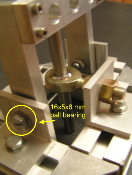

    Elnino,
    Great Shifter. I have a suggestion for the two lower pivots on the shifter. You could drill out the holes on the side brackets to 16mm and fit 16x5x8mm ball race bearings. this would remove the freeplay from the bolts. The bearings can be pickup from ebay or your local bearing dealer, this size is mainly used for R/C Model Cars, or you could use 22x7x8mm bearings which are used on skate boards or roller skate wheels.
    If your holes end up being bigger than the bearings, you can use a little bit of 5min Aradite or something similar to hold the outside of the bearing in place.

    Thanks for the comments people.
    @ Senetor - I did consider various methods for putting bearings in those locations but the play is very small and not enough to really warrant it at the moment. You definately don't notice it when using it, not only that, even a real box is still somewhat loose. Perhaps after lots of use they might wear in a it and loosen up though. The bolts are 8mm but the vertical part is tapped so the nut on the other side is only holding the bolt still, not clamping the whole lot together. The hole in the angle clears the bolt. Another idea was to simply use brass bushes.
    This is the latest version all cut down and briefly polished with some dimensions (in mm)...
    The main shaft is 1/2 and so is the rod end. From the dimensions in the pic, you should be able to nut it out. There is no need for the special flexlink stuff (what the base is made from), you could do it on a piece of wood or whatever you fancy working with. The important bit is underneath where you need a gap to create enough throw to make a useable H pattern. Either that or you could put it above like Willy's design.
    @ Frakk - Nil, i had all the bits laying around at home. If i didn't have all the bits, hmm, about $75 or so. The biggest cost there would be the rod end but you could substitute to keep it cheap. The chunky aluninium bits are made from 100 X 10mm Flat bar cut on a wood mitre saw with some lube. Kero, Lanolin, CRC etc works fine. Drill and tap the bits and then the ramps were done tediously on my linisher with an 80 grit belt while they were bolted together.
    The flat bar is only about $10/m and the angle is cheaper again at about $6-7/m

    Senetor, I see your point about the bearing in that position, but the stress in this join is in the oposit direction, so the bearing is not necesary. I made this join with aluminiun bushes.

    Willy, I've a couple of industry standard pnp and npn 5V light switches like this one:
    Drop my a mail or pm and I'll send you some.

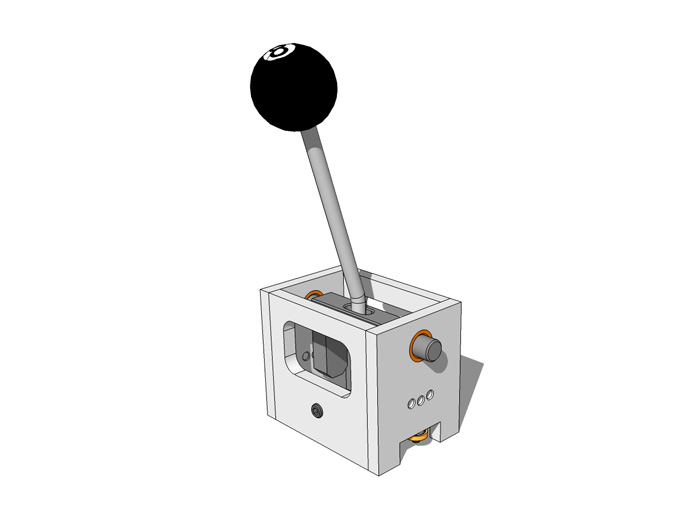

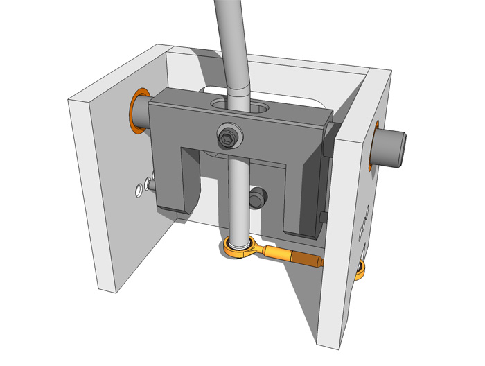

    A few month ago I've spend some hours in designing my own DIY H-Shifter in CAD. Some parts are already here but I really don't have the time to work on multiple projects. When my wheel and the controller are done, I'll lay my eyes on that shifter.
    Some pics:

    thank you jakob, I have some of those light switches, but they need more precise aligment of movements.
