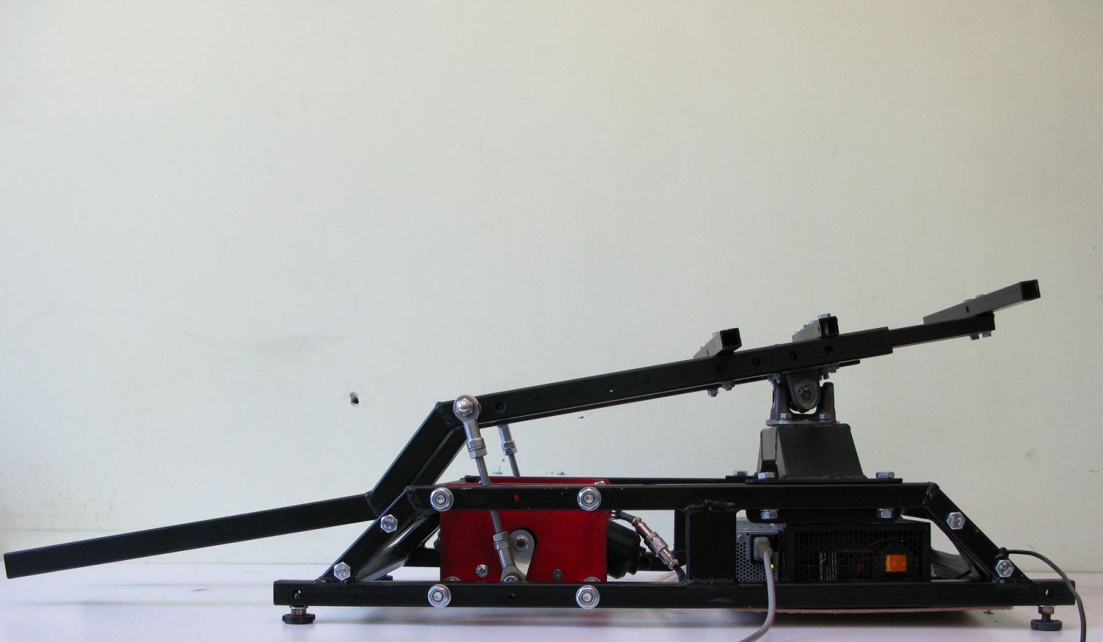

    Hi all. My first sim.
    I'm using 2 wipers 30W, Arduino Uno, MonsterMotoShield, PSU HP 525W, 2 pot 10kOm.
    Software -SMC3 0.7, SimTools 1.3, Dirt2
    Unfortunately have a defective chair, began to creak spring.

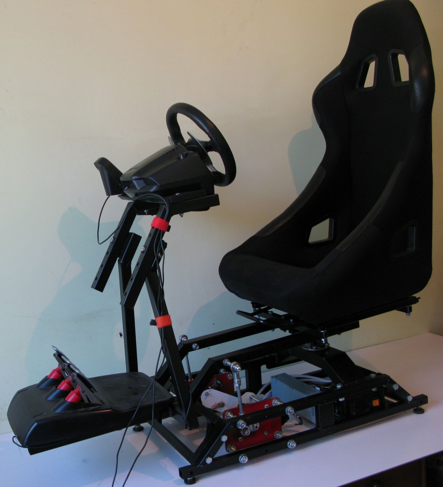

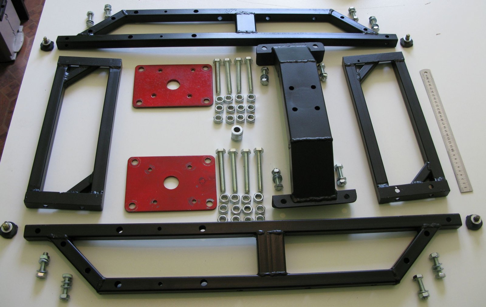

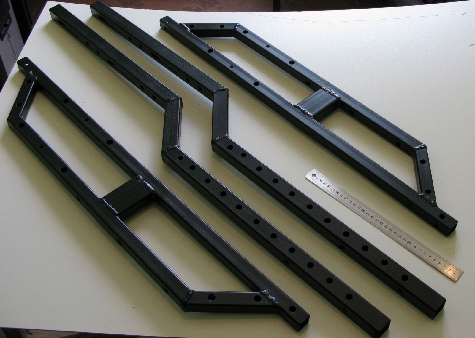

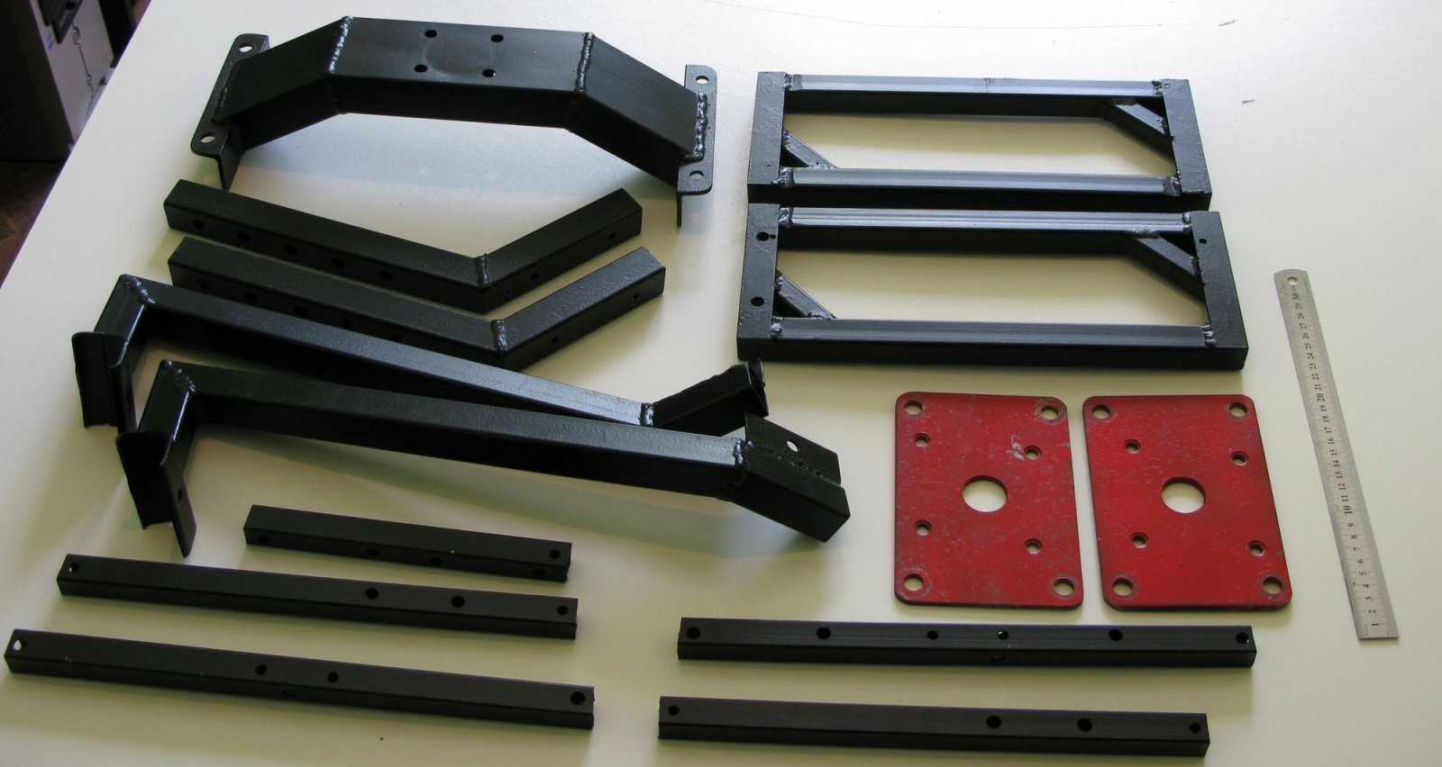

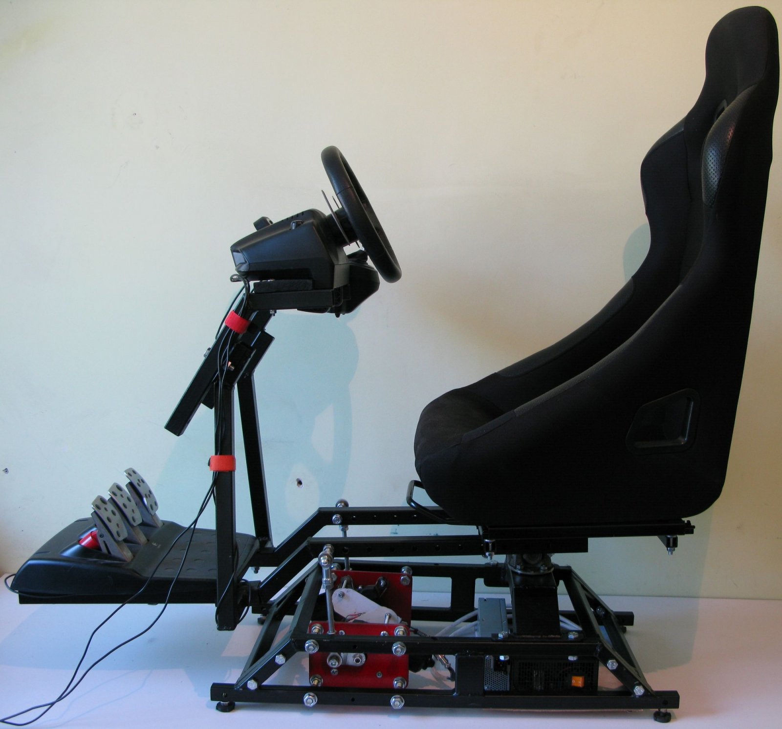

    Repainted chair and slightly changed the location of the hinge. The chair is a lot better.
    In attachment some pics with parts.

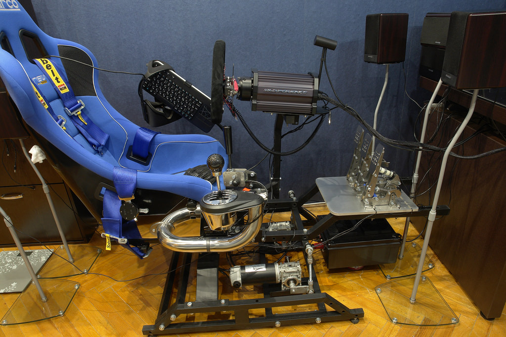

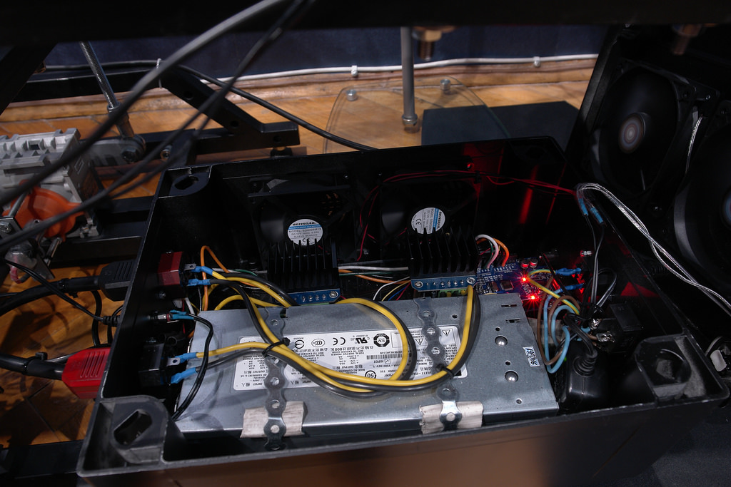

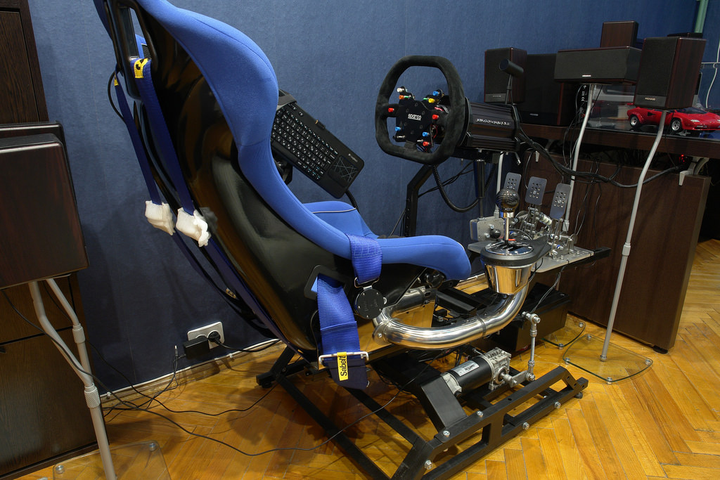

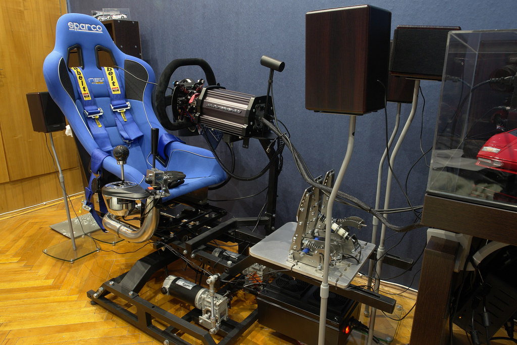

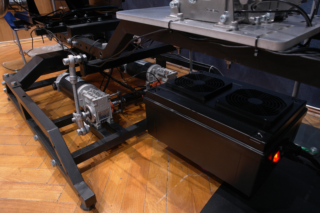

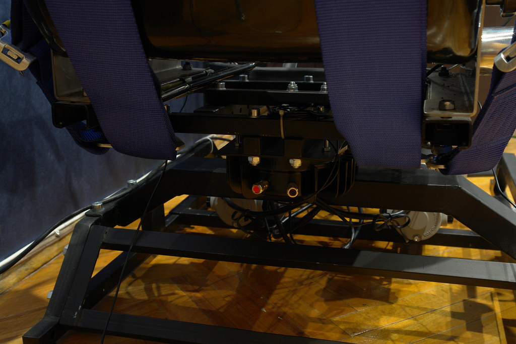

    Forgot to mention it there (yesterday assembling was quite tenseful, even wife wife and a kid didn't see me much), and since the original design belongs to @Radioproffi, I think it would be nice to show how it works with high powered industrial Dc motors.
    My very first attempt in motion and some photo (will redo it asap with long exposure), need tweaking for sure.
    Anyaway, without @Radioproffi help I still be on static rig, now all my inputs should be reconsidered and reviewed, since high speed motion flood my brain with additional info.
    The construction itself feels very solid and sturdy, needs some adjustments though, but overall it has almost an industrial quality
    Below are photos of a completed configuration specifically for my needs
    [​IMG] [​IMG] [​IMG] [​IMG] [​IMG][​IMG]
