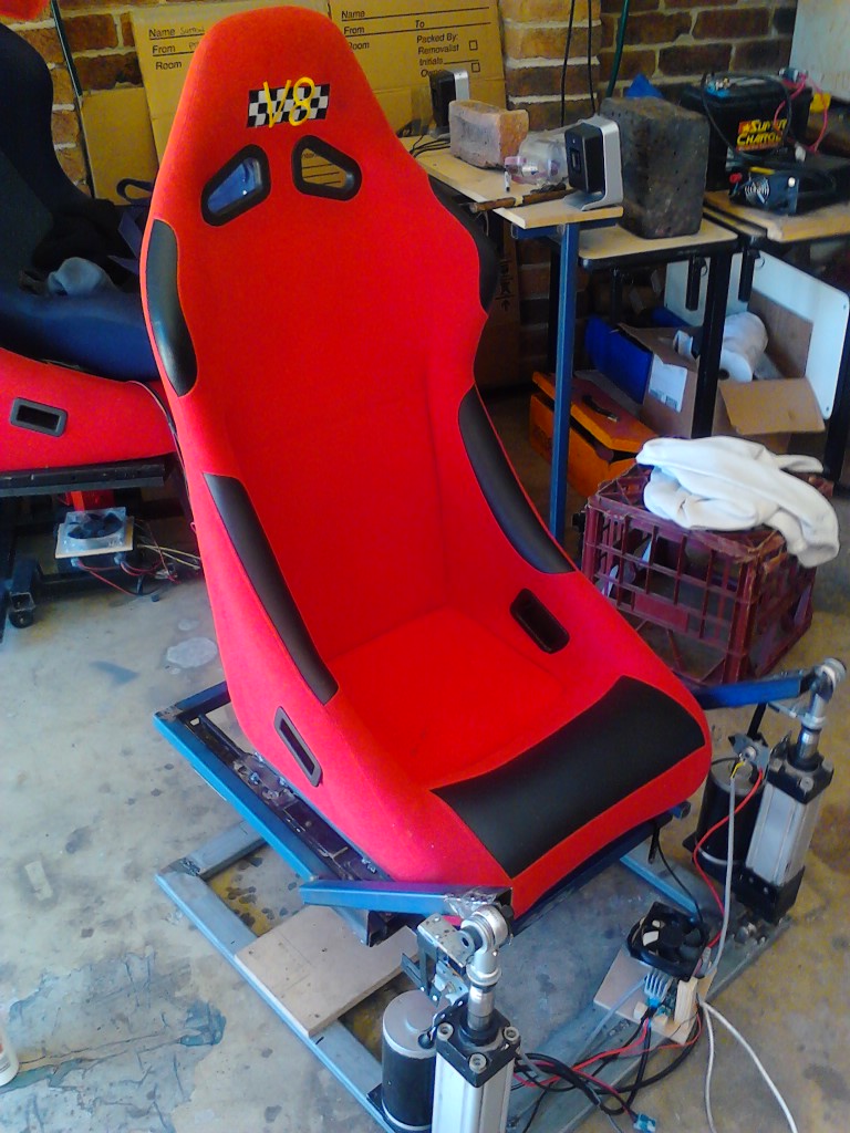

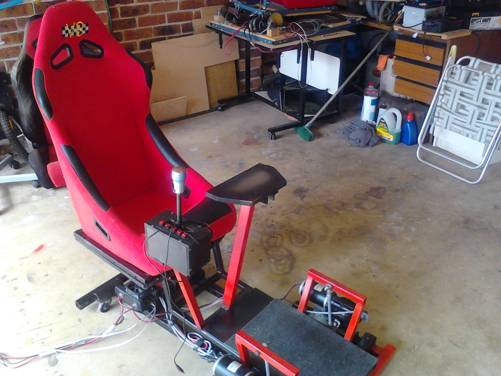

    PVC full frame using actuators, but DC motors will do the job just fine

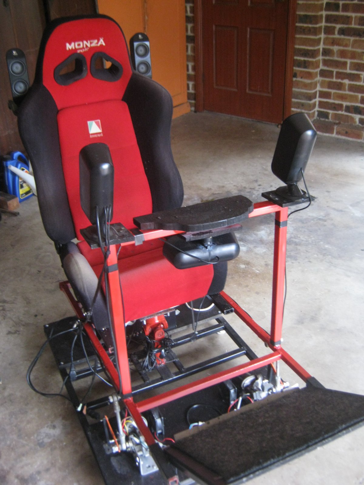

    2 DOF seat mover - full frame, adjustable balance point, again using actuators, but DC motors will do the job fine
    seat mover mode
    Full frame mode

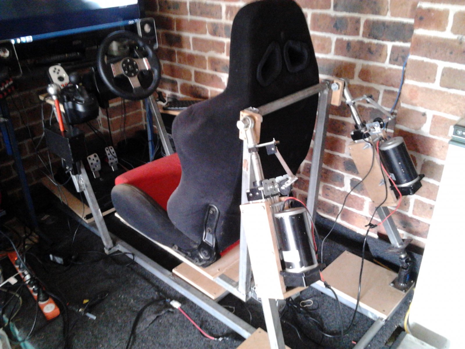

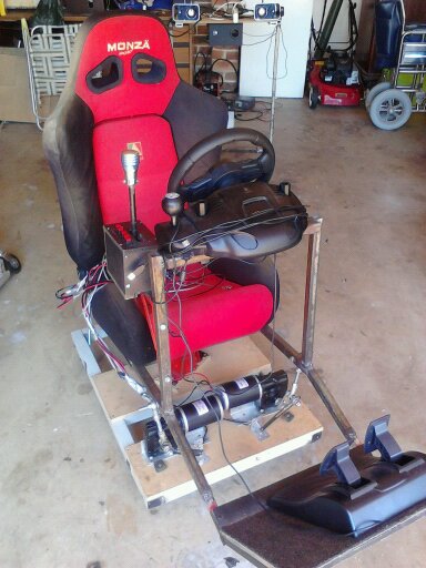

    DC shoulder mount seat mover
    http://www.xsimulator.net/community/threads/diy-2dof-seat-mover-with-big-motors.4683/

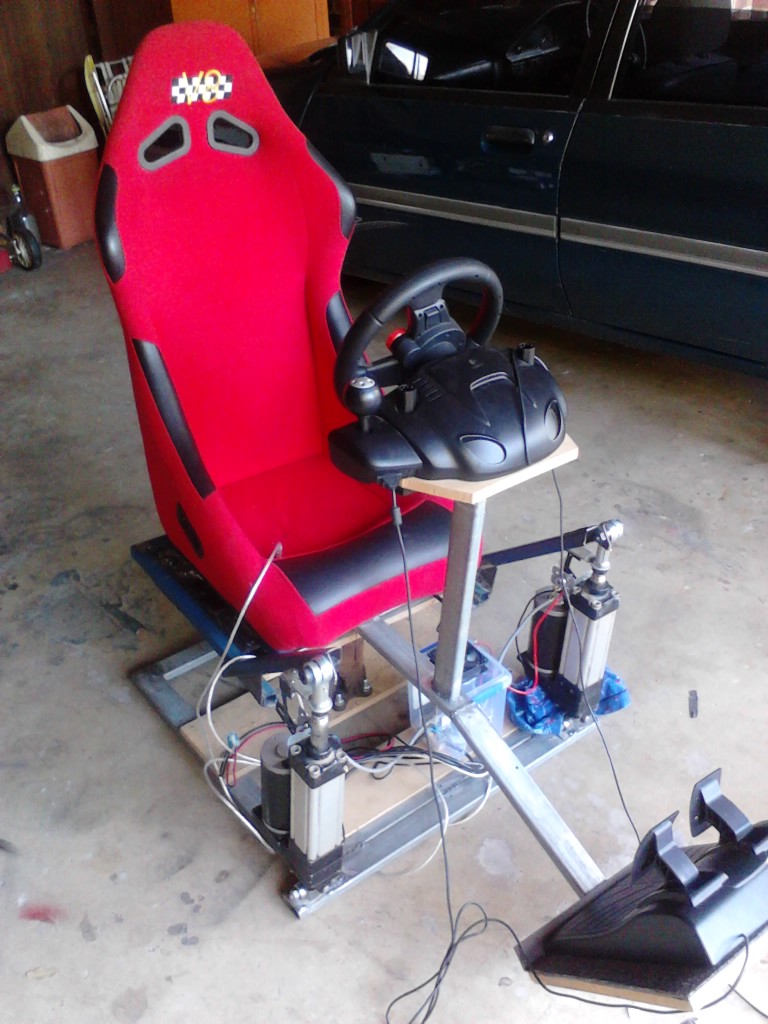

    Actuator 2DOF , with home made actuator holders
    http://www.xsimulator.net/community/threads/actuator-2-dof-seat-mover.5065/

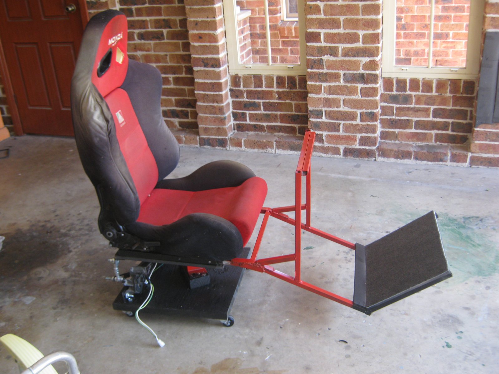

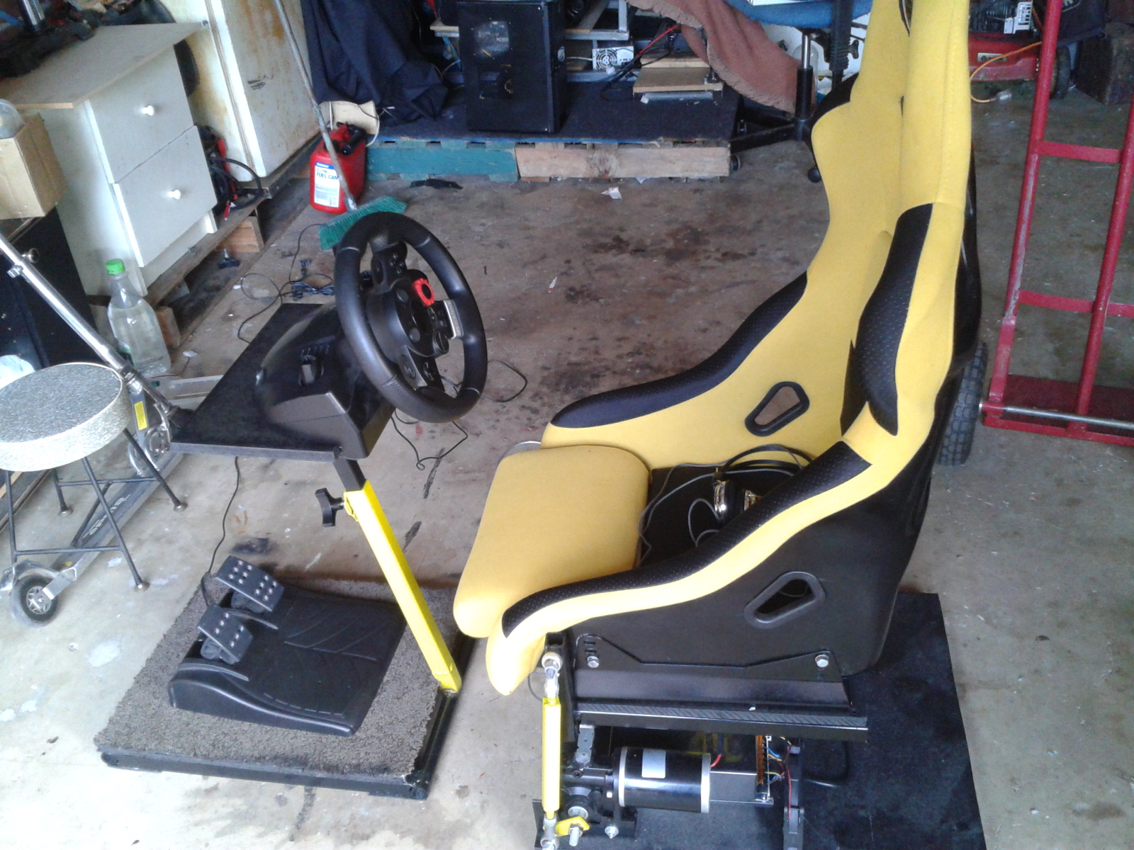

    The desk racer (with wheel stand)
    http://www.xsimulator.net/community/threads/desk-racer-2dof.5326/
    DC motor at about knee level but mounted low
    http://www.xsimulator.net/community/threads/2dof-redesigned-big-worm-gear-motor-sim.3640/

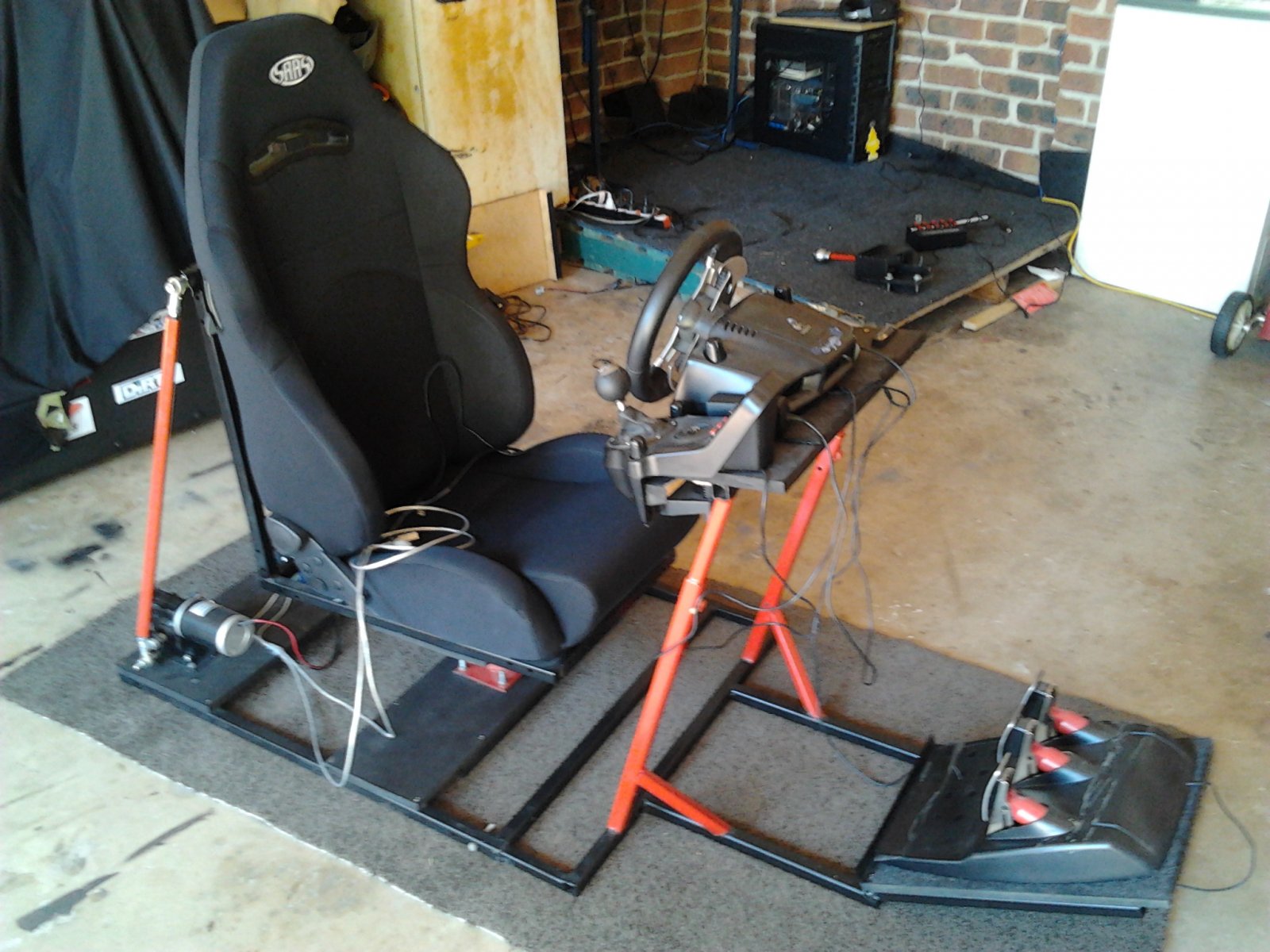

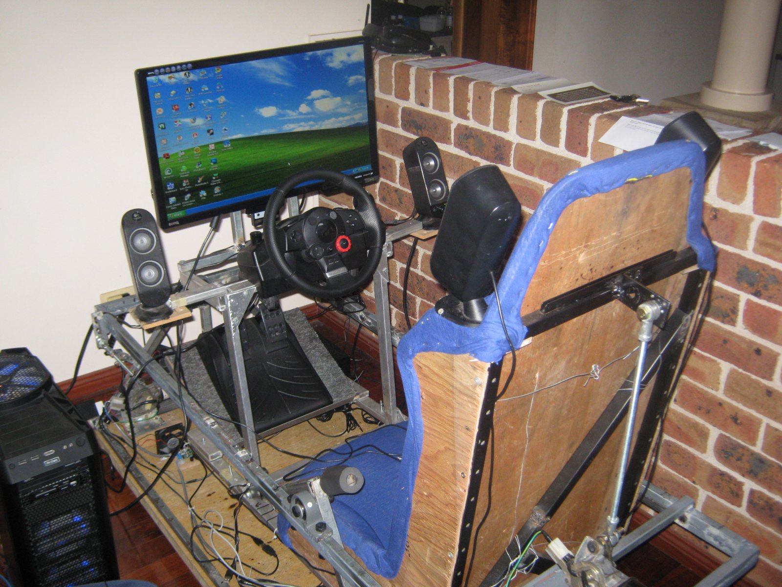

    Wiper motor sims
    Full frame sim with everything (wheel and pedals not on it)
    http://www.xsimulator.net/community/threads/2dof-wiper-motor-sim-continuing.3048/page-2#post-32694
    Compact rear wiper motor sim
    http://www.xsimulator.net/community/threads/2dof-seat-mover-with-frex-attachment-bsft.3435/

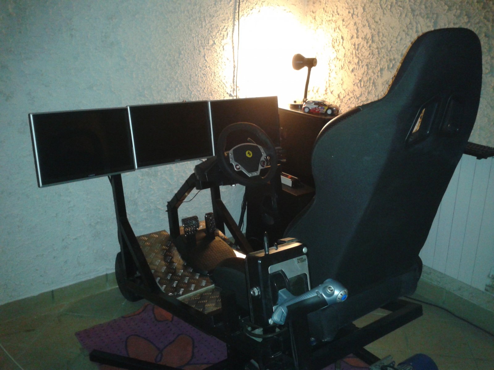

  8. Erwan960
    Erwan960 Active Member Gold Contributor
    Nov 4, 2013
    137
    3,832Coins
    +255 / 0 / -0
    This is mine with new engines bsft advised me to take :)
