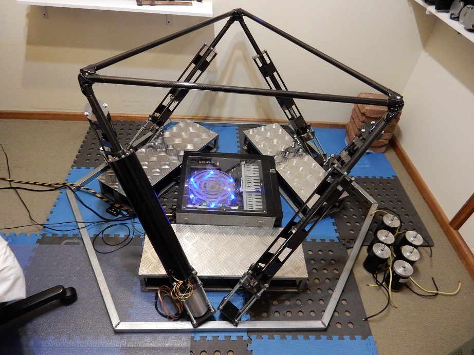

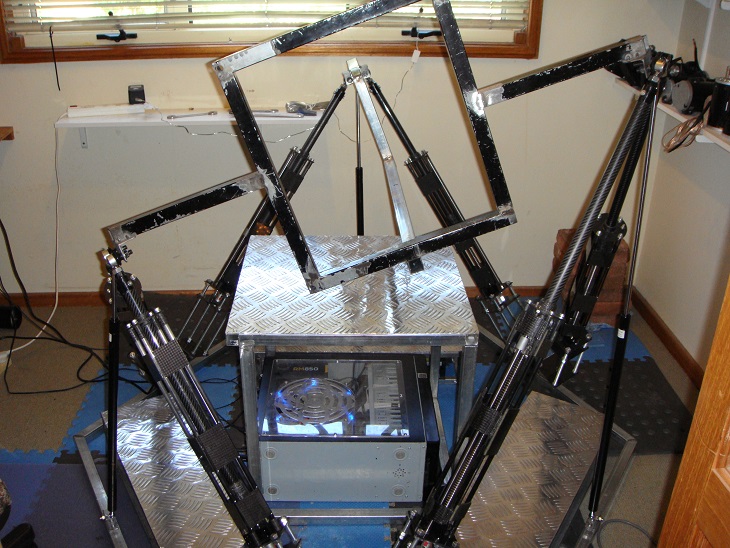

    Decided that pictures and videos speak a thousand words, so I will talk about my two sims and how they compared in regard to using VR.
    My previous Sim, it ended up having 5 axis.
    This was originally designed as a standard shoulder mounted two DOF mounted onto a surge and traction loss table, so it was driven by 4 x 200w 12v DC motors using JRK motor driver cards. Another axis/motor (heave) was later added via a modification to the seat itself. This was actually a nice sim with good low latency in the upper 2DOF frame, but which got progressively worse in the lower surge and traction loss tables due to increasing inertia due to weight and the pendulum effect (high CG). You can only do so much with JRKs and 200w motors:). This was still not so much an issue with a single open screen, but then I purchased a Oculus Rift DK2.
    This was a step up in simulation, but as the frame was never designed for the Rift the camera mounted to the frame use to bounce around due to flex on any fast changes in direction and lose track. This was not good, so the camera was moved off rig and is how the video above was taken. Unfortunately the large surge table movements created an unwanted change of view in the Oculus which was often a bit off-putting - but you got use to it. So if you have a Two DOF with limited movement mount your camera off the rig.
    I knew the rig has some shortcomings and as CV1 was in the pipeline, started work on a new rig with VR at the forefront of its design. There was also allot of talk at the time on the site of Camera tracking issues with the Rift and motion, which from my own experiments I isolated down to low and high speed camera oscillations. The Oculus headset never seem to be the issue due the natural absorption effect of a human body/neck/head. So what I needed was a frame that stopped low speed oscillation, while also absorbing high speed oscillations. From my and mainly my Sons experience with my last Rig, I also knew that I needed the rig to have a fast and large enough range of movement to trick the inner ear to reduce/eliminate motion sickness. So after a few changes in direction a 6DOF stewart platform was born:
    To reduce latency, I built Carbon Fibre framed ballscrew actuators they have low weight/inertia, available long travel, while still being capable of a good speed and torque due to their high efficiency. Ie 90% compared to around 50% for most worm drive gearboxes. The Stewart platform is also by design (all triangles) very stable and rigid. To power all this I used 12V 48amp DC motors with dual Monster Moto Drivers and 40 amp power supplies for each axis.
    The actual sim frame was also designed to lower the moving part of the rigs CG, therefore lowering inertia, the pendulum effect and therefore again latency (I'm current building a carbon version of this).
    This gave me a stable, low inertia rigid platform which is ideal to mount a camera to and has low latency in all DOFs.
    The camera is wrapped in foam sheet - I had to try a few different densities to find one that worked with my rig (to reduce the high frequencies oscillations) and fixed to a steel frame which has been welded and braced to the main frame (to reduce low frequency oscillations). I think a mistake allot of people have made is expecting the foam to reduce the low frequency oscillations, this will never happen. The foam also needs to be harder then what you may think, as you don't want the camera to be able to move and generate its own oscillations.
    Myself and my Son can attest to how well this works and how it has reduced any feelings of motion sickness from my previous rig to nil. Here it is in action.
    Hope this helps someone in designing a rig suitable for VR - I will add more information if it comes to mind.
