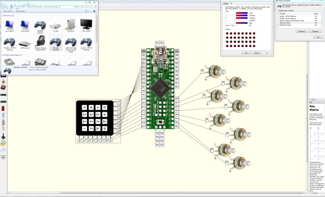

    For programming I use a drag and drop interface called GenericHID. Just drag the components that you want associated with the Teensy over onto the screen and drag wires from the teensy to the components. You can give it a unique name for windows, tell it what you want the axis to be called, etc. It is an Arduino/Teensy programmer for dummies (me).

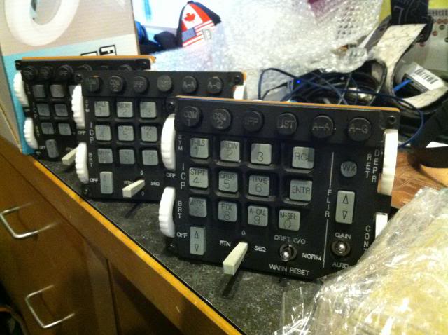

    The teensy is what I used to create my custom shifter rig. So far I have used it to create 7 custom button boxes for various people, two complete cockpit interface panels again for a couple of people, three HOTAS sets (upgraded a Thrustmaster FCS and a Suncom Talon F15E). One of the HOTAS sets was completely from scratch, I make a Supermarine Spitfire (like) stick and throttle set. Oh, and 14 custom ICP modules for F-16 simpits.
    Teensy on my shifter:

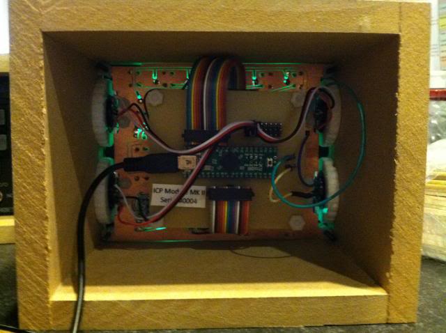

    ICP modules:
    The Teensy on the back of one of the ICP module. Like a spider on it's web, lol.

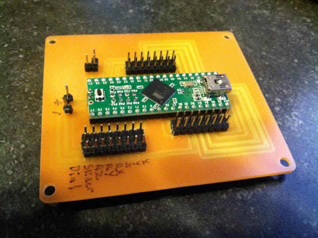

    The custom PCB I made for my Teensy (this one is in the Suncom HOTAS).

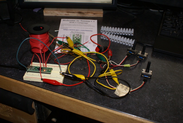

    Teensy on the breadboard:
    The GenericHID interface:

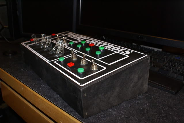

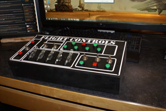

    Here is a control box that I made using a Bodnar board:
