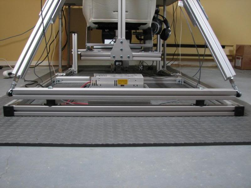

    Hey!,
    I finally managed to 'finish' my simulator build ... At least it's fonctionnal and I am very impress about the feeling, it rocks SOLID!! The front part where sits my pedals and wheel is very temporary, I assembled it with spare parts and I am still thinking about the final design. I wanted to integrate the playseat parts for it's flexibility. Will also replace the table for another one or fix the monitors to the base frame and rearrange all the wiring to make it clean ...
    Special thanks to Bernard for sharing all his knowledge and all others x-sim active forum members for making this project achievable. :hi:
    Here are some pics, feel free to comment :)
    EDIT *** Initial built / August 18th, 2010 *** (See latest posts for progression)

    Re: Finally my 2DOF SCN5 racing simulator
    congrats!
    But Imho you should remove the frame between the seat and the pivot. It adds stress to the actuators significantly, due to leverage. As well you will apply more force to the actuators while pressing the brake. Your bottom should be as close to the pivot as possible.
    I dont say that it wont work, but the actuators may wear out faster, and you may hear quite often the overstress beeping sound.
    regards

    Hi, thx for your comment.
    You mean the Playseat bottom frame ? I did not hear any beeping noise even with very brutal profiles but I could try your recommendation. I will make some additionnal tests with the current setup and see... In my understanding, it was more a question of correct actuators angles to compensate for the higher seat position ...
    Bleco

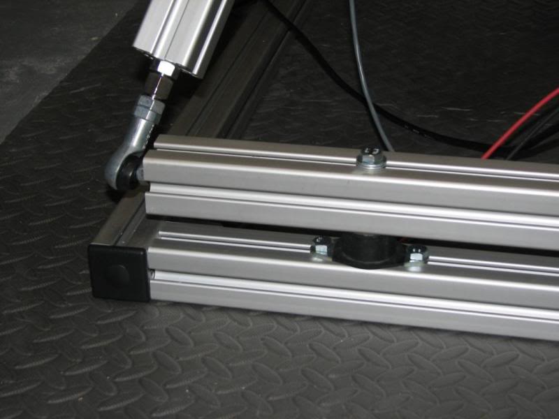

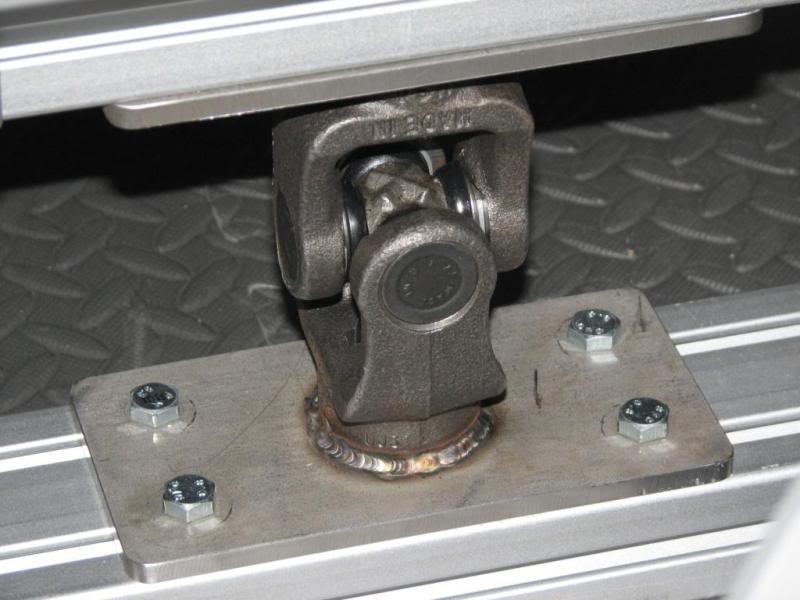

    I have the same size pivot. I was told that it is too small to weld. Let me know how long it lasts.
    I want to do away with the bar that keeps the chair inline because there is a slight flex I get and weld the pivot.

    I think egoexpress is correct.
    It is good that you are not hearing actuator stress, but...
    If you remove the Playseat stand from under the seat, then your actuators will have more linear movements at all points in the motion range because they will be under less stress at the extreme movement points due to your lower center of gravity.
    Keep at it, this is one of the cleaner looking DIY sims I've seen in a while. :thbup:

    @ Fahim: I don't know about your U-Joint pivot solution but mine is very solid and shoud never break ... There is plenty of room to weld, mine is a Boston Gear U-Joint #17336. You can check the specs here:
    http://www.bostongear.com/pdf/product_sections/bearing_pp_127_133.pdf

    BTW: your butt should be right under the pivot that angels the seat, looks like from the picture it seems your seat is too far forward from the point of the movement of the seat, looks like its at the point of the backrest of the seat. (sorry technical stuff is still difficult for me to explain in english...) Great design though with the rubber joints on the end of the actuators ;)
    Oh.. and are that 100 or 150mm actuators?

    I think the position of the seat/pivot is ok but I will double check and make some tests, thx.
    These are 150mm actuators 8)

    @bleco: Cool work, it's great :thbup: ! As the guys mentioned before, I also would unmount the Playseat stand and mount the seat directly onto the seatbase...

    Great job bleco. I will also echo Bernards comment about the height of the seat. In my first project, I used parts of my Playseat but I mounted the seat much lower and also eventually got rid of the Playseat front end because it interfered with my access to the pedals at times.
    I would also recommend changing the seat as a future upgrade to a fiberglass racing seat. You will be amazed at the improvement in motion quality you will get by going to a more ridgid seat :)

    @ Ledfoot and Schnullerbacke: Thx for your comments!
    I think I have some adjustments to do over the next few days... I will post some new pics when I am done... It was an option at the biggining of this project to sell the Playseat and use a real racing seat instead ... But I thought it would be a good addition for it's flexibility so I decided to keep it... However I am also having issues accessing the pedals and I think that mounting the peripherals directly on the frame would be much more solid... so maybe some big changes to come, will see... :)

    ... so I removed the Playseat bottom frame as suggested and adjusted the actuator arms and wheel/pedal support ... I like it ...
    next step, mounting the monitors on the frame.
