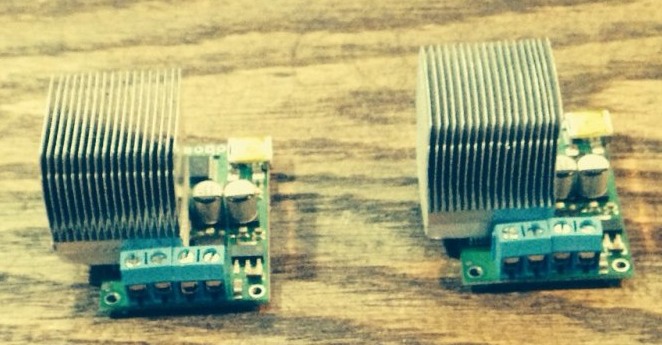

  7. Roonster
    Roonster Member
    Aug 22, 2009
    25
    GTA Ontario
    609Coins
    +11 / 0 / -0
    Thanks, I used your technique and it worked out well. The heat sinks were cut from a larger CPU heatsink with a hacksaw.
  8. Aribaz
    Aribaz New Member
    May 18, 2015
    - 8Coins
    2DOF, JRK
    Hello, and they worked as heatsinks? Get very hot to the touch? Sorry for the bad english...
    21,487
    150,542Coins
    +11,017 / 55 / -2
    JRKs do get hot and need both a heat sink on the main chip, plus a cooling fan. Most buy a standard heatsink but nothing wrong with creative modding as @Roonster has done.

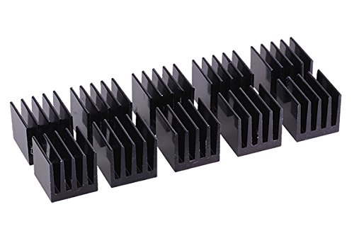

    Hi to all! I'm thinking about how to cooling JRK. For space reasons I want to make traditional way (heatsink+fan). I've received today the heatsink and I was really happy about my order...but now seems very little and not very tall... It's only my stupid worry or I should order another thing? Height is 0,5 cm.
    Because if I see photo of other's heatsink seems very big, but maybe it's only something regarding proportions..
    I've bought this because it has glue and thermal paste incorporated. This is the product:
    Code:
    https://www.amazon.it/Aukru-Raffreddamento-Alluminio-Dissipatore-Dissipatori/dp/B00ILK6DMA/ref=sr_1_1?ie=UTF8&qid=1503508987&sr=8-1&keywords=raspberry+heatsink
    Thank you so much.
  15. Nick Moxley
    17,056Coins
    +2,506 / 30 / -2
    The BIG 1" tall sinks aren't really needed. You should be fine with those.

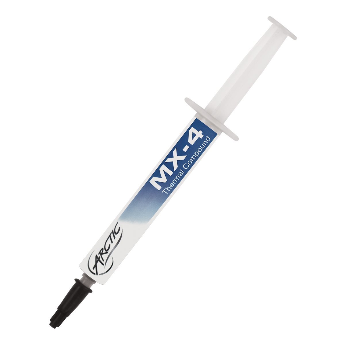

    I've found in my house another solution, so I can choose between that little heatsink in the previous post (wich has adesive thermal paste) and...this:
    Those are 15mm x 15mm x 15mm. I can use with this thermal paste:
    Maybe it's a better solution of cooling? I can choose, I have already this item in my house.
    The only question will be how to fix this heatsink to jrk, maybe with this:
  17. noorbeast
    21,487
    150,542Coins
    +11,017 / 55 / -2
    You can get double sided adhesive thermal tape on eBay.
  18. mirkobastianini
    mirkobastianini Active Member
    Jan 23, 2017
    193
    informatic
    italy
    1,300Coins
    +77 / 2 / -0
    It's not better to use thermal paste instead of adesive? :)
