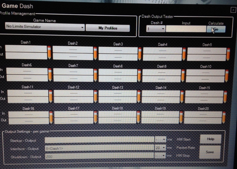

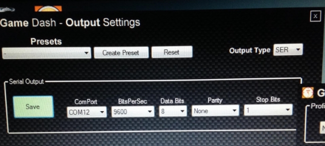

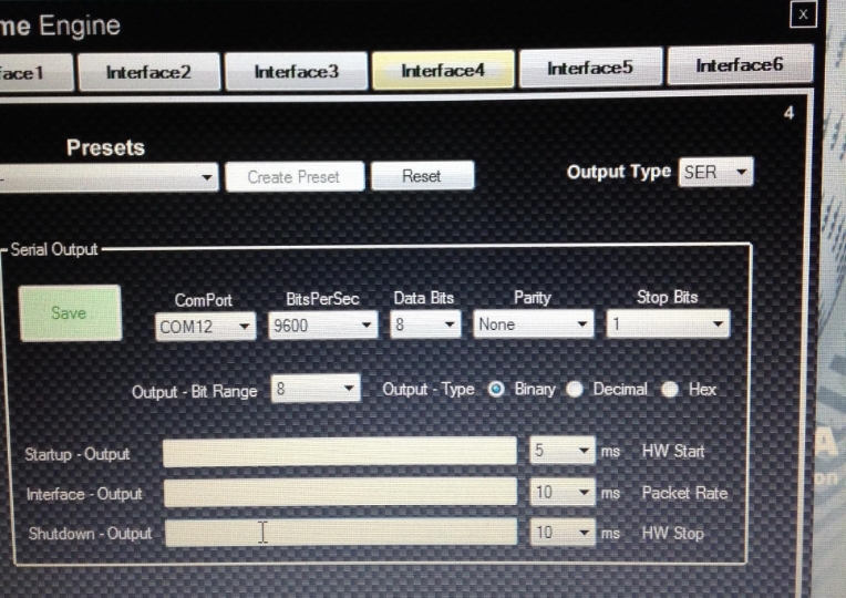

    Ok, this is where I am at.
    First, I will show the code I think should work. Then, the screen shots that I have attempted to work through. Obviously, I need some help.

  8. eaorobbie
    20,400Coins
    +1,683 / 23 / -2
    Ok first remove the Interface 4, only the GameDash needs to talk to the Ard on Com12 (for your setup).
    Ok now I don't have NoLimits installed,
    So I will bump @value1 does the No Limits Plugin contain a speed value that we can use in the GameDash. If not could we trouble you to add this please. Cheers.
    Now if Speed exists , its in most cases set to Dash 1 and we need to create a little script there to change the value to what we need to send to the Ard.
    For example:
    Assetto Corsa supplies a number with decimal places and can be several digits long so I insert this script:
    Round 0
    Pad 3 0
    Ok the first line ROUNDS the number to the nearest whole number , no decimal places (0)
    The second line Pad the number to make it easy for the Ard to read the value as fast as we can, ie keeps the speed to a 3 digit number , ie: 0 = 000 , 10 = 010 and so on.
    Once enter Press save.
    What can be handy is to use a 2nd monitor to see whats going on with the GameDash and you can change the scripts while it runs to find the right values, again sorry I don't have the game presently installed or I would test it for you.

    @eaorobbie - can you take a look at the Output Settings in the Game Dash? Does that look ok? Does that depend on what the Arduino code is looking for?
    Also, on screenshots of other poster, I see actual descriptions instead of Dash 1, etc .... How is that done? Every time a try a run and then go back into Game Dash, the Game Name is back to no selection even though I had selected No Limits before starting the game. Is that typical of the Game Dash or do I have something not saved correctly?
