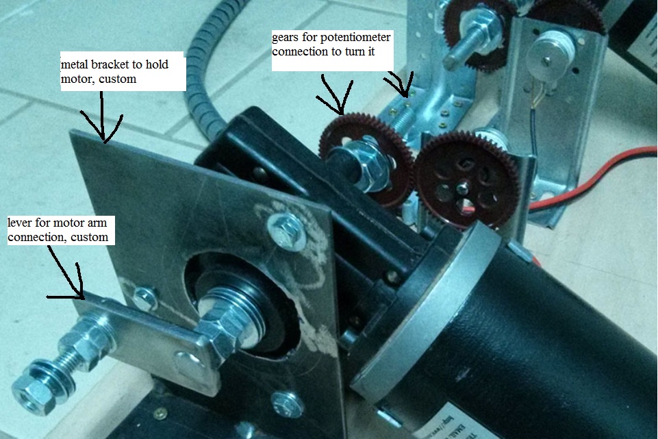

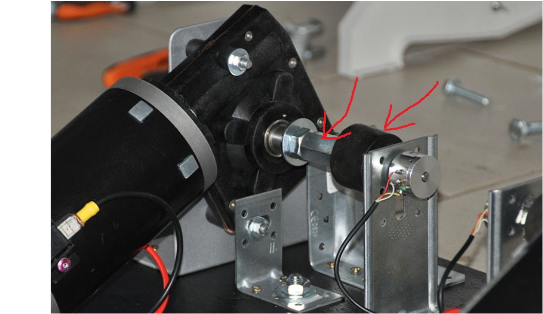

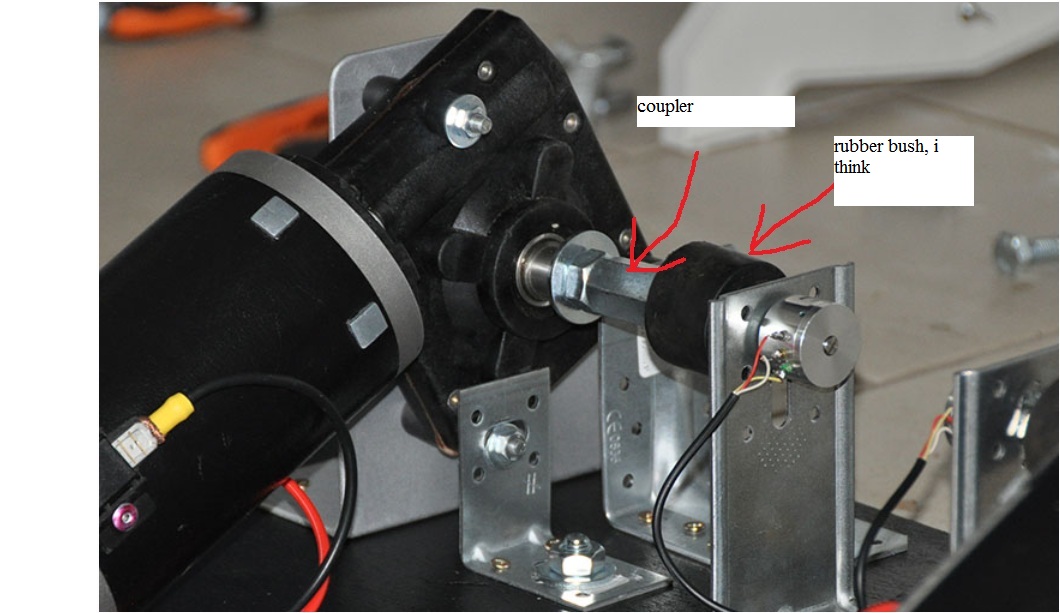

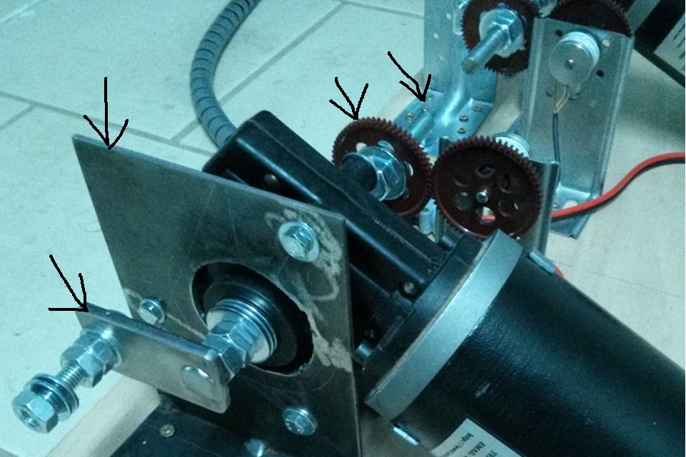

    i have some question what are those parts called i dont have a clue :( please let me know so i can buy the parts
  12. bsft
    @Lucian , I have shown them on the photos, the brackets and lever on the motor are custom, meaning you have to modify an existing brackets or get something cut to size.

    yes, they are fine

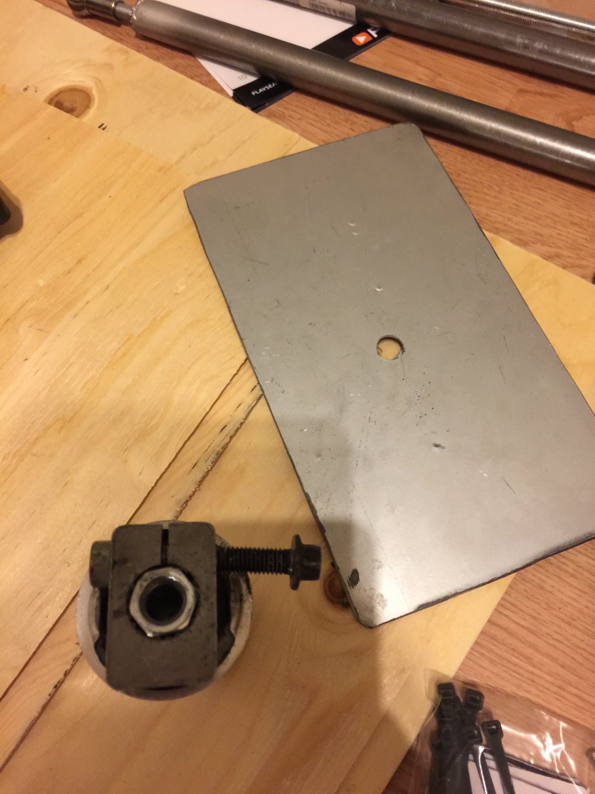

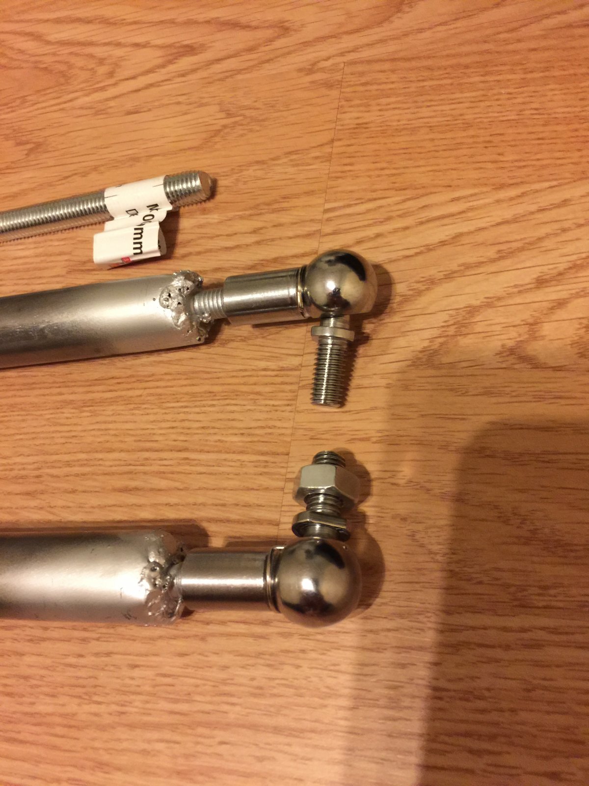

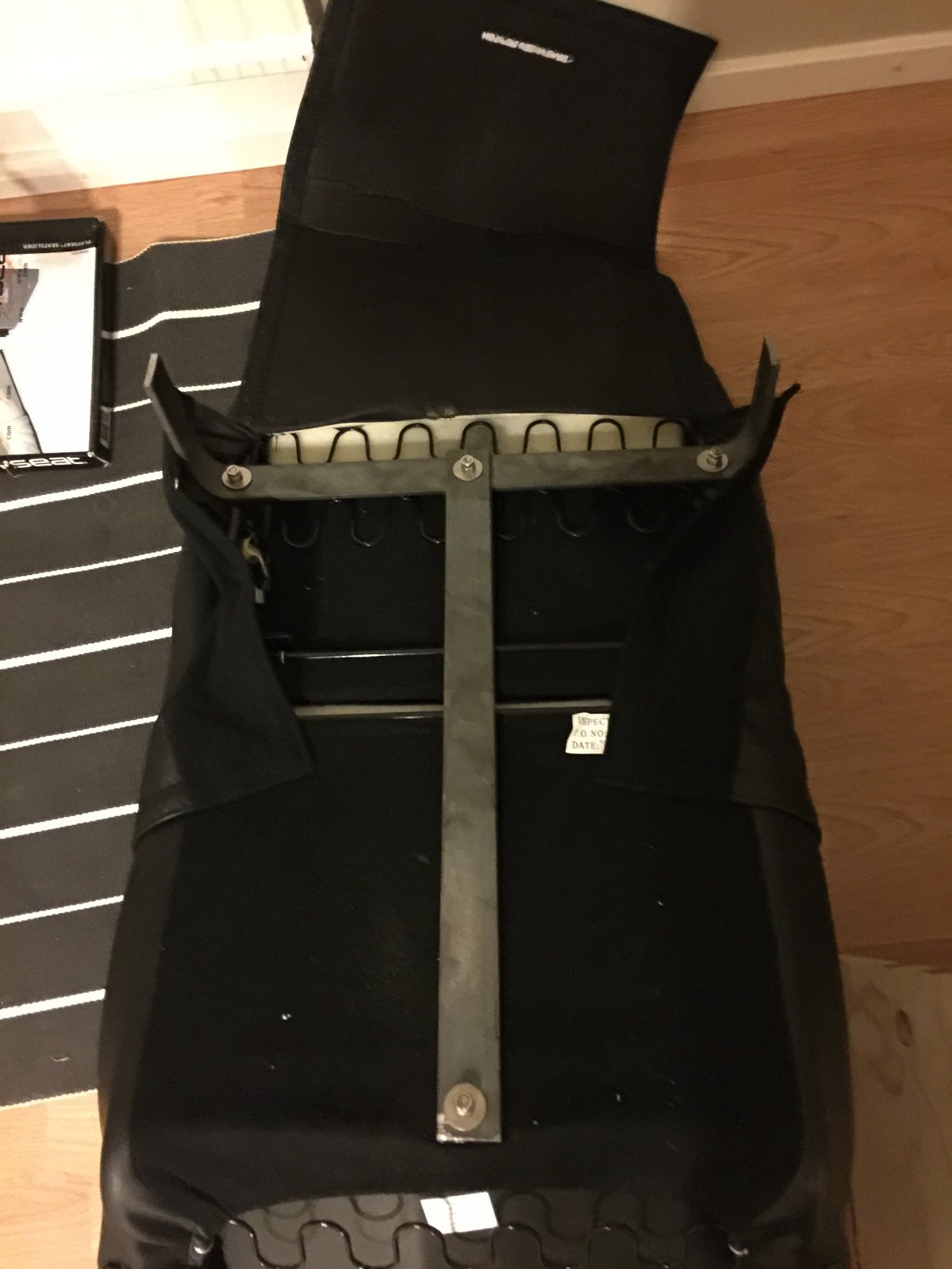

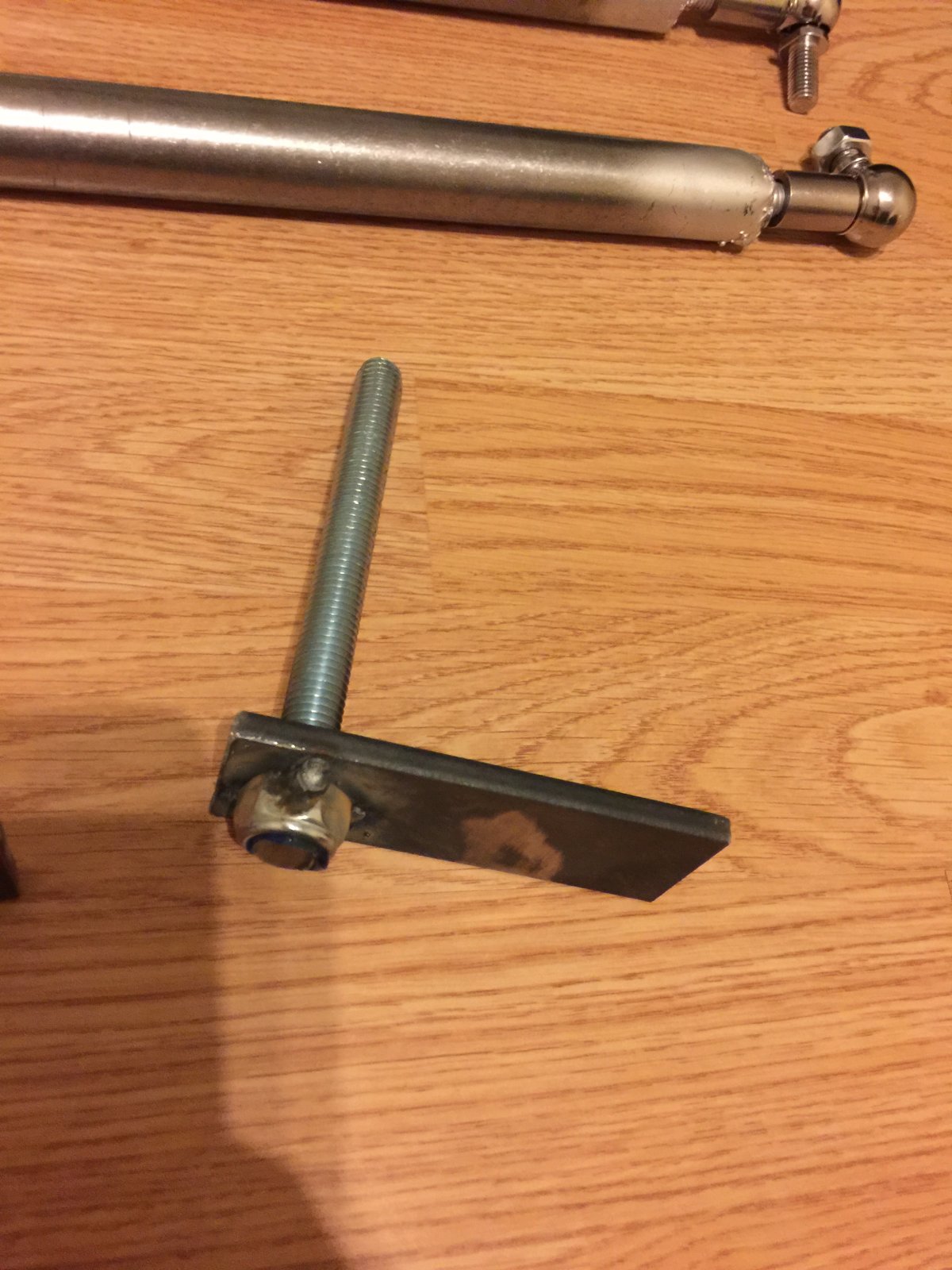

    ok now i have an update i made the t bar for the seat lever for the motors
    and on the u joint it will be with 12 mm bolts couldent weld them because u joint is aluminium
    hope the welding will work
    here is some picture
    left is cables to hook everything up
    and im waiting for the 12mm cooper to put the pot on
