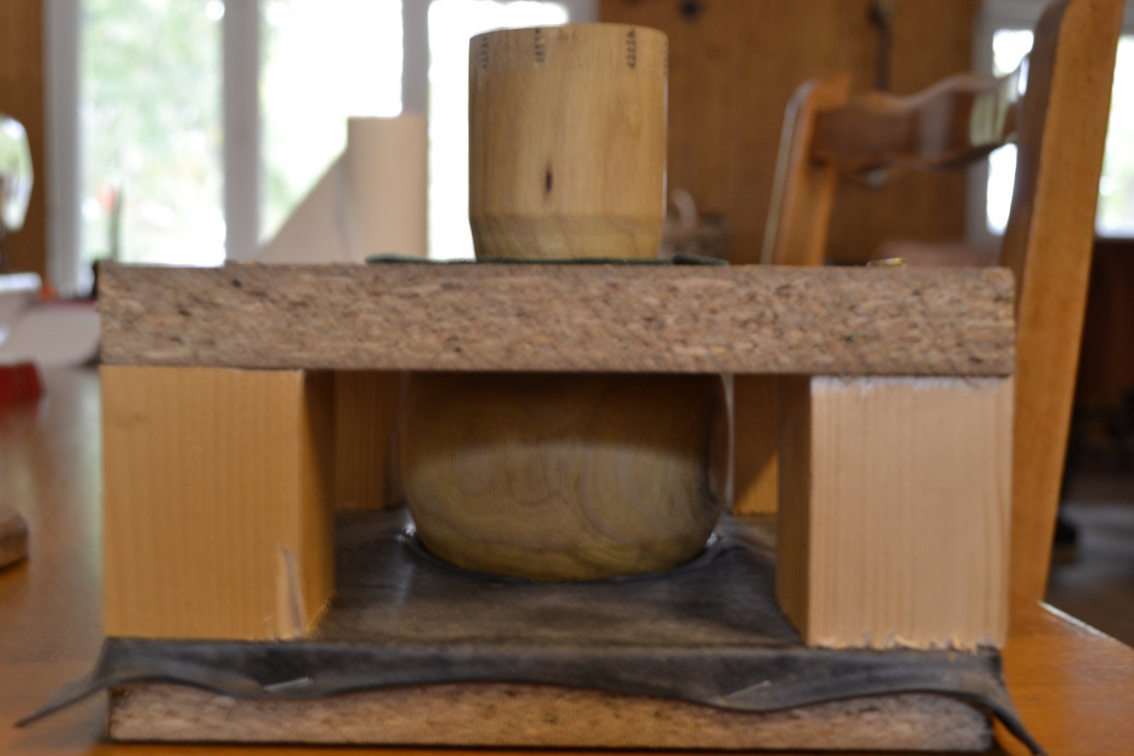

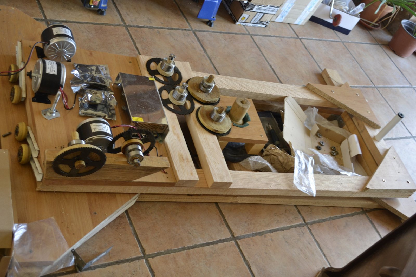

    As I've promised here is the thread about my build, it all started with the idea of blending motion sims and woodturning/working, this build is made to be a 3dof, but for now it's tested with 2dof. It is made with cheap solutions and stuff so it does not look very appealing, I ain't care about the prettyness as it shakes me all around !
    The things used here are :
    Wood : ( Robinier accacia ), Pin
    Motor : MY1016 250W 15.7A
    PSU : T1000-24
    Arduino Uno
    Parallel IBT's
    Screws and steel screw angles
    SMC3 Utils
    This is my first attempt at making a post presenting one of my projects, so I guess I'll have to edit it much times for it to be readable.
    This isn't final assembly and there is things to do again, like making the wooden wheels alot more thicker for stability... And of course remove those joint-bolts and fix the things, also my ball bearing aren't very aligned so it could be better, and chain lenght is not ideal, I should have added one more link

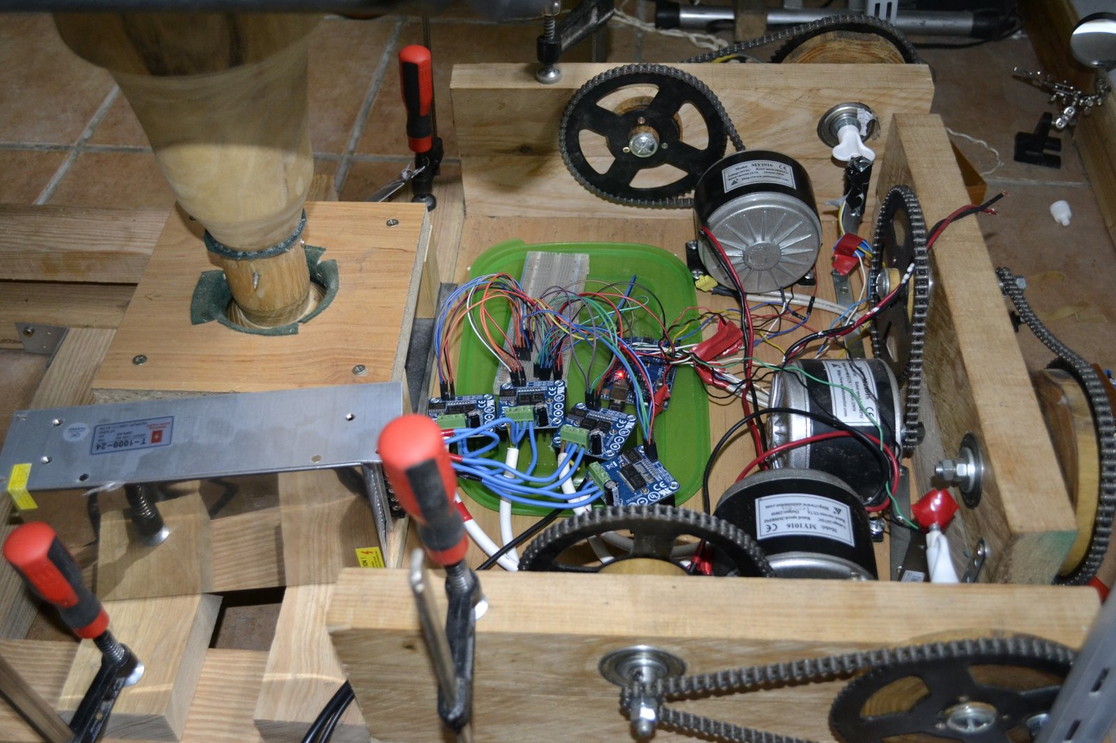

    The electronics are pretty messy and not soldered for now ( except those soldered wires on the arduino that I don't use anymore, got to remove them )...
    The PSU is a bit weak, I feel a better one would make it even better.
    But I plugged the thing on, setup axes config in Game engine, did a rallycross on LFS and it's so much fun and good... Even at this stage of the assembly... !!!

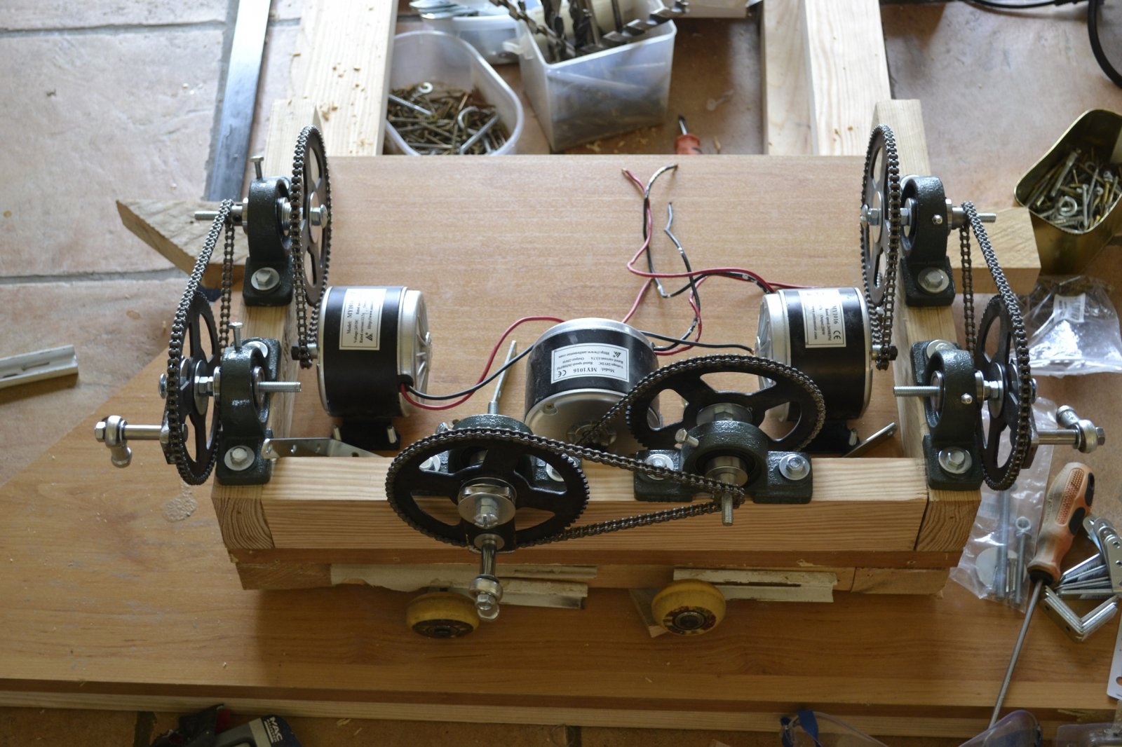

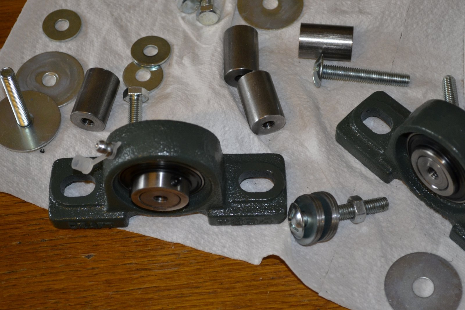

    While trying a funny rally stage I broke a wooden Wheel because as I said previously it was turned on endgrain, should have gone the other way, plus it wasn't thick enought, as I'm planning to play mainly with rally games I got some new stuff : UCP204 ball bearings to make my chain reductors and Ball-joints for the seat arms. Adding some steel to the thing, not that wood was a bad idea or couldn't work, it just would need to be thick enough, maybe i'll do another one with more wood, doing better wheels and bearing alignement, or i'll modify this one again, we will see...

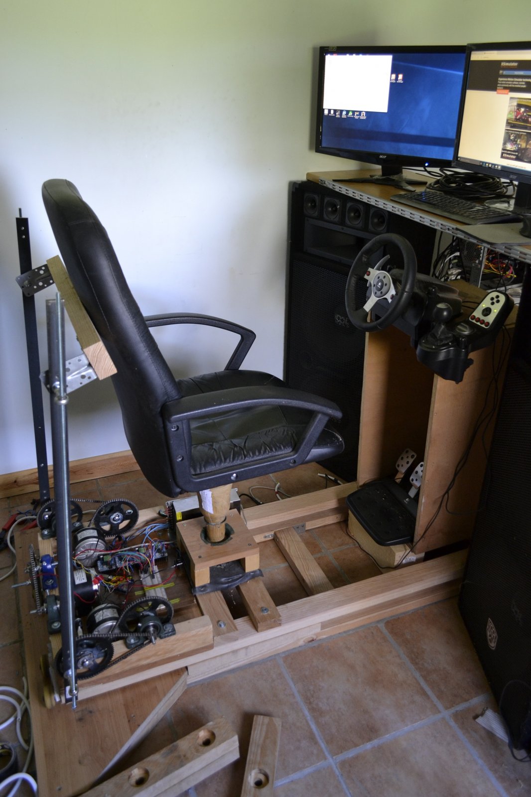

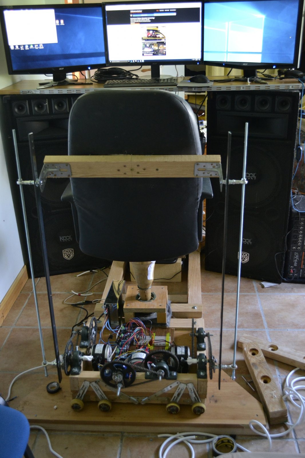

    I did put things together, it still works well, there is a bit of twist, but it's fun and reactive ! Hope this will shake me on much rally races, I will add the 3rd Dof soon, i need to sort some things first.. Then I'll do some videos ! Here are some new pics !
    EDIT 5 :
    Today I did longer shaky F1 session and the sim did shut down, because the ibt's got too hot ( too much to touch and started smelling ), hopefully they do not appear to be damaged, I waited untill they cooled then plugged again, still working fine, so i am going to work the on cooling before assembling the rest for the 3rd dof

    I didn't know that you can paralel IBTs, also, remove de heatsink and put some thermal paste as they come without it.

    Mariano68 : Hi, thanks for this fine advice. I should have been more precise on the project description because I did add some thermal paste between the sinks and board.
    Yes you can wire them the way OZHEAT shows on the pic attached, tested both configs A&B they work fine, when I use them they stay coldish after 30 minutes of working : ( Pwmax 70 - Kp 500 on the great smc3Utils as PSU can't handle more ) .
    OZHEAT warned me about Something on paralleling IBT-2's, that hopefully didn't happened to me :

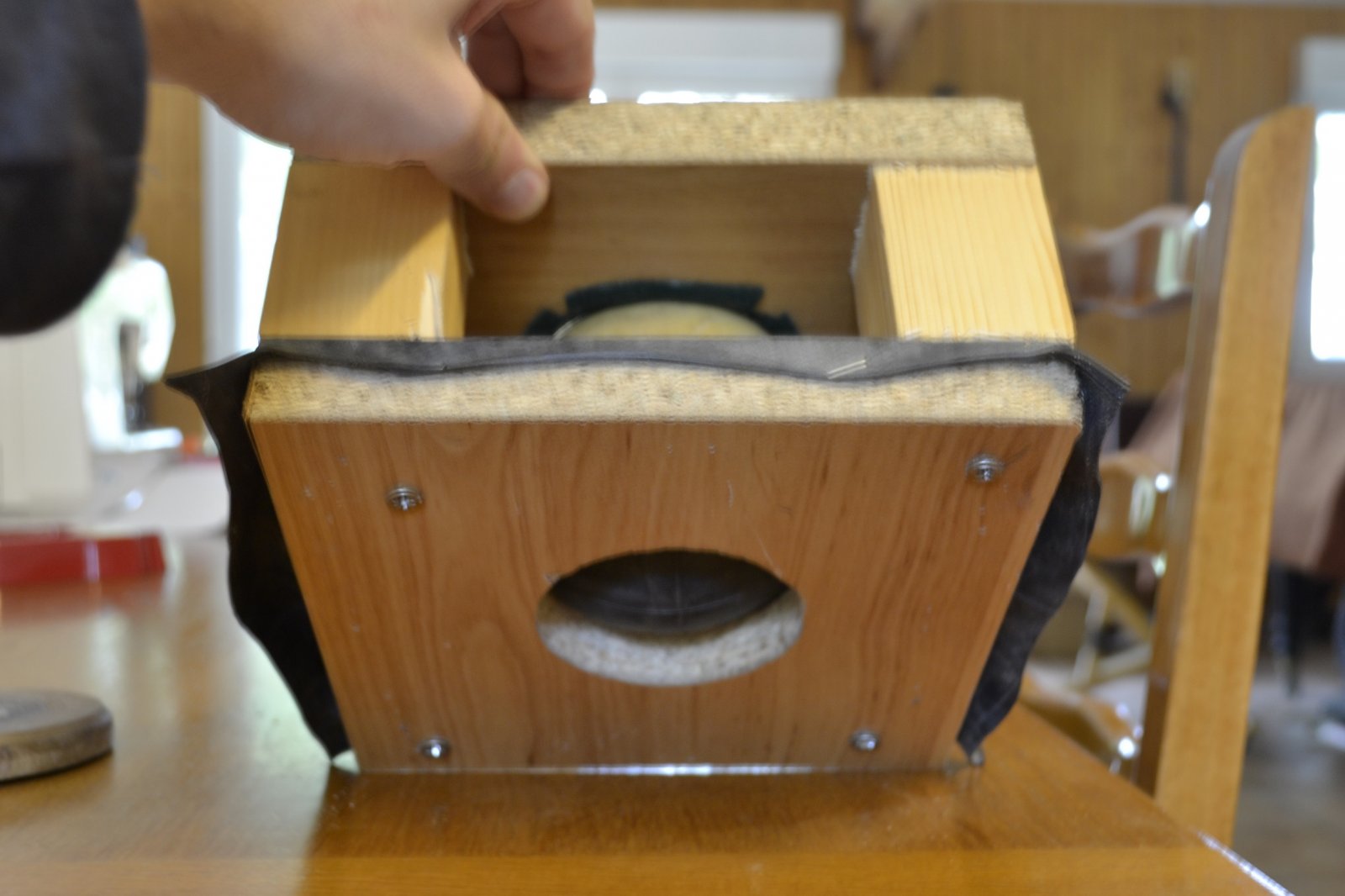

    I've never seen one either, the wooden sphere is laying on a wheel chamber and it is "floating" ( it's just a thin layer ) in oïl to ensure correct movement fluidity, I tried with vaseline but was to thick, now it's lemon oïl...
    The frame and is very sturdy and does not move, however I did use tape ( for now ) to fix the pots on those steel-angles and it's not correct, as they move a bit sometimes making the pot/wheel un-align ( not that much but still).. Also the bars I use from the chain wheels to the sit are too flexible, i need to double them or get Something stronger, then it should be better !.
