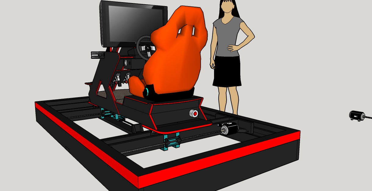

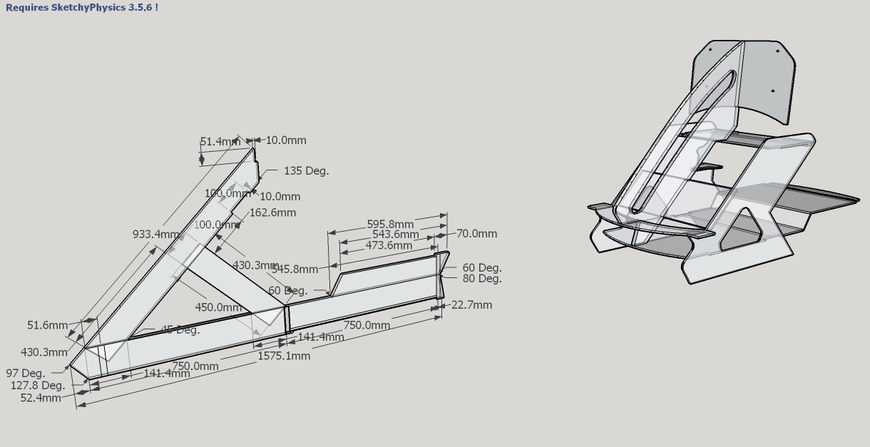

    As usual everything starts with inspiration ideas from this great site ... thanks to you all hug: ... and I was attracted to make a traction loss with sway in the beginning ... but it turned up to be a great drifting mechanism :grin ...
    it all started 4 months ago with sketchup and SketchyPhysics with my own design for this cockpit model ...
    Hooked to SimTools via this great tutorial and tested it see some results here ...

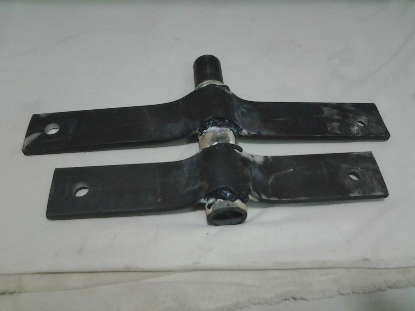

    then started with the core front and rear bearings arms and the frame ...
    the center shaft ...

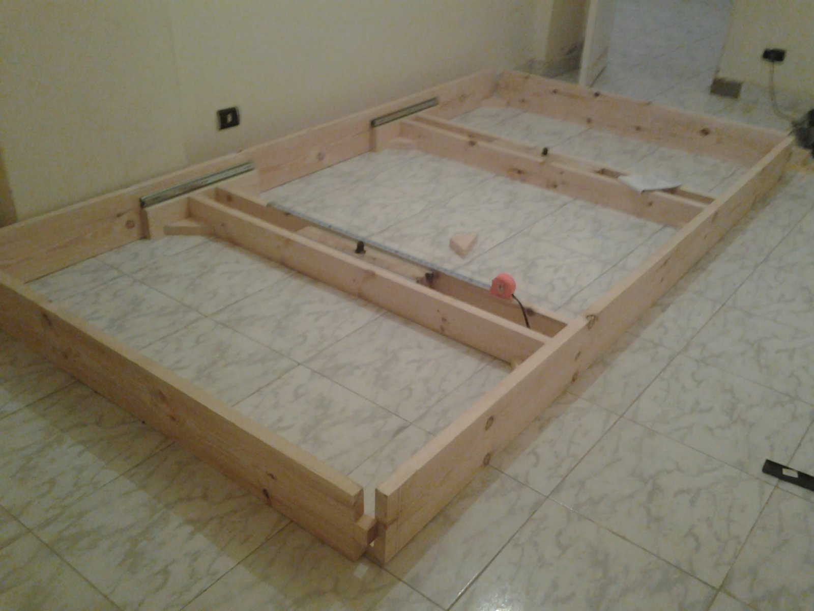

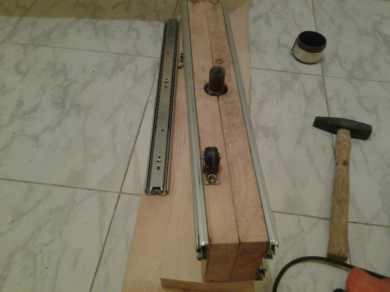

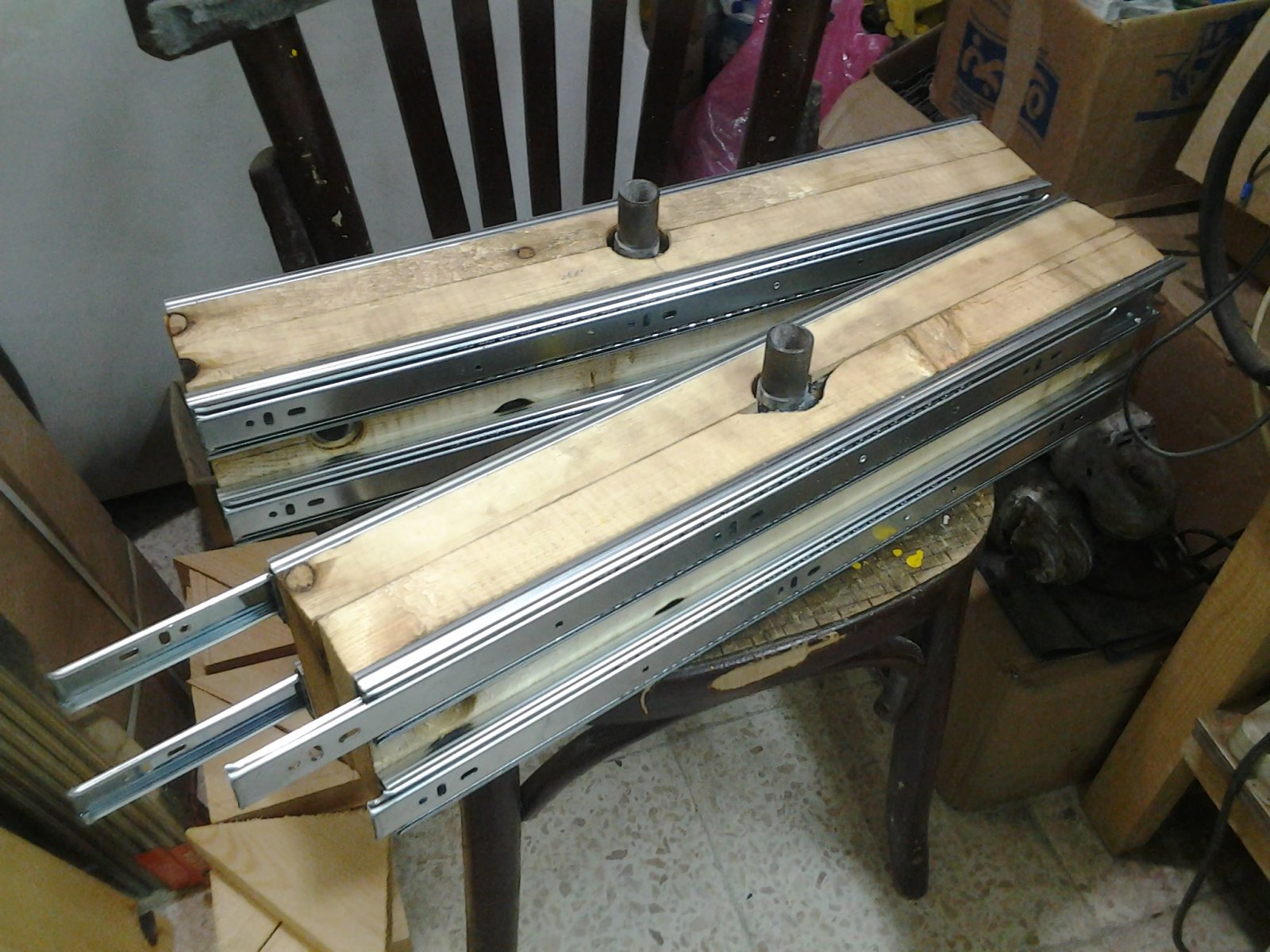

    fastened inside a two wooden blocks gave me this solid peace ...
    then to the second level support arms ...

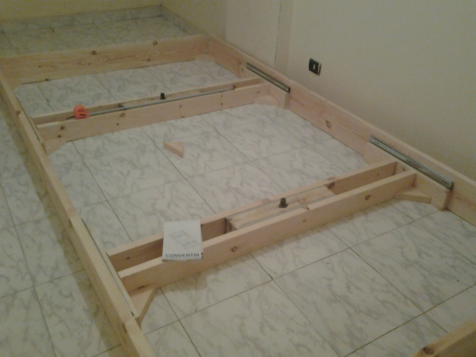

    moving to the frame ...

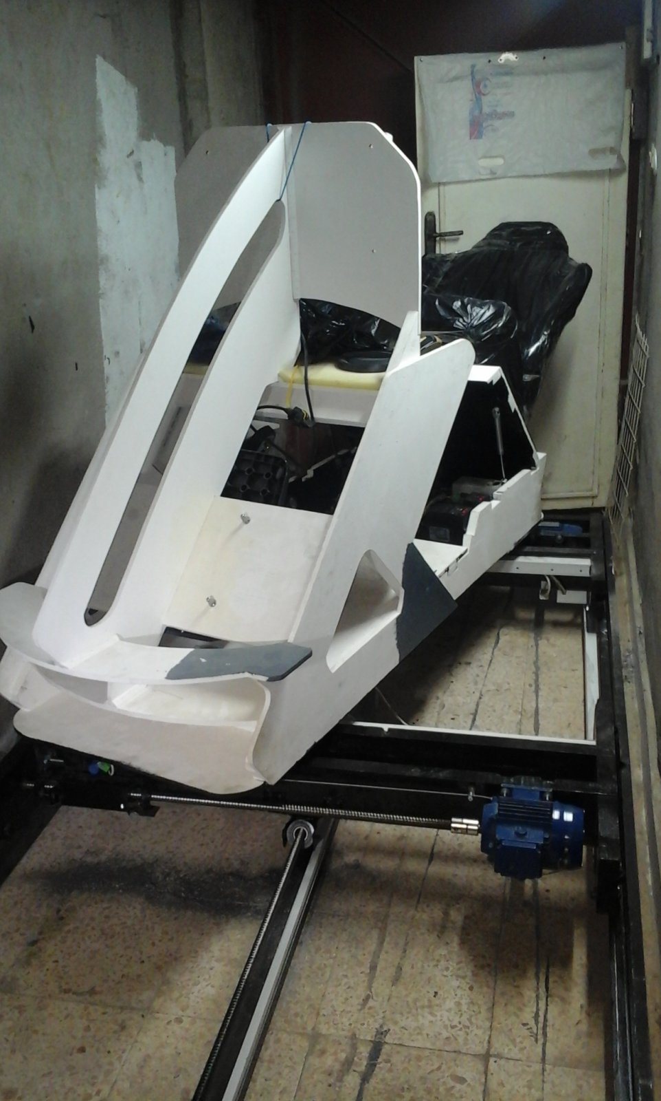

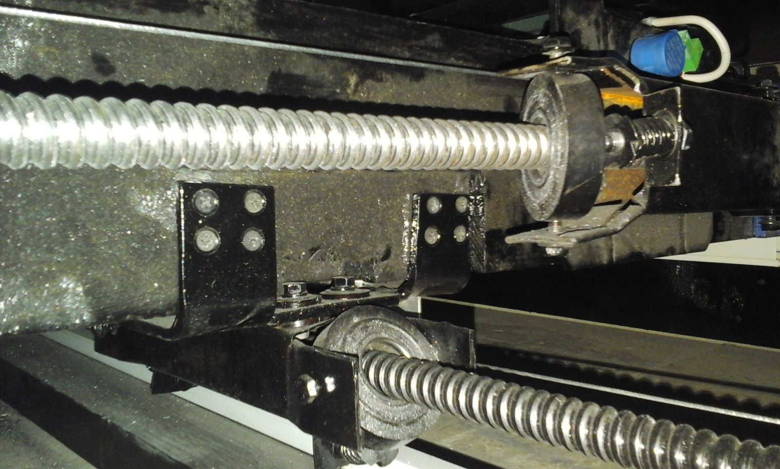

    I have almost finished it buddy ... :cheers

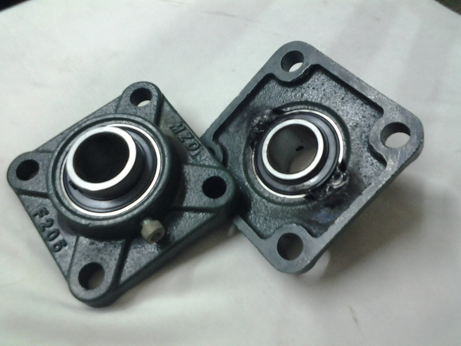

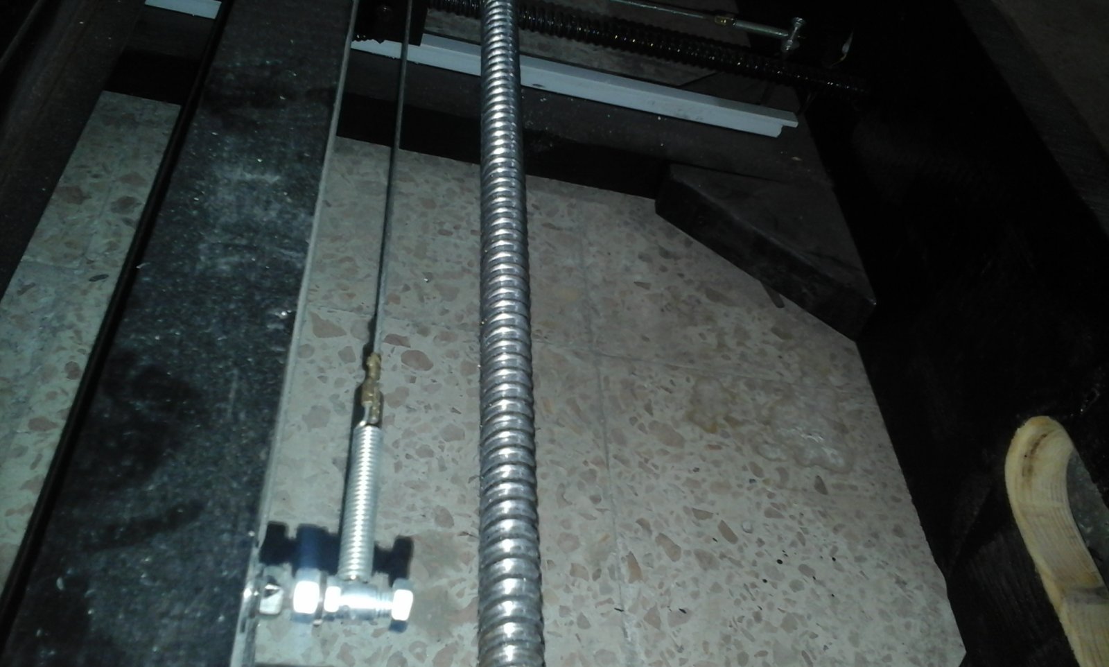

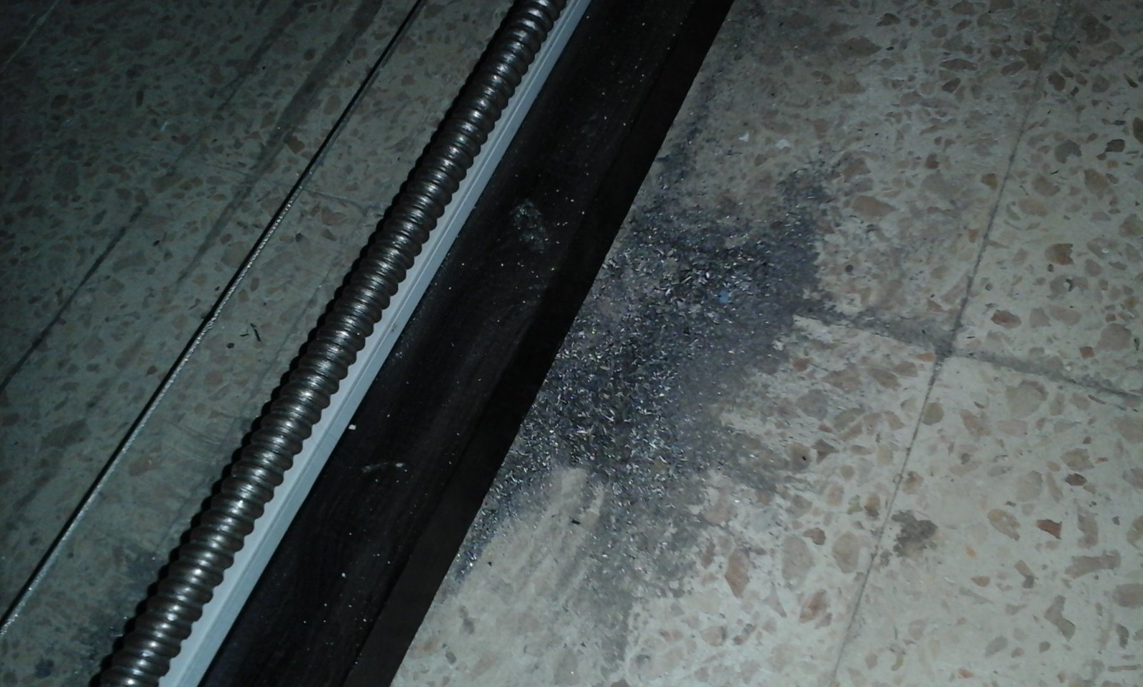

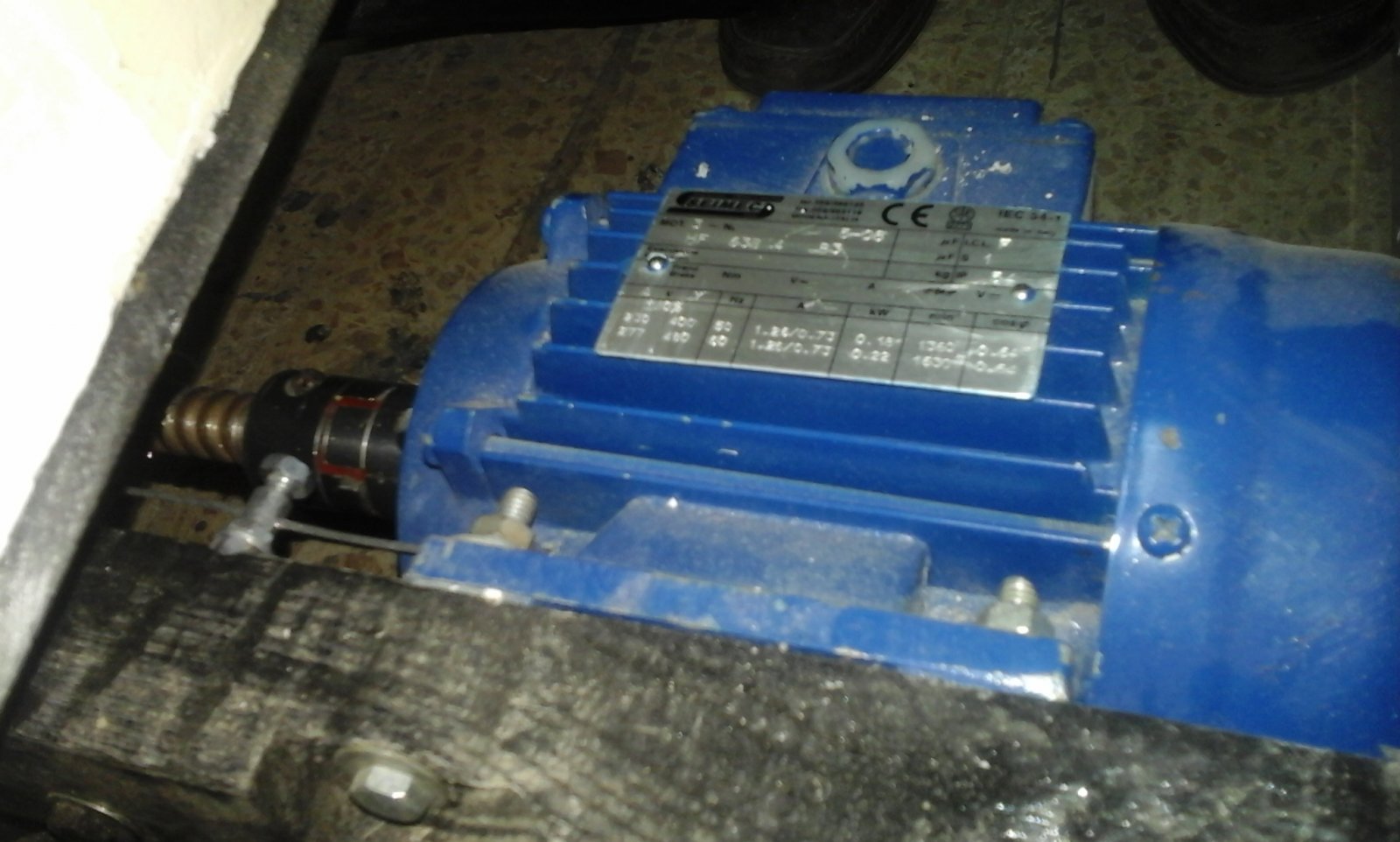

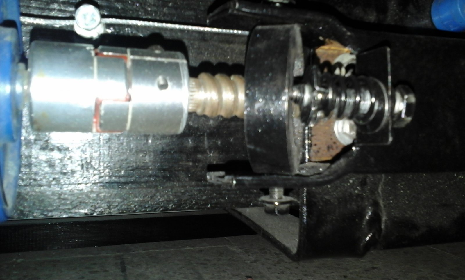

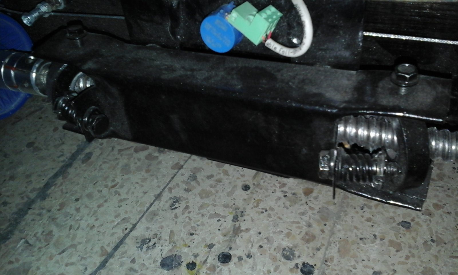

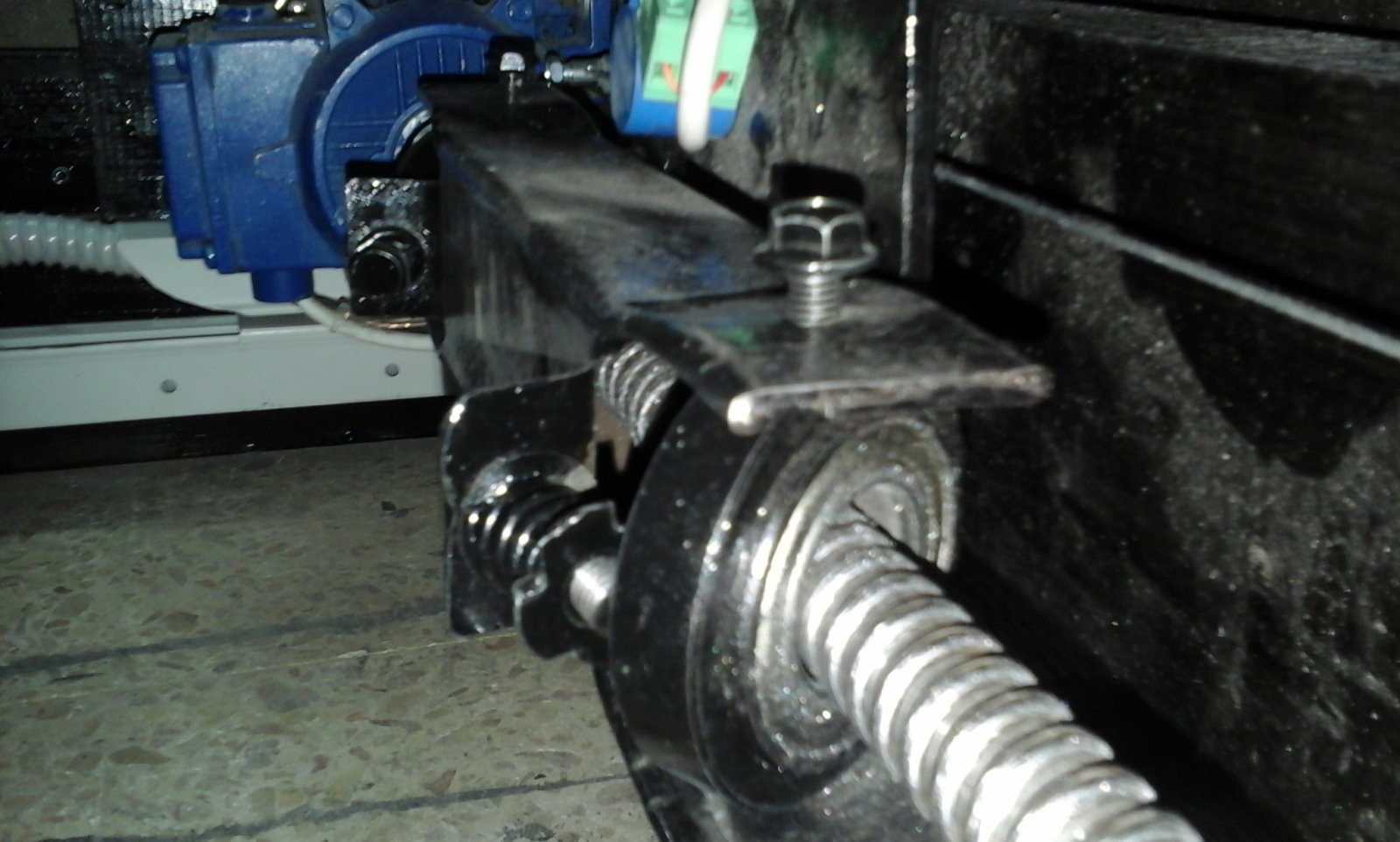

    waiting for a 1605 ball screw shaft and nuts to replace these lead screw with bearings Idea ... it turned out that shaft are so soft Iron to handle the fast motion ... a lot of Iron filings is coming out .

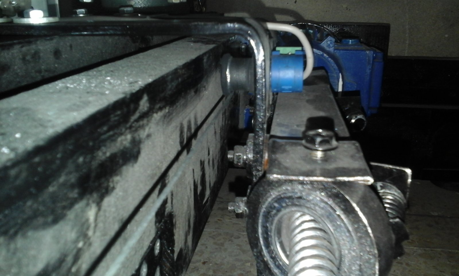

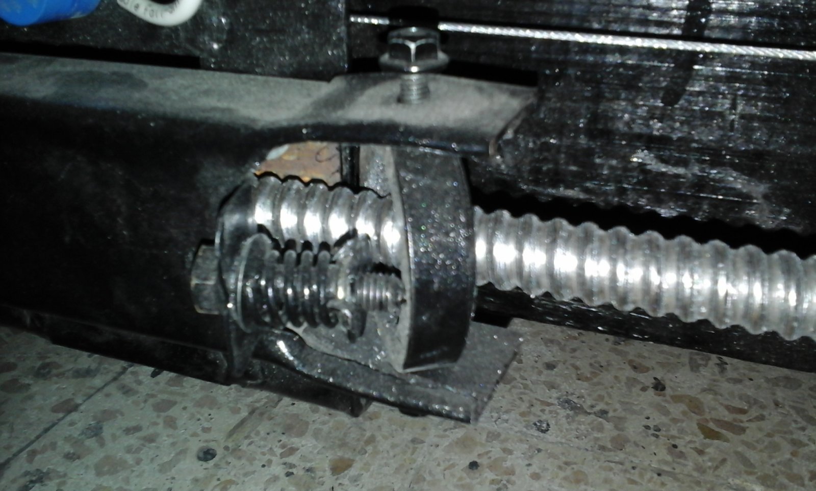

    Is that bearing setup designed to avoid backlash? It looks like maybe a spring on each bearing forcing them apart to keep some pressure on them?

    which is already there :thumbs ... but my lead screw seemed not hardened after "cold rolled " so is giving filings OR the bearings are jumping the threads if spring is lightened ... I can't get a spring pressure balance between this and that :confused:...
    20160406_055712.jpg 20160406_055642.jpg 20160406_055607.jpg 20160406_061223.jpg 20160406_061249.jpg

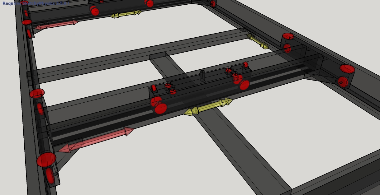

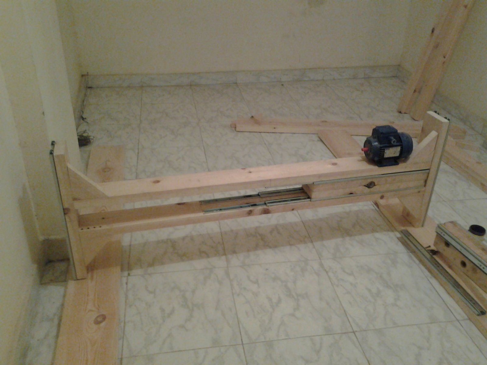

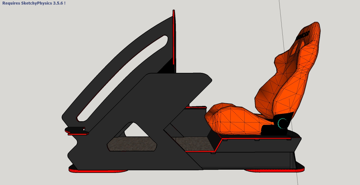

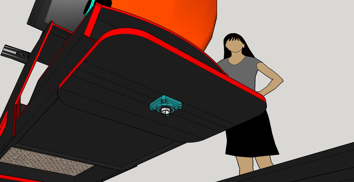

    Woodworking and building the chair bridge steps started after testing everything under SketchyPhysics ...
    A flat layout for all the MDF parts are exported to a .cdr file then to an artcut pattern drawing on A0 sheets ...

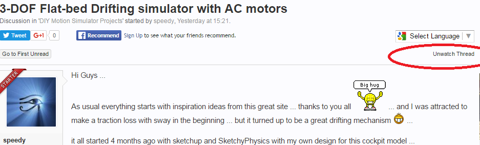

    looking forward to seeing this finished. How do i subscribe to it?
    Found the watch thread button

    @crammy above the first post at the right is a watch thread button. mine is already clicked :)

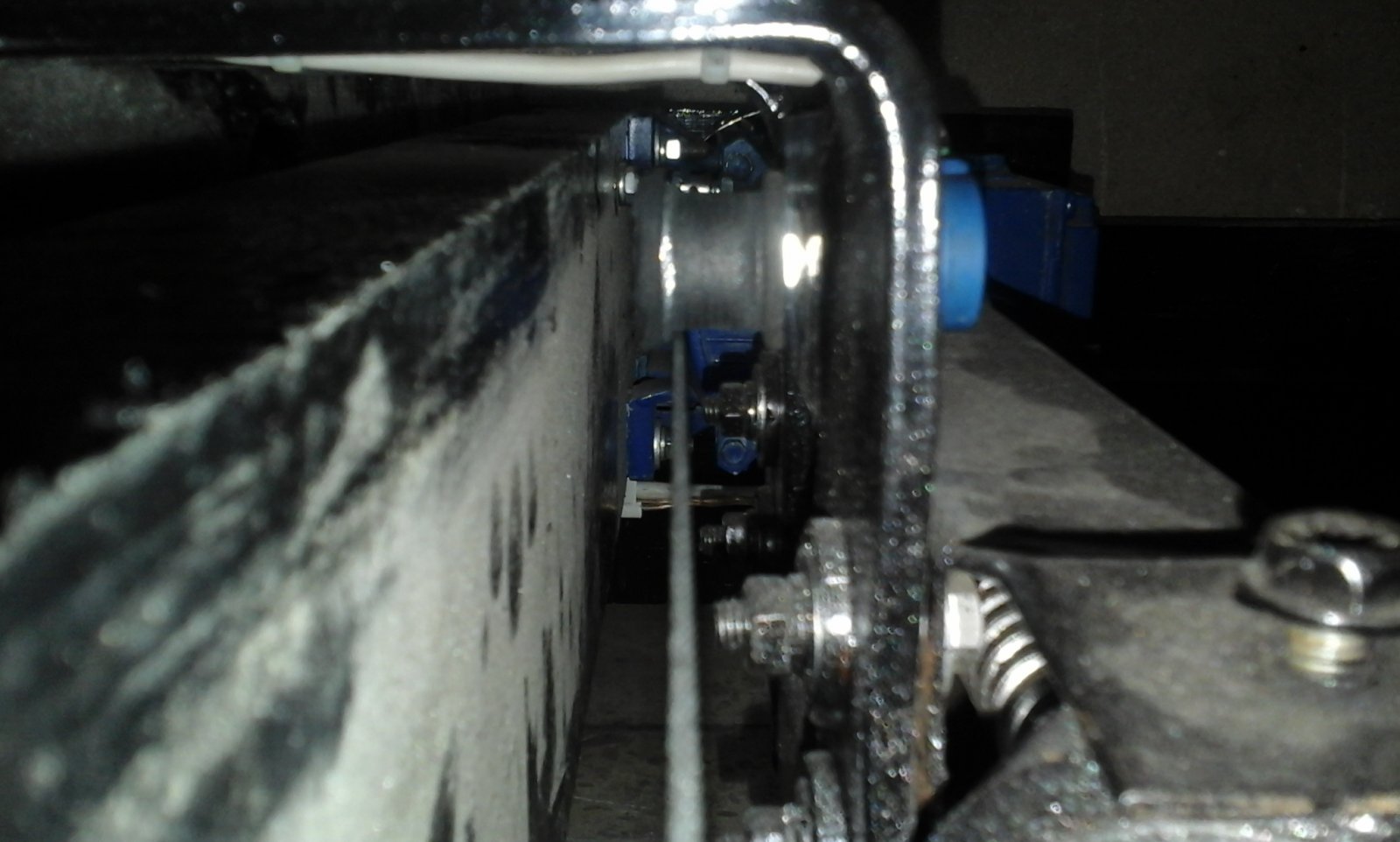

    For feedback pot I'm using a 10k 10 turns regular pot with a 3cm roller on it's axe to give me a travelling distance of a 9.5cm for each turn that would be a 95cm for the full 10 turns with max resolution ... which I have a 90cm travelling distance so it will not reach the breaking limit for the pot sparing 1/2 turn on each side ... then using a bicycle breaking wire and a spring to get the linear to circular action needed ...

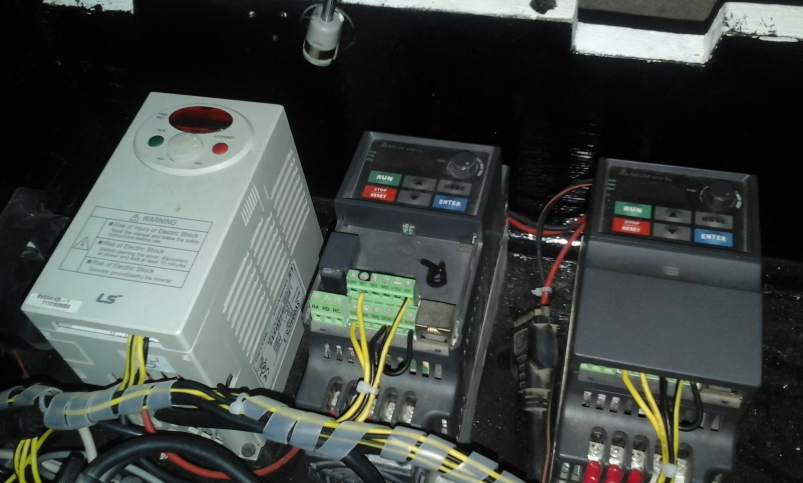

    For VFD's I used my old 1 HP inverters ...

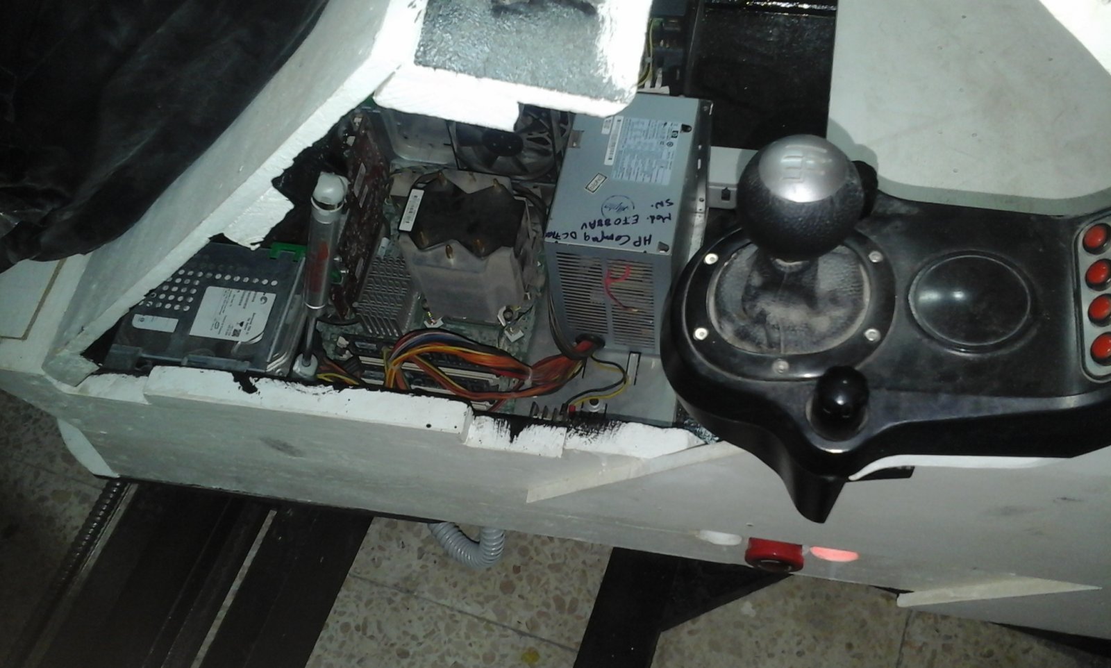

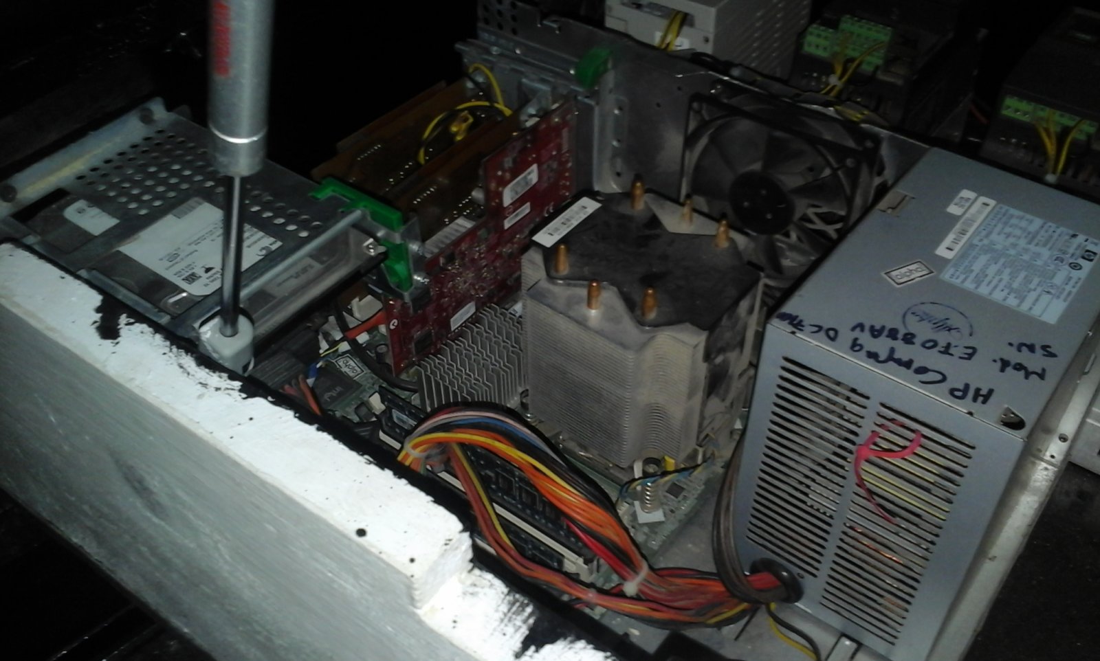

    For computer I salvaged the MB and the HD from an HP compaq CD7700 minitower with some of it's case chases to fasten everything securely under the seat ...

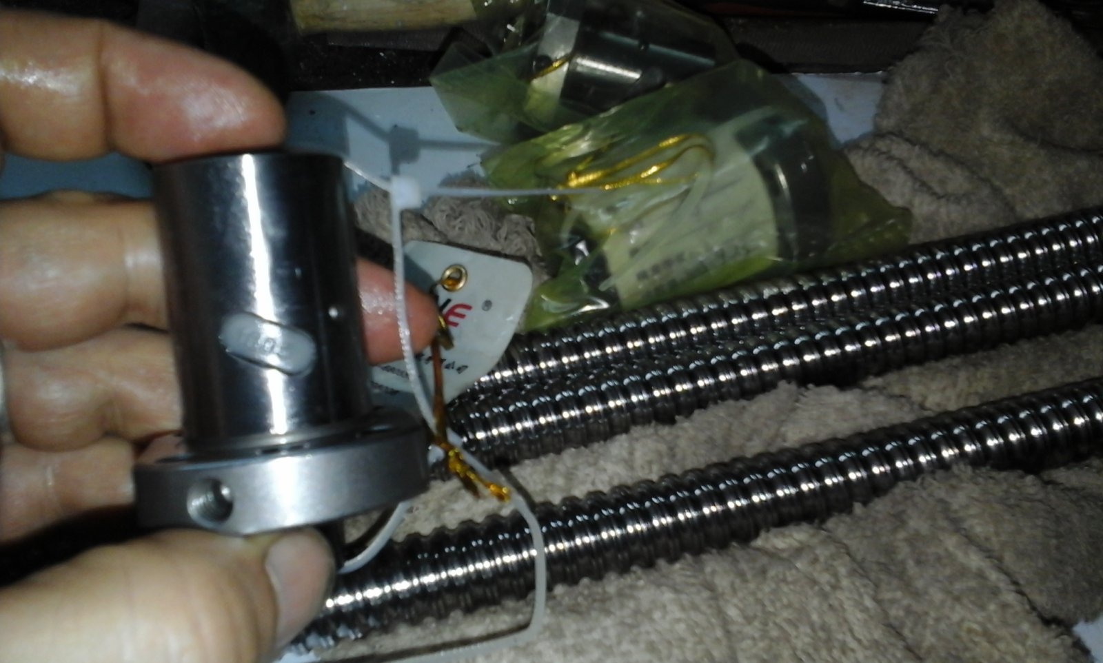

    The 1605 ball screw with Nut has just arrived ... So back to work :) .

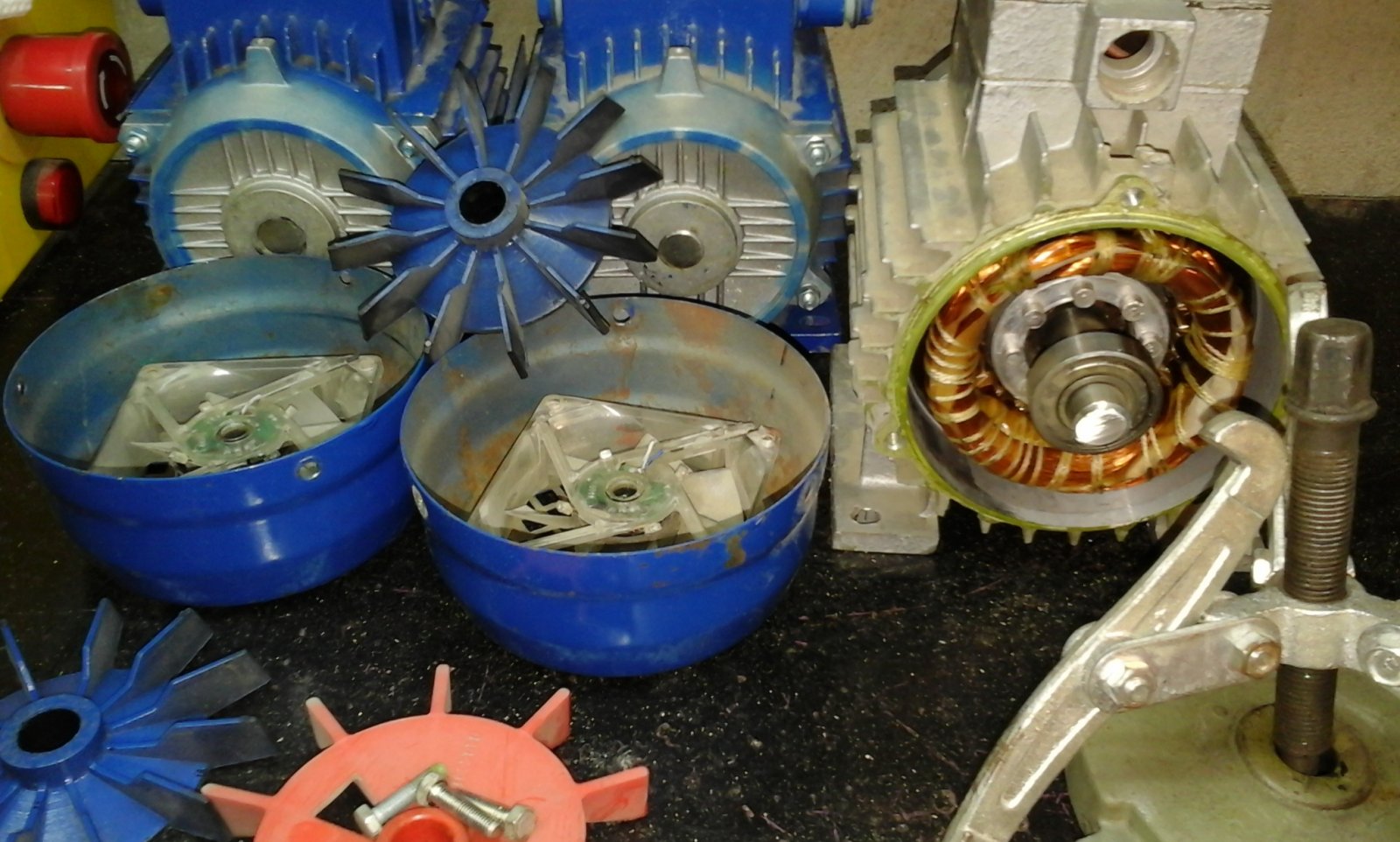

    For motors continuous cooling I cut the motors shaft flushed to the rear end cover and replaced them with a 12v 8cmx8cm fans ...

    Question Speedy - Can you still use your existing rear motor impellers that came on the motors for cooling also????? I know mine are large with a number of blades for cooling?

    Of course not ... and I mean I removed the "impellers" and cut the motors shaft itself ... so there is room to install the 12v fans inside the back cover ... plus it looks good too .
    The issue is those impellers "in my motors" are designed to give air at the rated operating RPM ... they are not VFD ready as yours . So, That's why ? :thumbs

    Thanks so much. I thought you were using the "inverter duty" motors. My bad...........................looks good friend. Happy for you!
