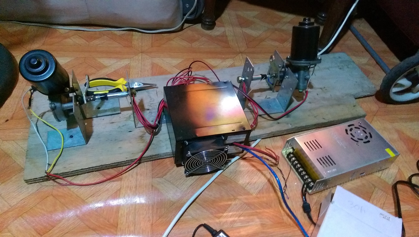

    Hi Guys, I am currently doing a 2dof simulator. All I have as of now are the wiper motors of a Toyota SUV, Power Supply 12v 30a, 2 Potentiometers. I would like to know which Arduino Code you like to recommend for me, but currently I'm using RacingMat's. I have encased the Arduino and MM in a CPU Power Supply Case with a heatsink in and fan.
    Still short of cash to buying racing wheels and seat. :)
    Let's do this :)

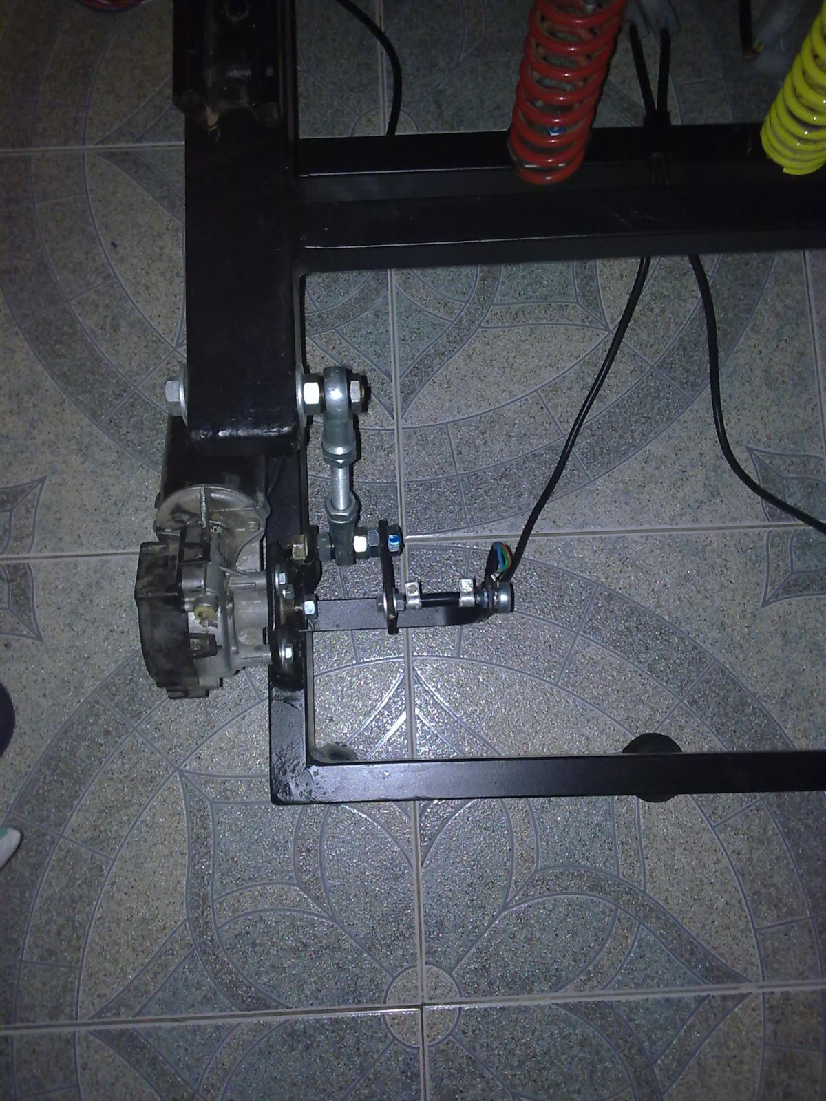

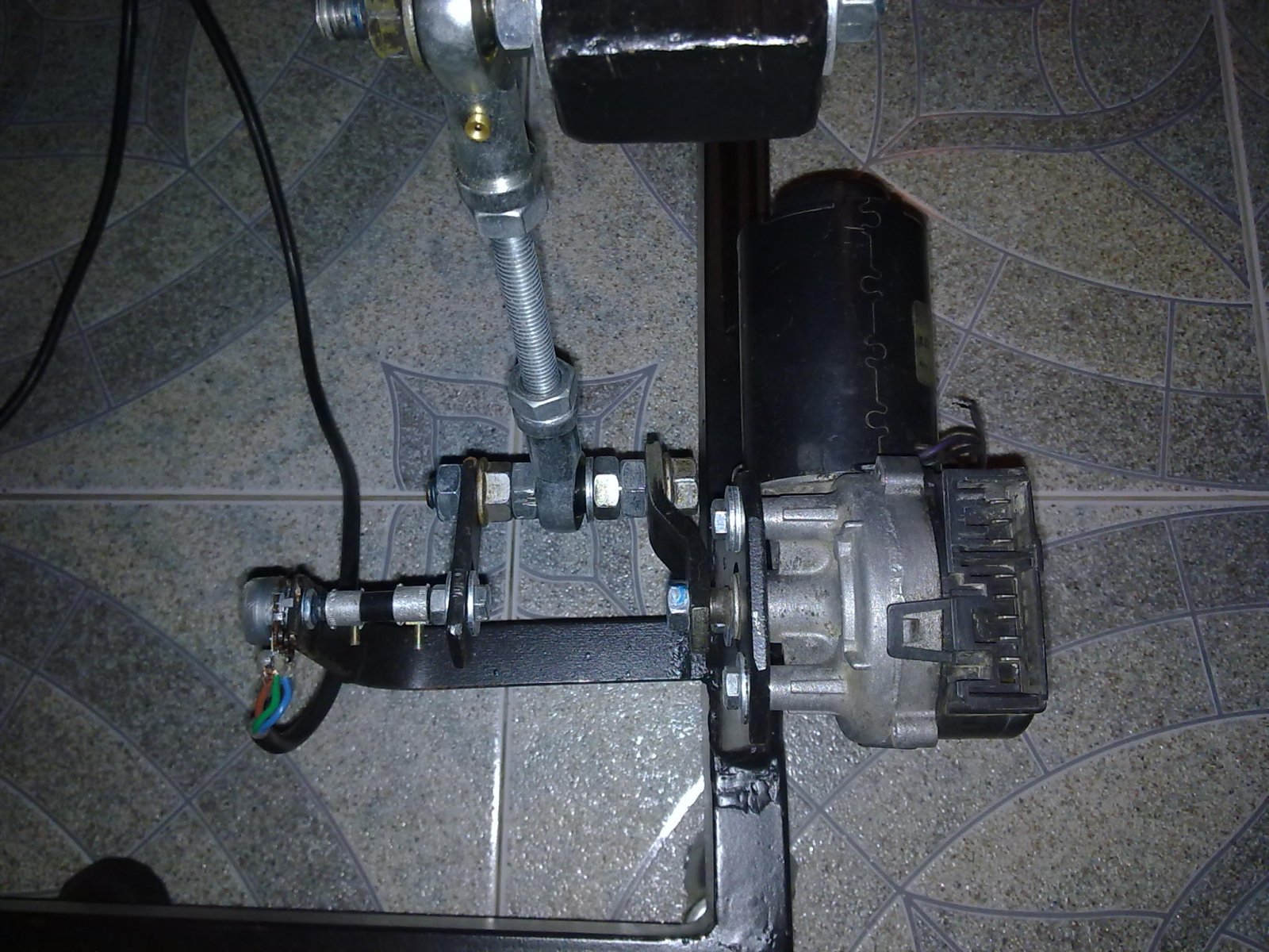

    On the potentiometers, I would change so that there were no problem if given a full turn.

    Sorry, I forgot the image.

    Wow great idea. I would love to do it. Thanks for this @merchan-e.
