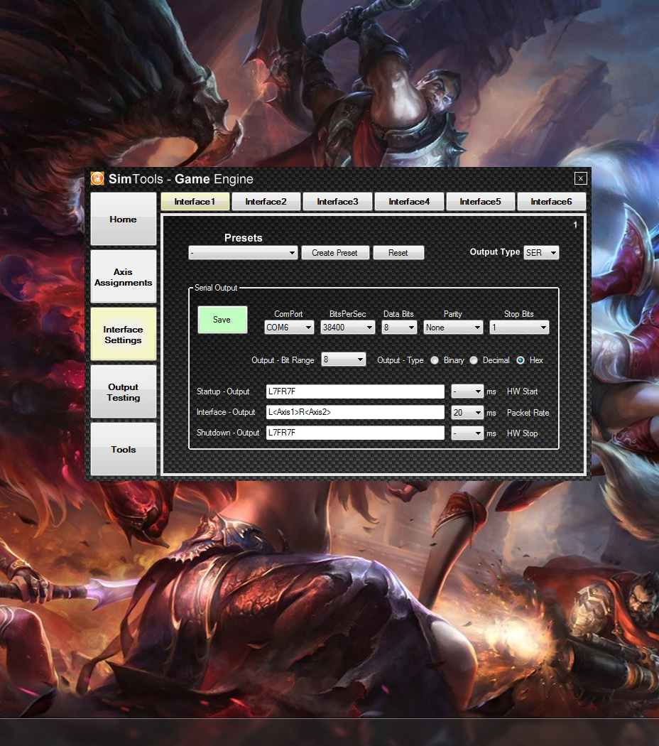

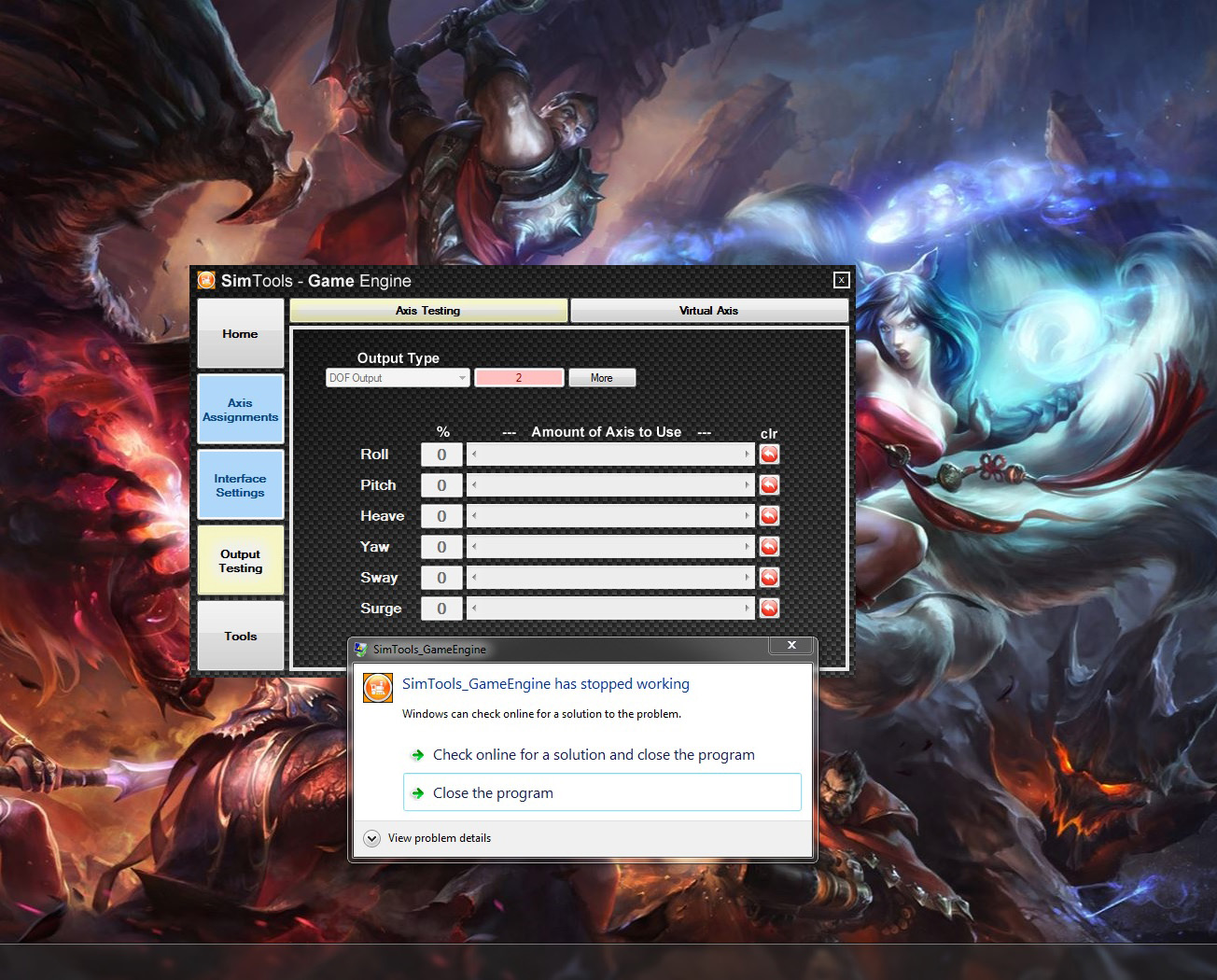

    :sos I have a problem.Simtools Game Engine stop work frequently in games and test zone . I think is arduino a cause of all these crashes.

    Hi Mat
    The version of Simtools is 1.2. These happens in all games and also in testing. I disconnect a 1000 times arduino sometimes work for a 10 min some times 0 min
    Here is some screenshot of error.
    Greetings

    That's the serial port on the Ardunio crashing , caused by an overflow of data, Typical of an Ardunio the Usb port is not that stable on some machines.
    Try lowering the baud rate to help the Ard.
    Try using a different USB port, even a different cable too before changing any code etc.
    Noticed too your motion is very soft, but there.

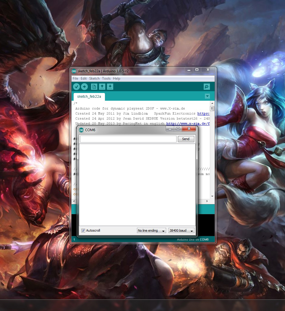

    Where did you change the baud rates and did you make sure that the original baud rate matched in Windows and Simtools? You might have had one set to 9600 and the other something different. Changing the one that did not match 9600 allowed them to communicate but you might still be able to run at a much higher baud rate.
    Mat's code is set for 115200, both Simtools and Windows should be set to the same speed. This worked perfectly for me with this code.
    As Rob mentioned, if you have a poorly performing USB port try using a different port on the PC or a different USB cable. I too had an issue with an Arduino dropping out and found it was the cable going to that controller.

    As Historiker told you, can you check all the settings in the post:
    - windows
    - Arduino IDE
    - Simtools
    Give us some more screenshots ;-)
    There should be a mistake somewhere in your setup as more than a dozen sims are doing well!

  16. RacingMat
    2,237
    21,023Coins
    the same as I did in the tut ;-)
    windows com port
    windows com port properties
    arduino ide baudrate
    simtools interface preset (you have sent it earlier)

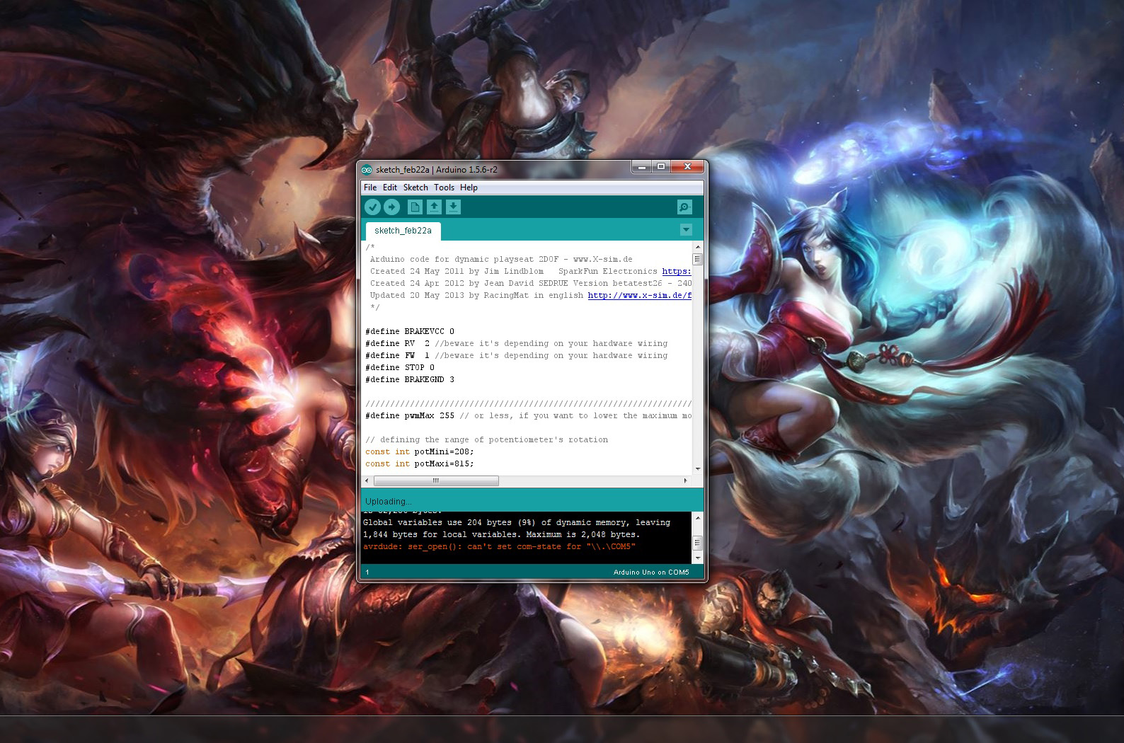

  18. RacingMat
    2,237
    21,023Coins
    @Ramok : if you lowered in the Com port, did you change also within the code?
    You have to make everything coherent everywhere ;-)
    Code:
    // INITIALIZATION
    void setup()
      // serial initialization
      Serial.begin(115200);
    I guess it's hardware somewhere:
    - arduino: What kind of arduino did you buy? Do you have a link
    - as said Eaorobbie: usb port on computer or hub?
    - your PC powersupply is too low and arduino not supplied enough: try an external supply maybe?

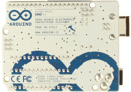

    @RacingMat
    I bought Arduino R3.
    Yes. Changed everything even in ard code.
    Now testing with external power supply,looks like working for now
