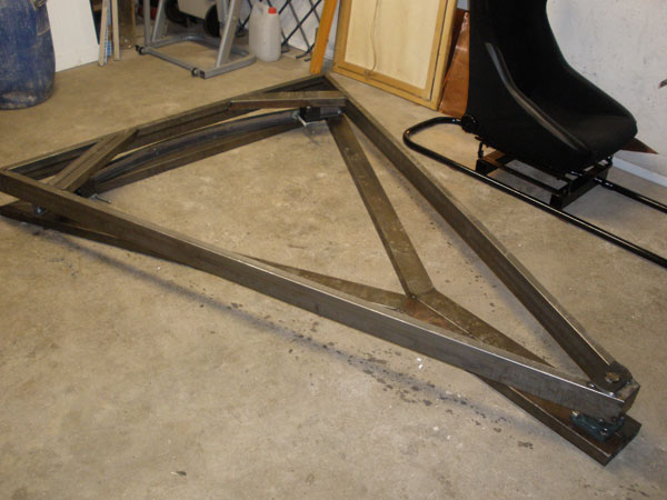

    Hi all,

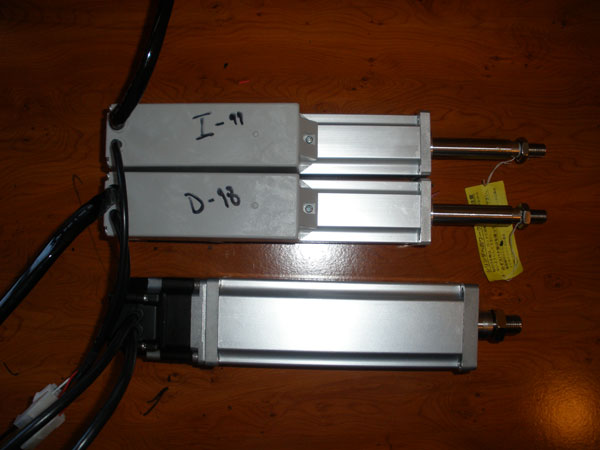

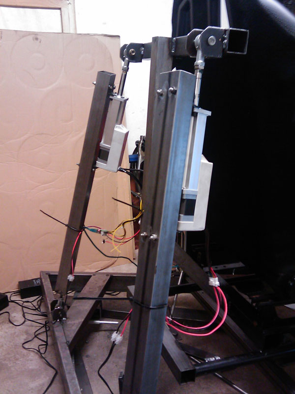

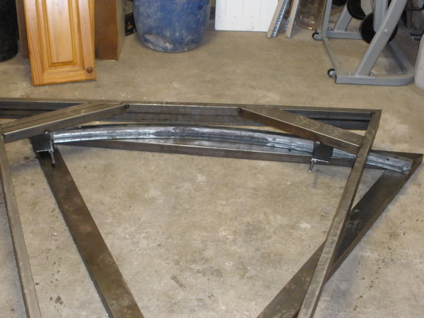

    A friend and I have started a 2DOF motion simulator with a third axis. The 3rd axis is used to simulate rotation movements (drifting).
    We have ordered two SCN5 actuators and one SCN6 actuator and we hope that three actuators arrive in early May to Canary Islands.
    However, last week we have started to build the structure of simulator.
    In this post I will put the progress of our motion simulator.
    I hope to receive feedback from the X-sim community to improve it
    To begin I have attached some images of the initial structure.

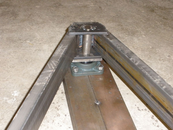

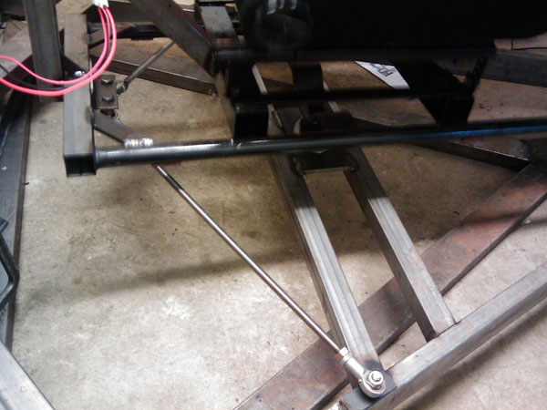

    1. Initial structure. You can appreciate a rotation axis and two wheels at the end
    2. Rotation axis
    3. Rotation axis

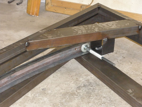

    4. Right wheel
    5. Structure shifted to the left

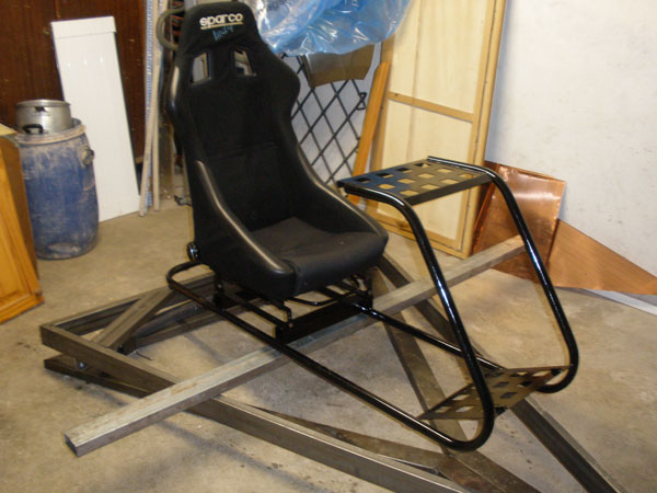

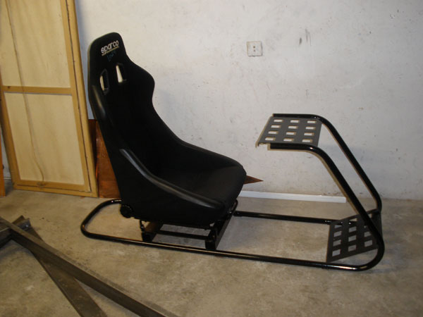

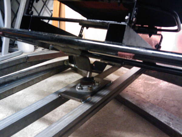

    6. Static seat with base for pedals and handwheel (seat structure)
    7. Seat on the structure (it is not mounted).

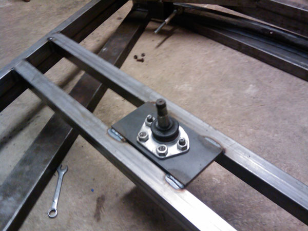

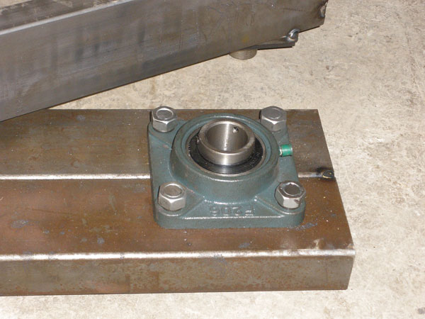

    We are seeking a pivot to put the seat structure on the rotation structure.
    Regards,
    David

    Hi all,
    I've received the actuators :yippiee:
    I've tested SCN5 actuators and they were right. :clap:
    Next days I will test SCN6 with SCN5 plugin. I will inform if it is compatible

    Hi all,
    I have installed the SCN5 actuators in simulator. I have tested it with GTR2, and it is fantastic :clap:
    I attach several images.
    Regards,

    Hi again,

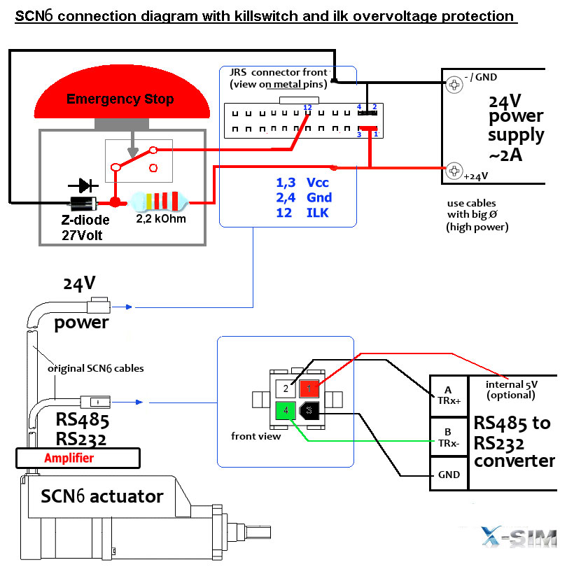

    Also, I have tested SCN6 actuator. It is automatically detected by Force-Profiler using SCN5 serial.
    I've used Test plugin in Force Sender and it was right :thbup:
    Attach image with connection diagram with ILK protection. It is similar to SCN5. However, the pins connection is different.
