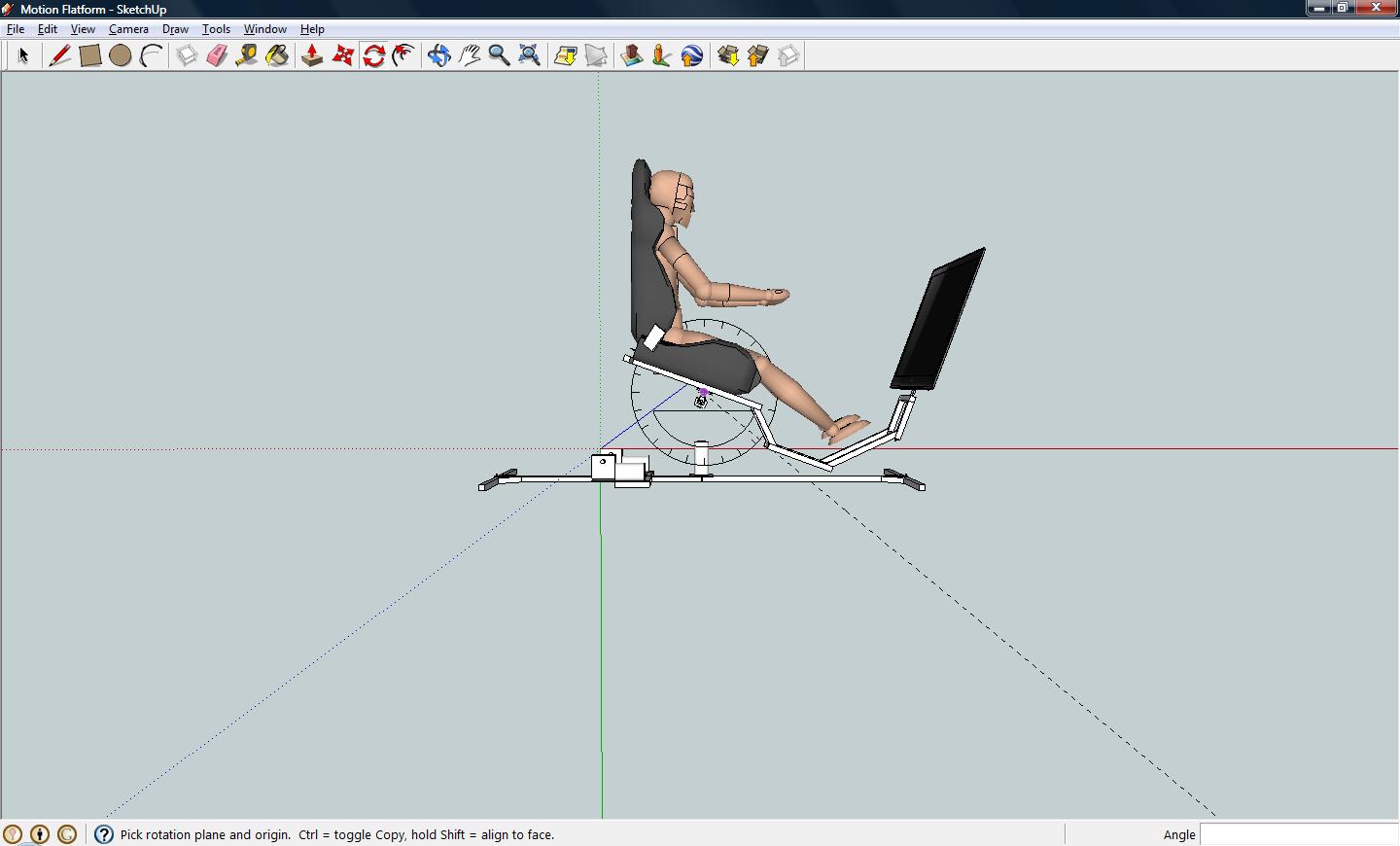

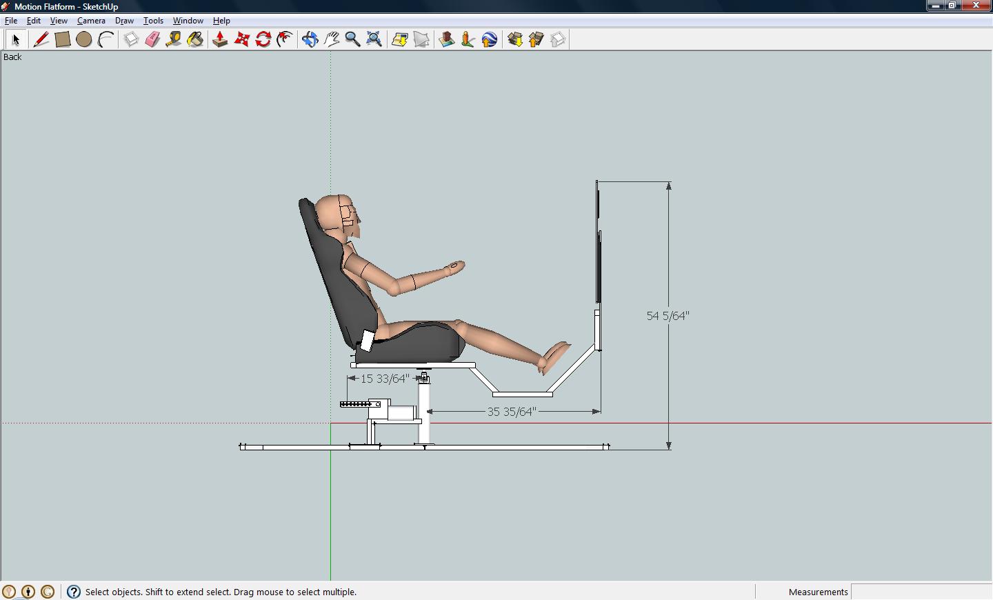

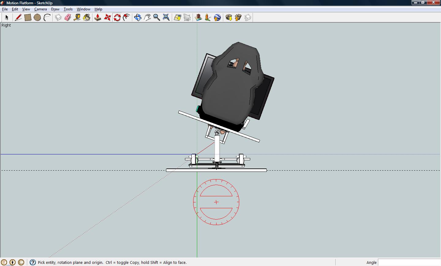

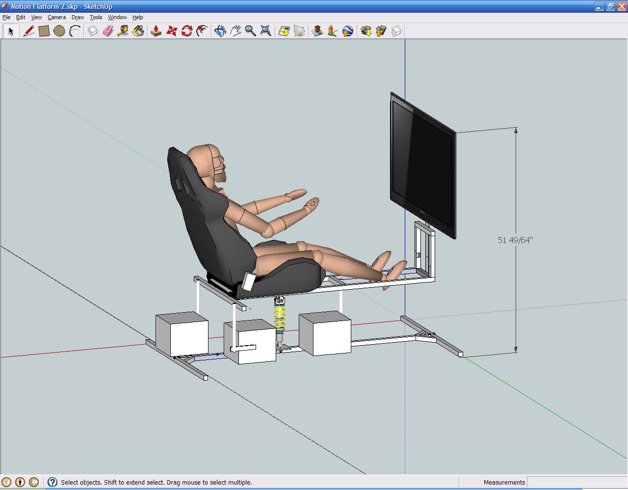

    I'm finally getting around to building something I've always wanted - a motion simulator for flying and driving. I'm attempting to do both on a single rig using JRK's and winches; starting with 2DOF and with the potential to add traction loss and heave later on - we'll see how it goes!
    First, here are some old jpegs using Sketchup from about 2 years ago. These show the basic idea I'm after although the final result will certainly look a bit different. Here I was considering use of Wipers, Wormgear motors, or Winches.

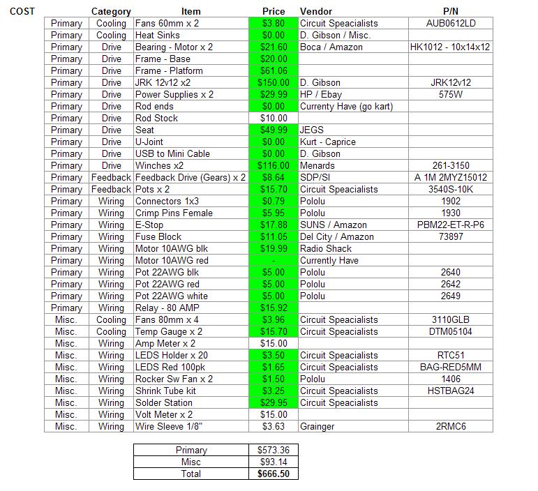

    Now that purchasing the hardware is almost complete - here is a bill of material. It adds up quick doesn't it?

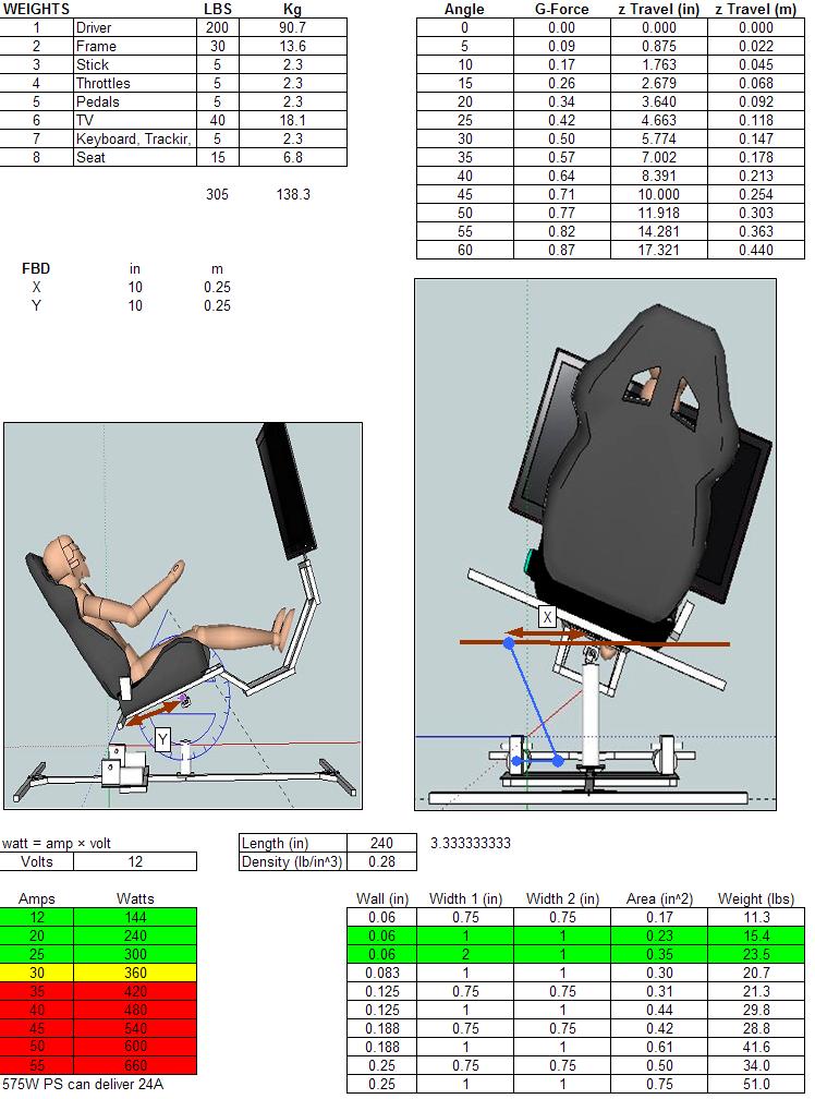

    More basic info. Nothing final in terms of the images shown, but some important data for estimating/calculating:
    • Movable Platform Weight
    • Frame Angle vs Resultant G-load Experienced - 60 deg would be nice, ehh? :D
    • Approximate Limits of JRK 12V12 in Amps & Watts.
    • Approximate Weight of Steel Tubing for Given Length & Cross Section. Emphasis on keeping weight minimized. I've gone with 2x1" and 1x1" @ 0.060" for the movable frame.

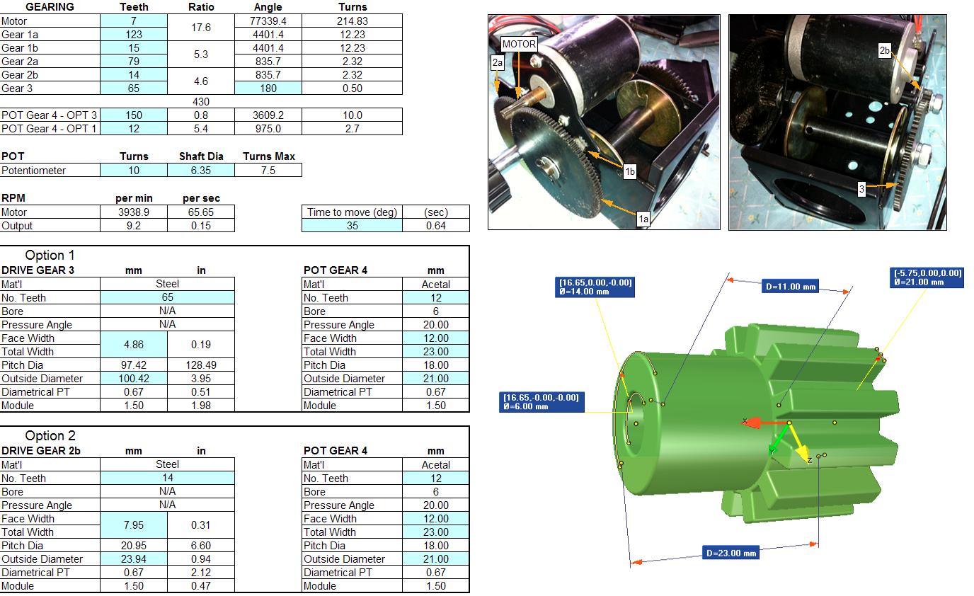

    Next, feedback for the motor controller. For this I'm going to try a 12 tooth, 1.5 Module gear driven from the 65 tooth output gear on the winch. This should give a max of 2.7 turns using a 10 turn pot. We'll see how this works. The very last gear in the winch drivetrain (gear #3/65 tooth) has the most torque so the parasitic loss from the gear and pot will be minimized. It would be possible to get more turns using a gear closer to the motor gear, and I may try that later on.

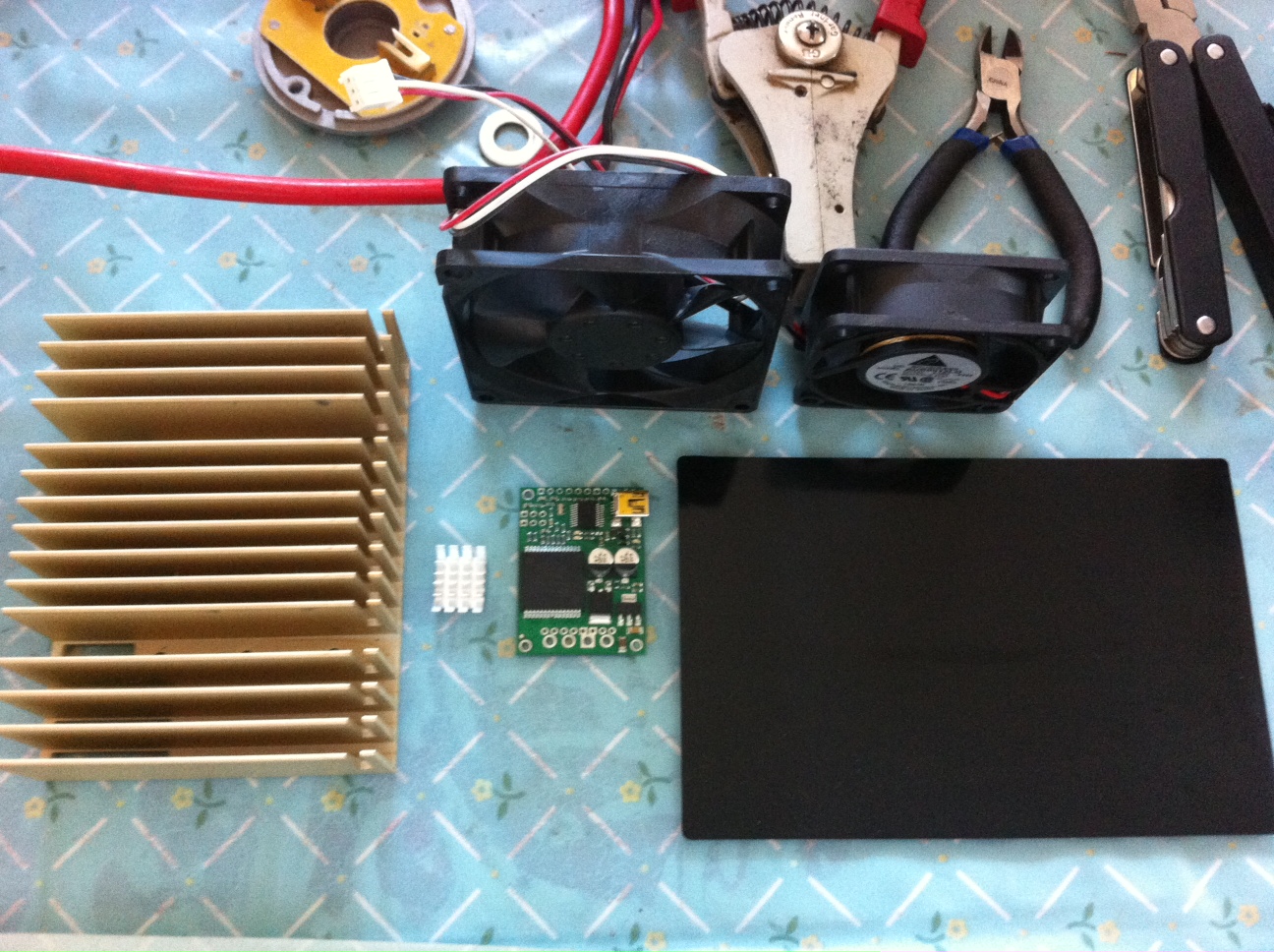

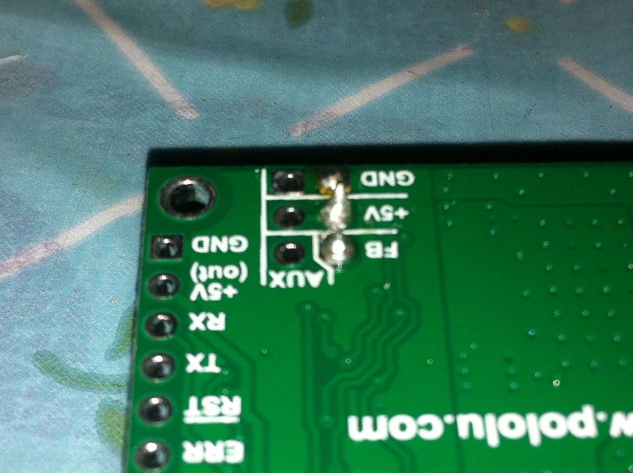

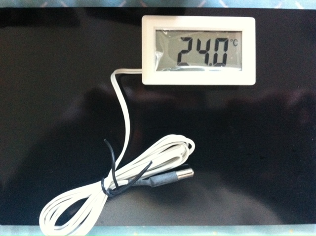

    For cooling the JRK's I'll use heat sinks and fans, with the boards mounted to a plastic substrate on standoffs to allow airflow to the back side of the board. I've got 60mm and 80mm fans to play with as well as small heat sinks courtesy of Historiker. An old Aluminum heatsink could also be cut up to try - A couple of cheap thermometers can be attached to the larger heat sink to monitor the board.

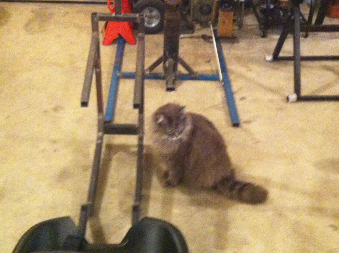

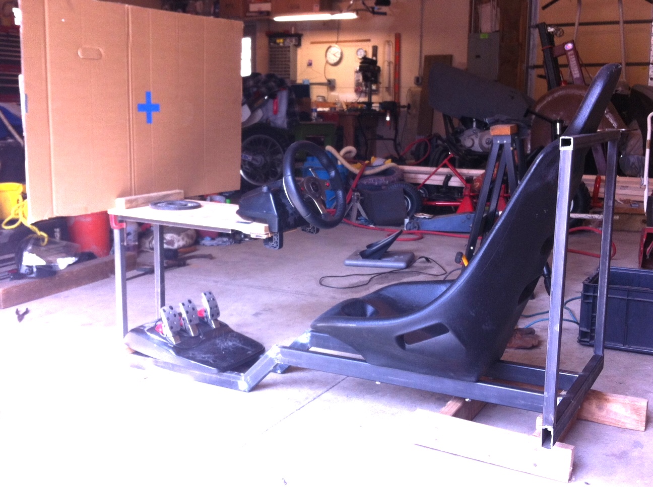

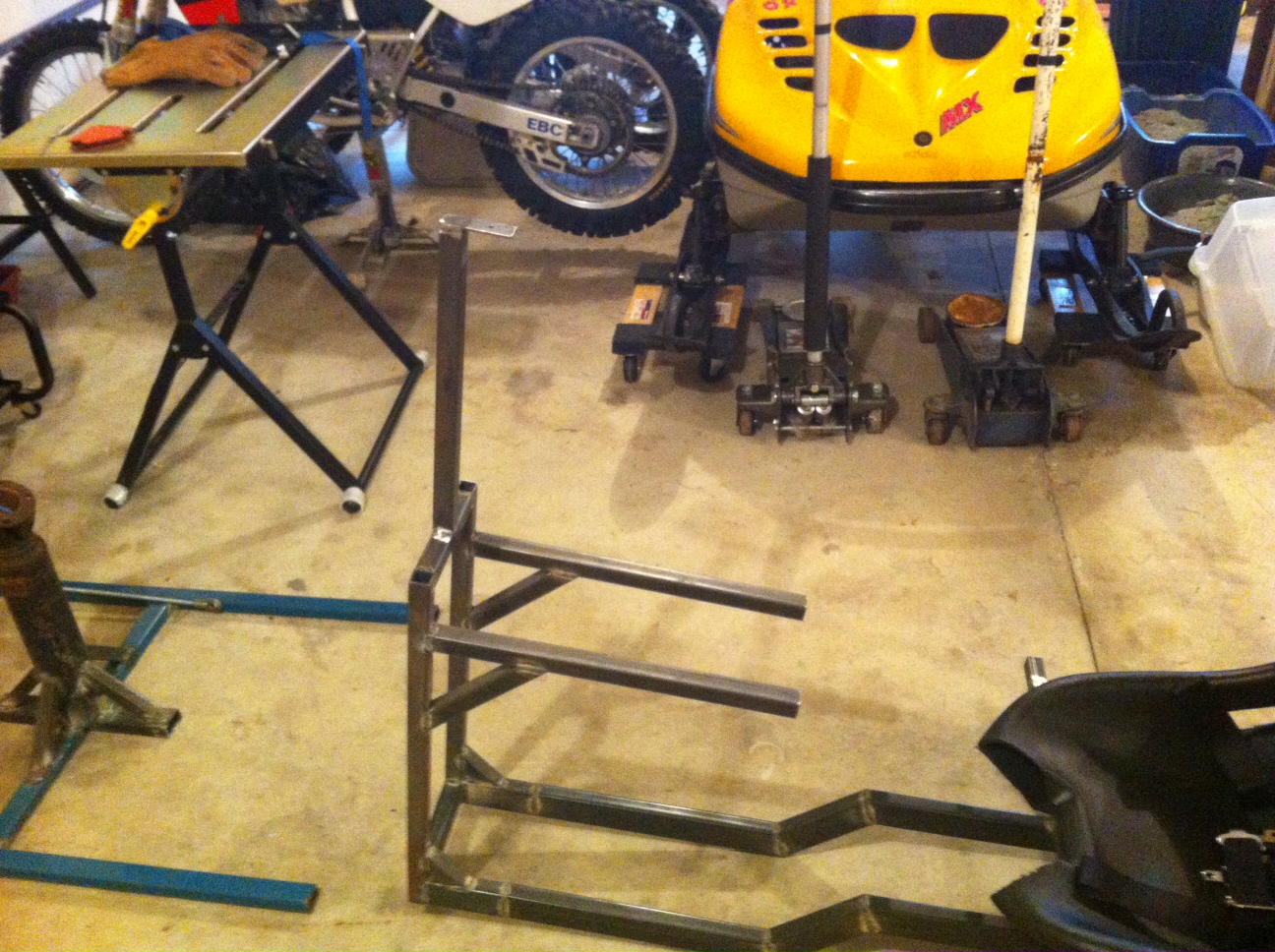

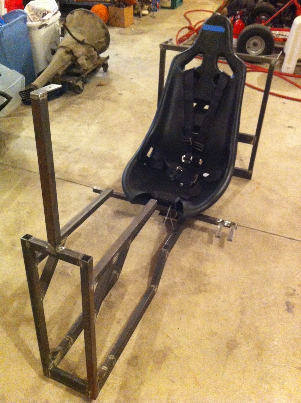

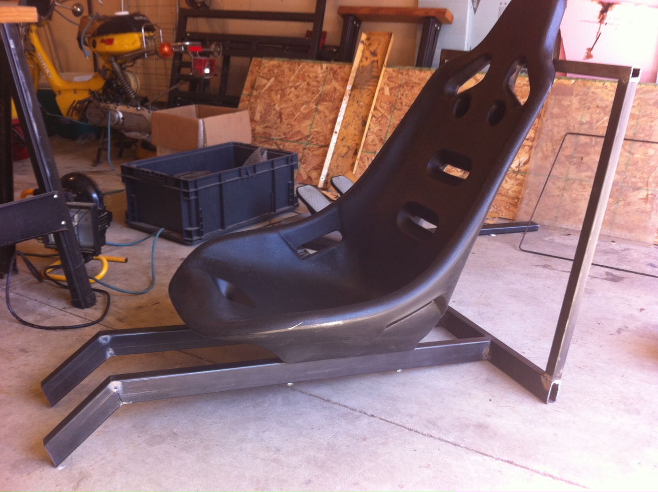

    A few pics of the frame progress made today
    More to come. I'll try to have an update once a week or so, and I'm positive I'll have plenty of questions as it gets closer to powering this contraption up and creating profiles. Many thanks to all involved on this board!! ;)

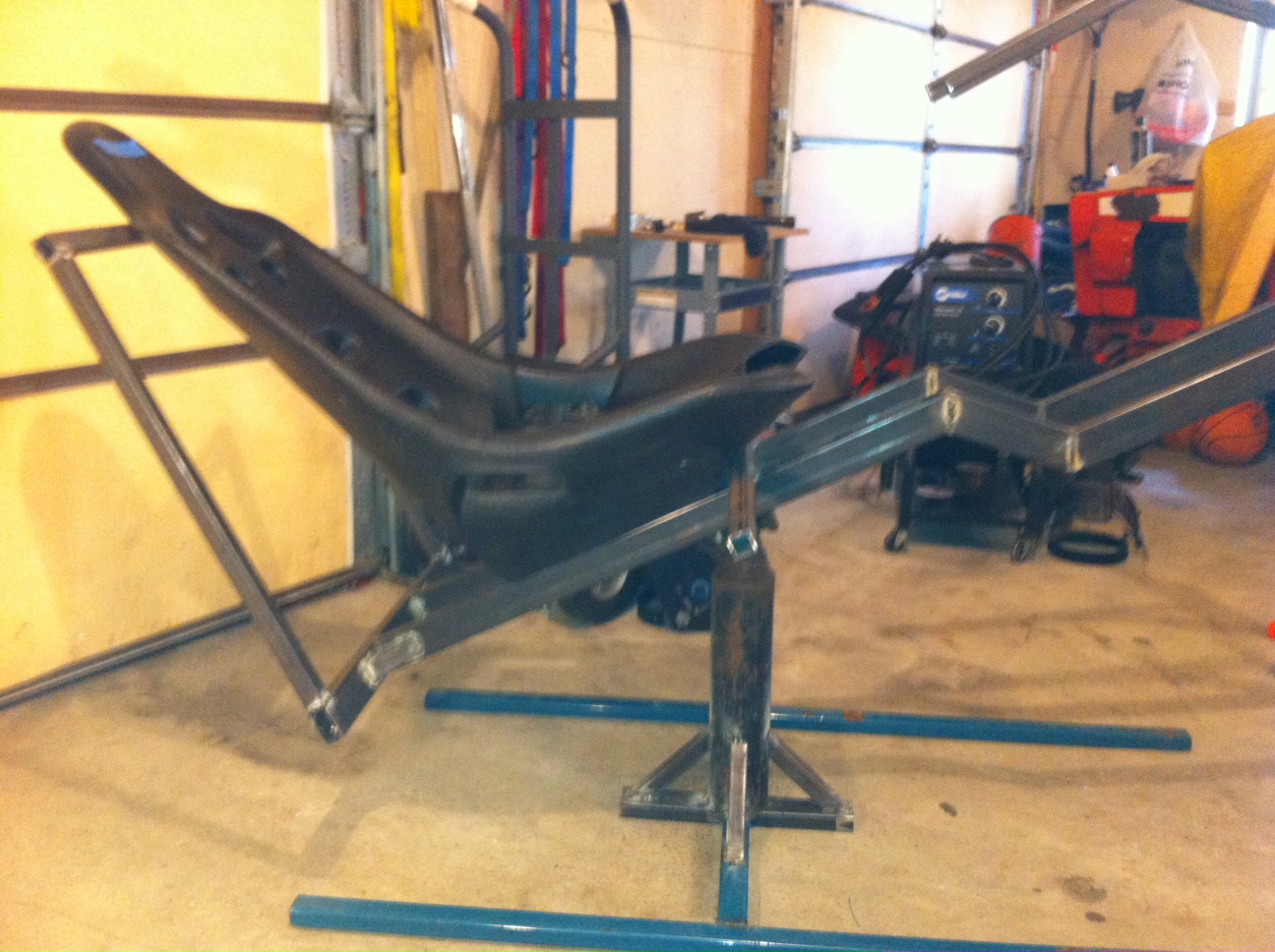

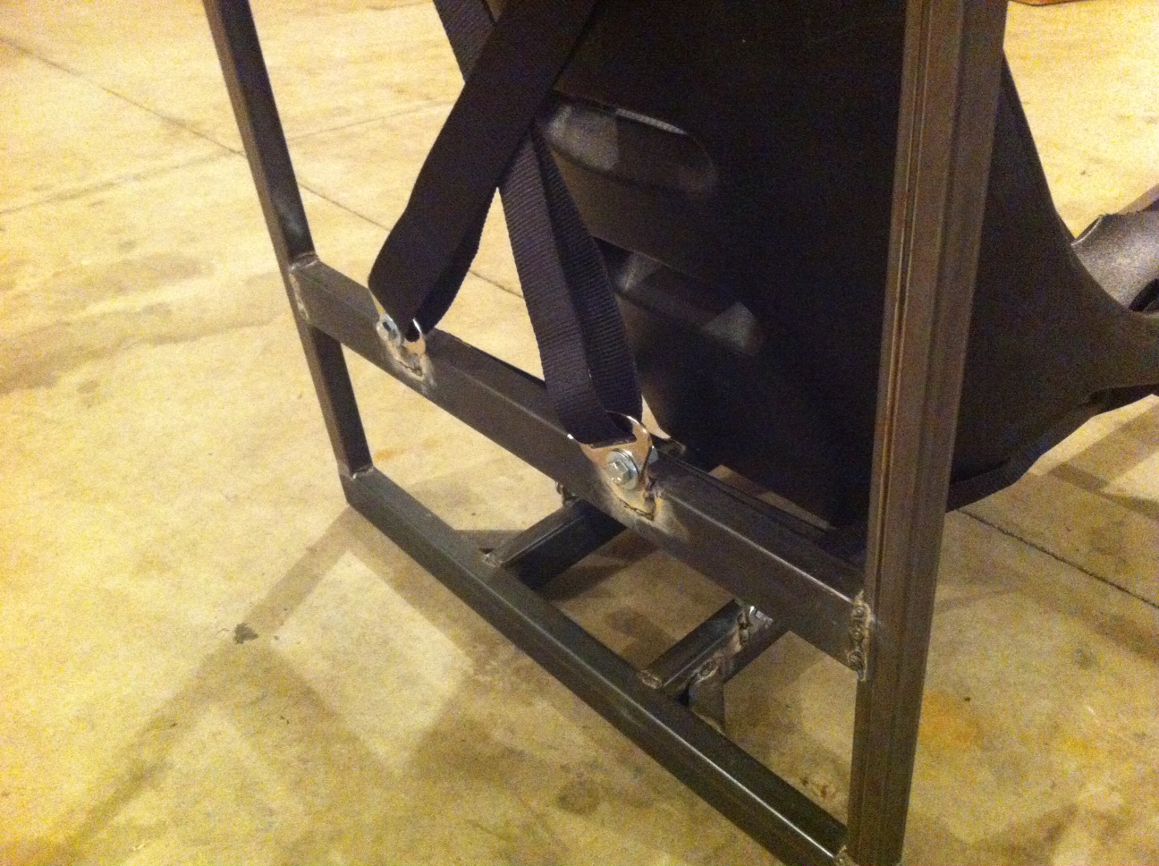

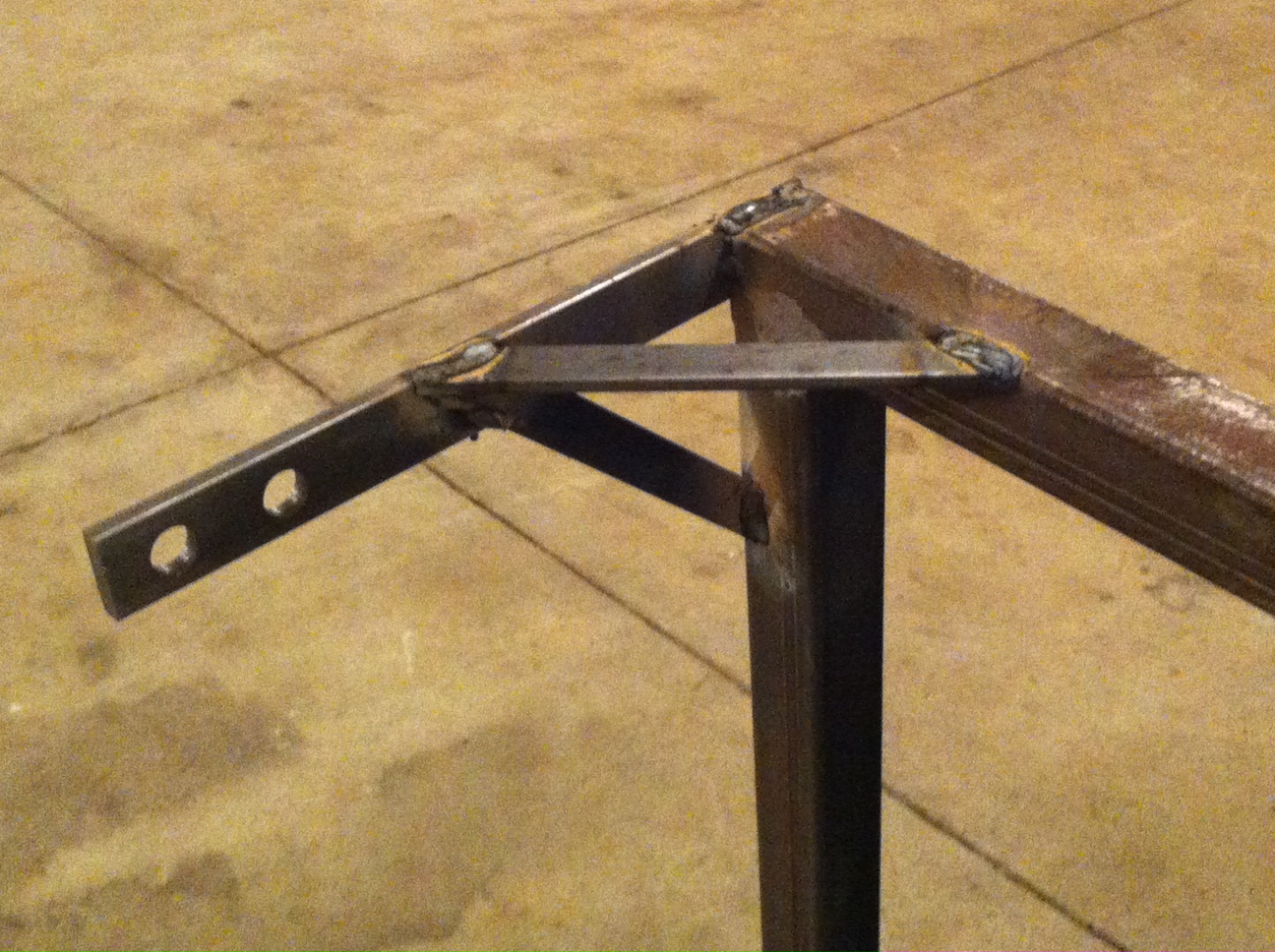

    A little bit more on the frame from today. Had it tacked together and back apart a few times to get it right (or at least close enough for me :D). Lengthened the frame 4.5" for a bit more pedal room.

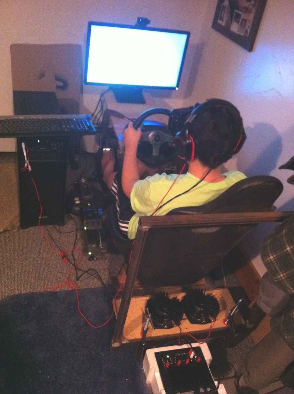

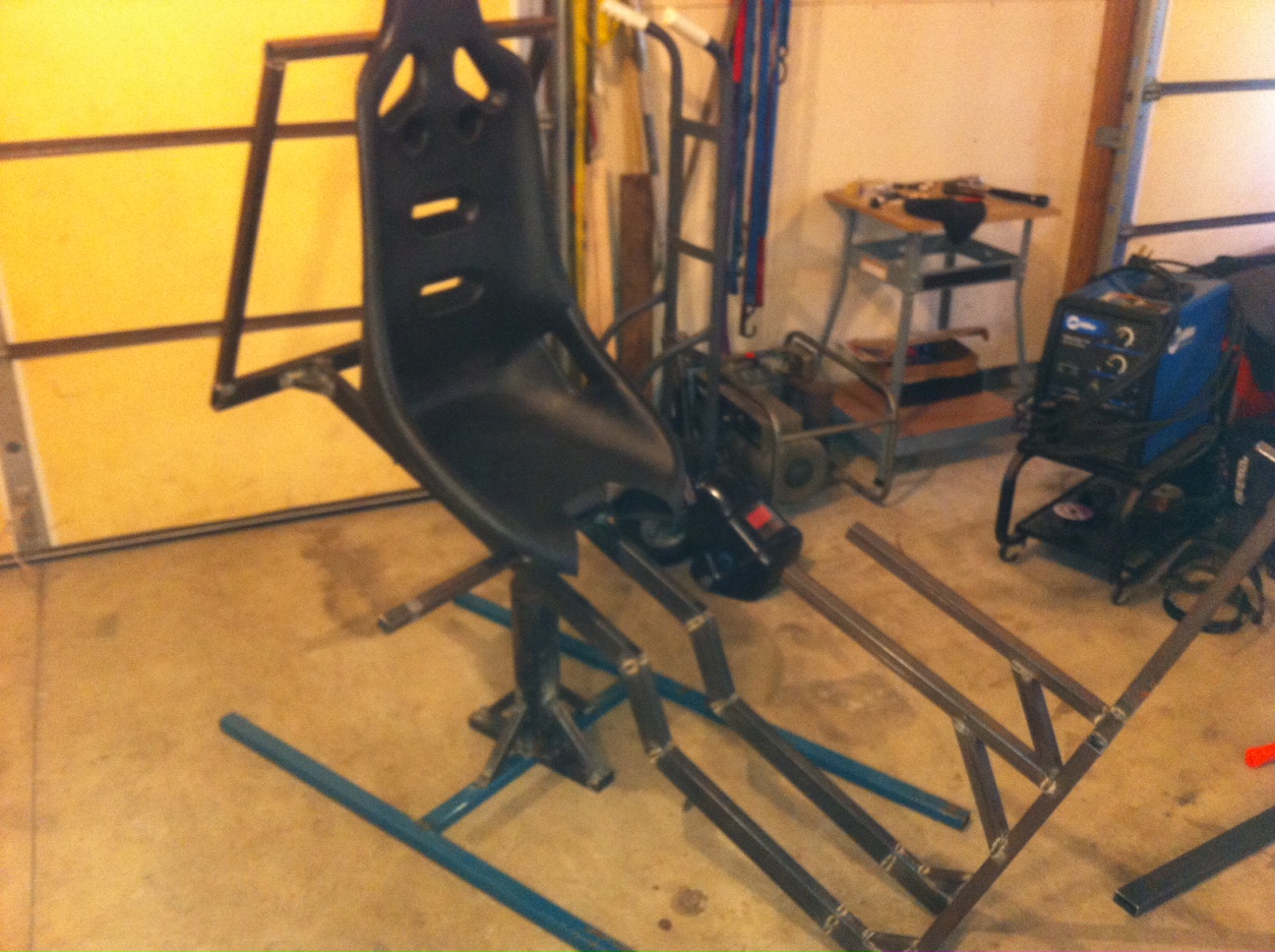

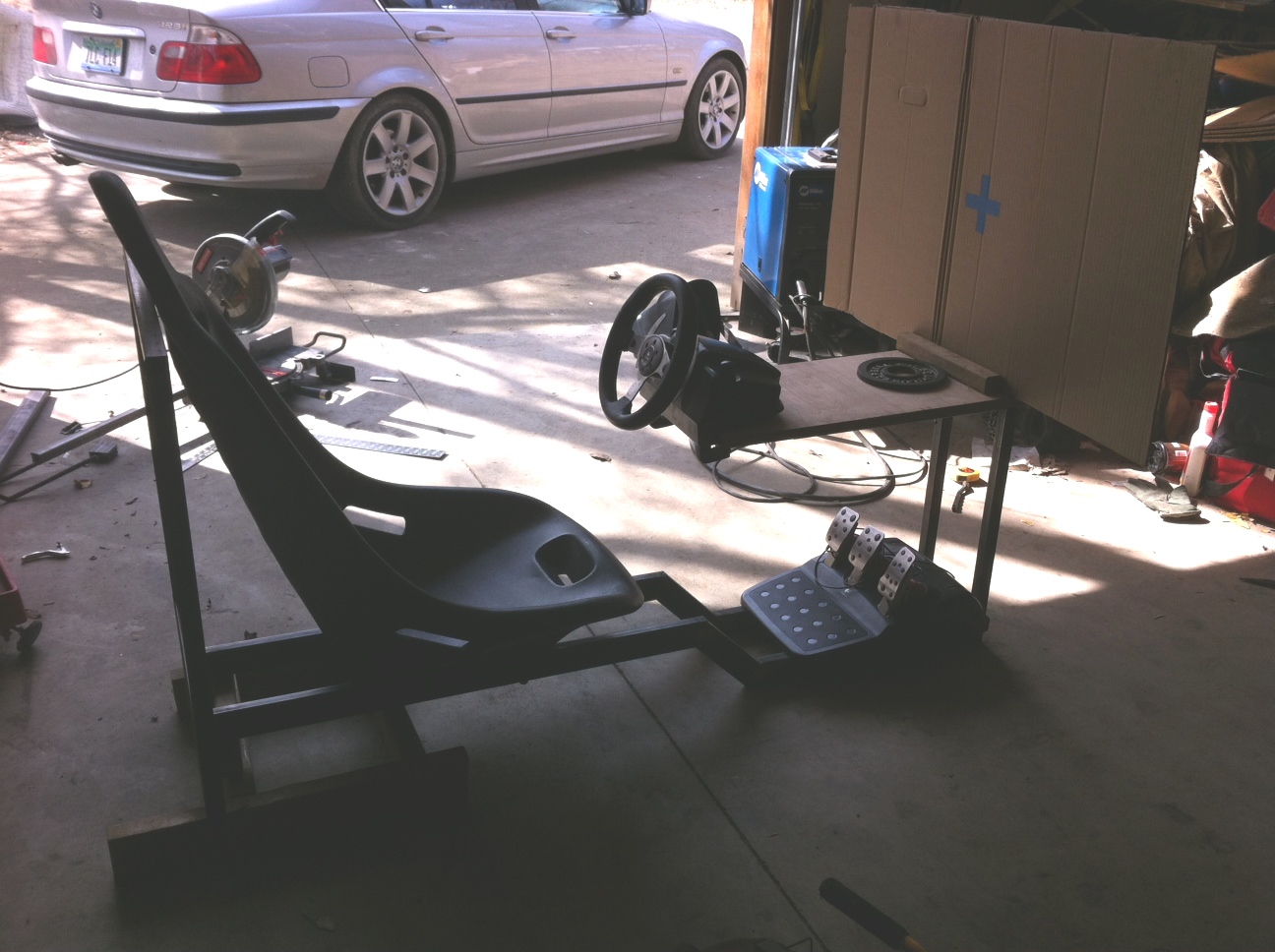

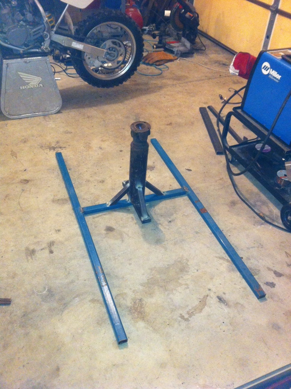

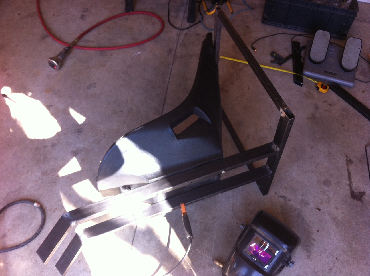

    Figured I would post a small update after a long delay on the project. Right now I have the upper frame set up as static and my son and I are having fun playing with Oculus DK2.
    2 bass shakers provide some nice vibration through the frame. Aura 50W shakers powered by a Dayton 100W subwoofer amp.

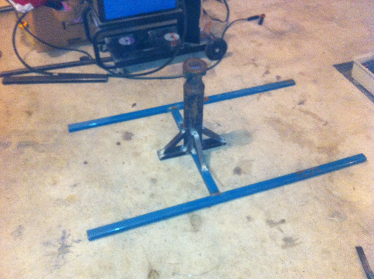

    Today I started the lower frame using an old driveshaft to provide a maximum of about ~33degress pitch/roll.
    Best regards

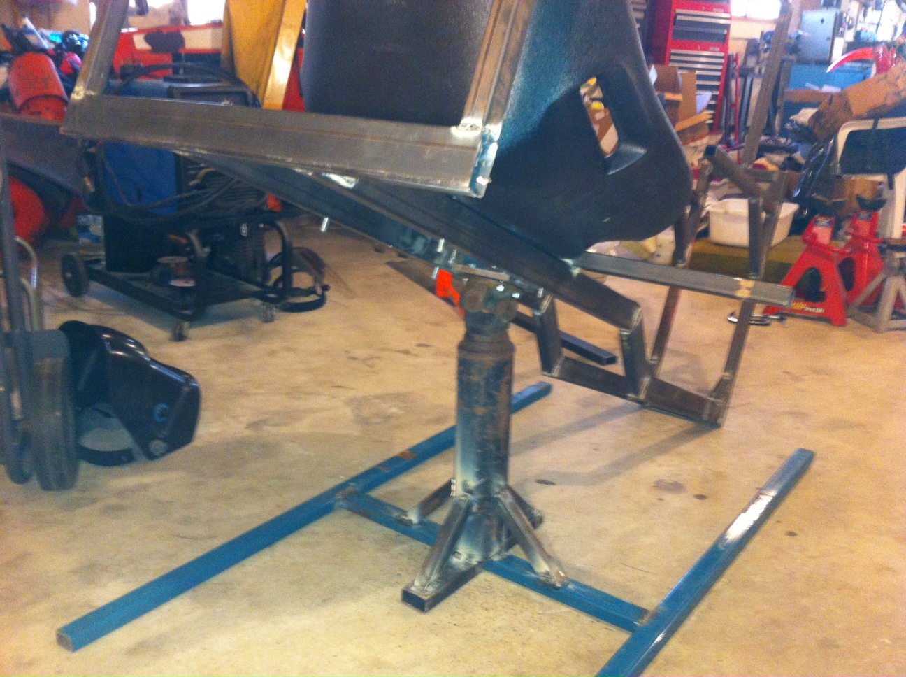

    Here's an update from today. Made a mounting plate for the top of the driveshaft and got the upper frame bolted on. The total movement looks pretty impressive, not sure if it will be realistic to use all that travel with a pair of winches.
    The craziest thing happened when welding one of the side supports to the driveshaft. All of a sudden I hear what sounds like an Estes rocket motor going off. I lifted the welding helmet and there was 8 or 10 inch orange flame shooting out from a pin hole in the weld - like a blowtourch :eek: I've never seen anything like that, I can only guess heat+paint burning+some O2 inside of the driveshaft tube and bang! Now that I think about it, this driveshaft uses a smaller tube inside of the outer tube, sealed with rubber to reduce vibrations. When I burned through the outer wall, there was either some rubber burning back in there, or a perfect rubber-sealed chamber between the inner and outer pipes for a lot of pressure to build. I will have to be careful when I finish welding that area o_O

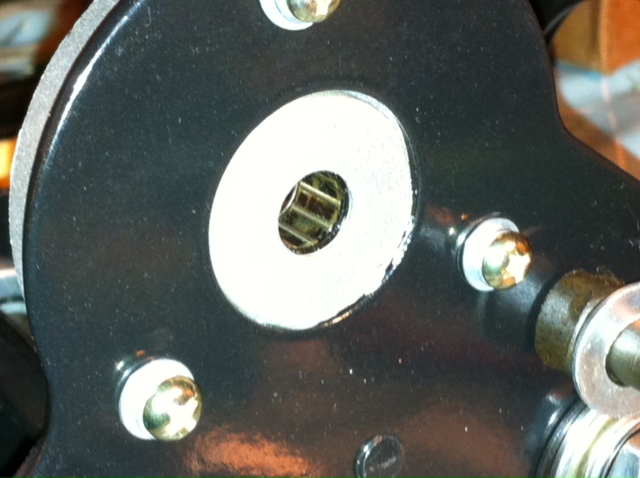

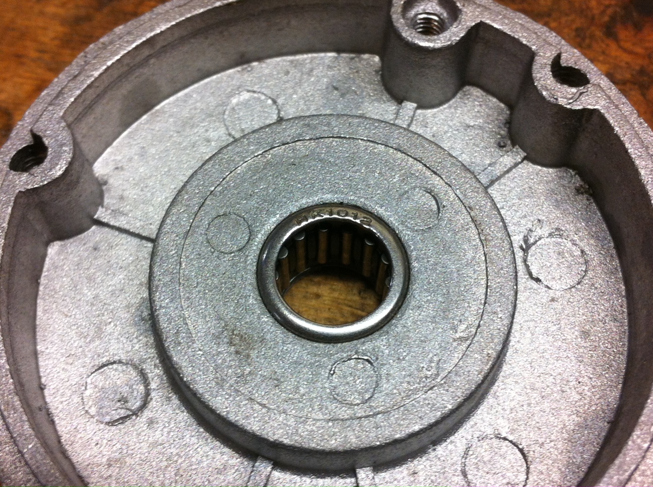

    Winch uses a one-way motor bearing (Boca HF1012) which needs to be replaced
    Bearing replaced with Boca HK1012 which rotates in both directions

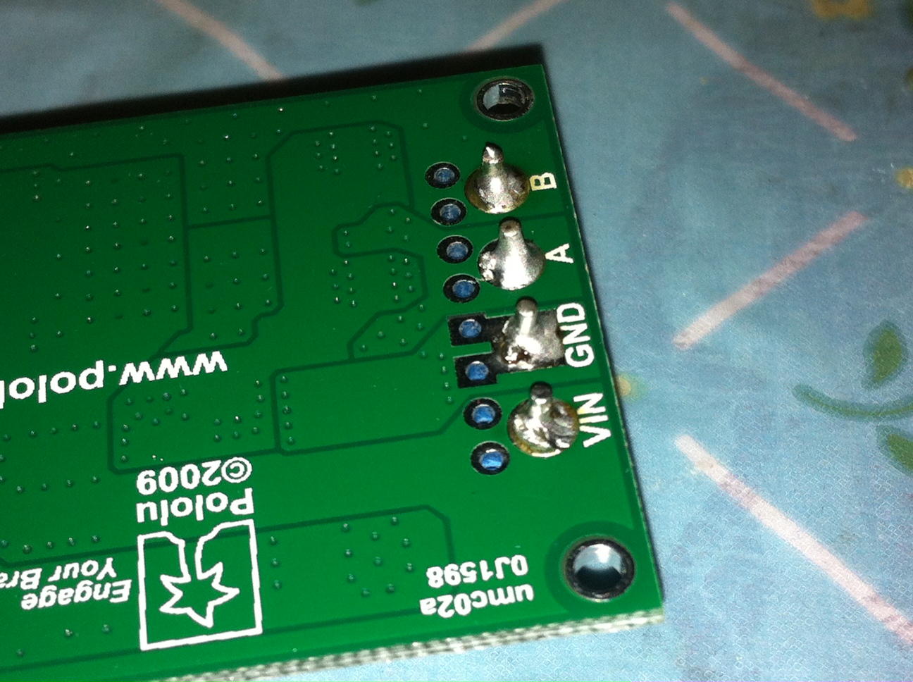

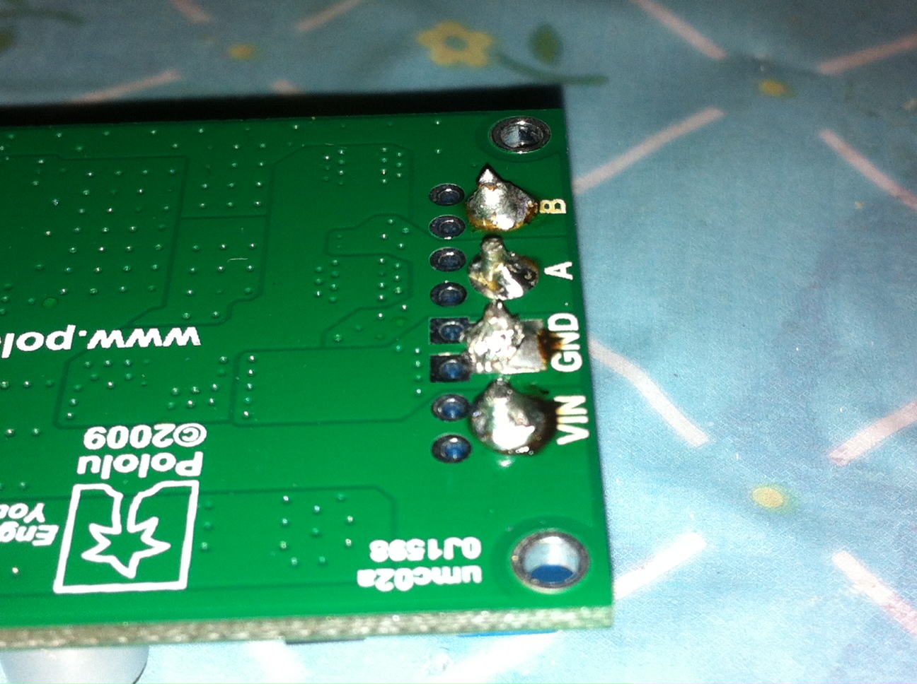

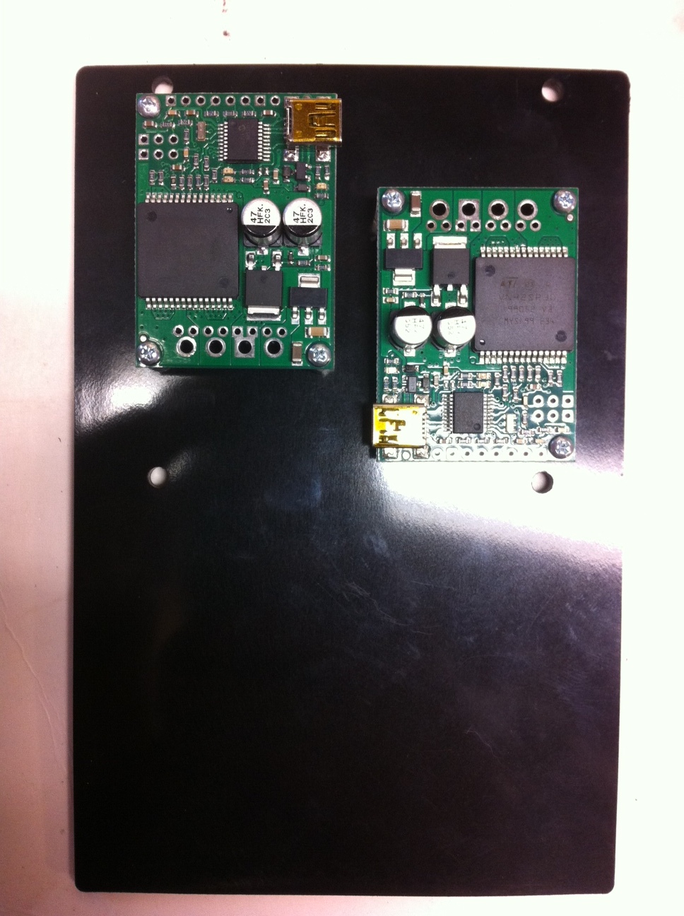

    JRK's soldered (not my day job :think)
    JRK mounting plate. One 80mm fan will sit above and heat sinks will be added

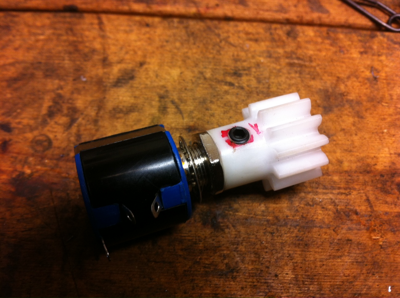

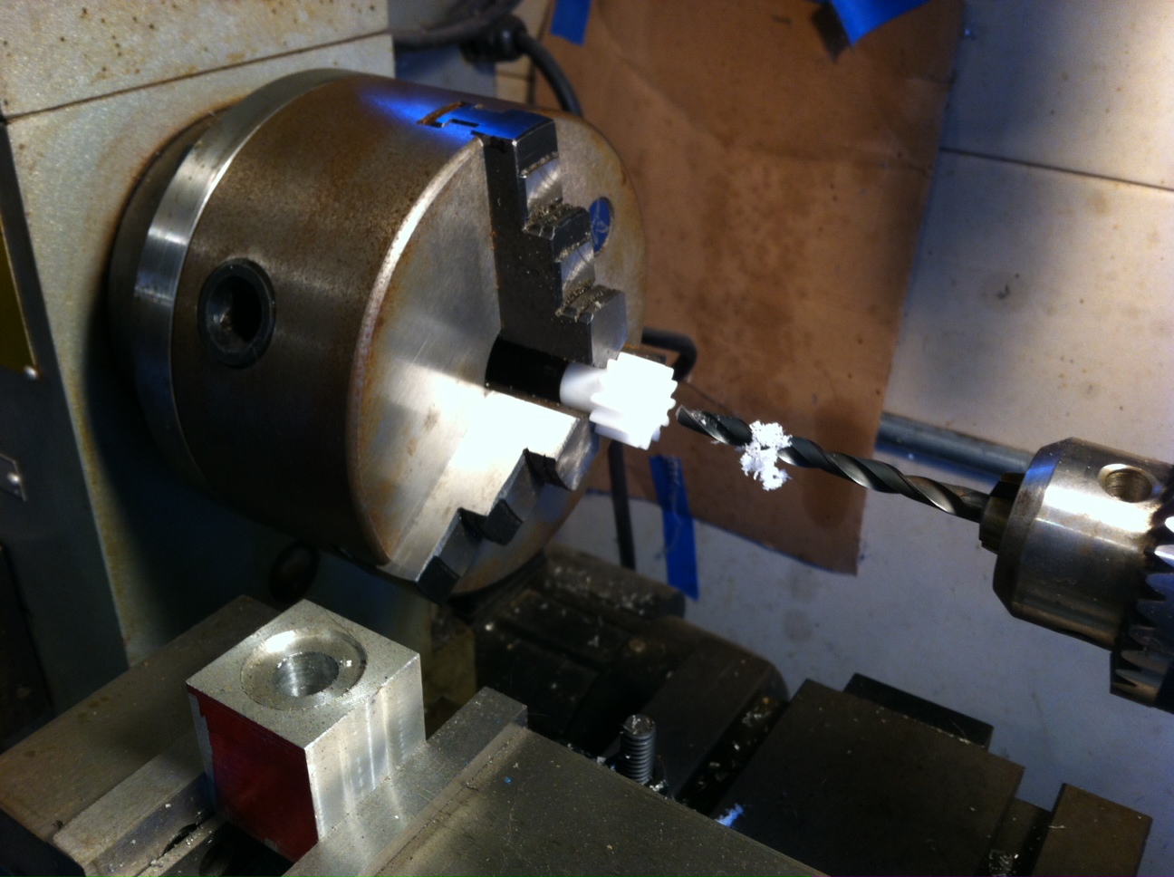

    Drilling out the POT gears to 1/4" and adding 10-32 set screw
  14. bsft
    soldering looks a tad rough, but as long as connections not touching each other its ok. Once everything is wired up, just triple check.
    Otherwise, looks good man,

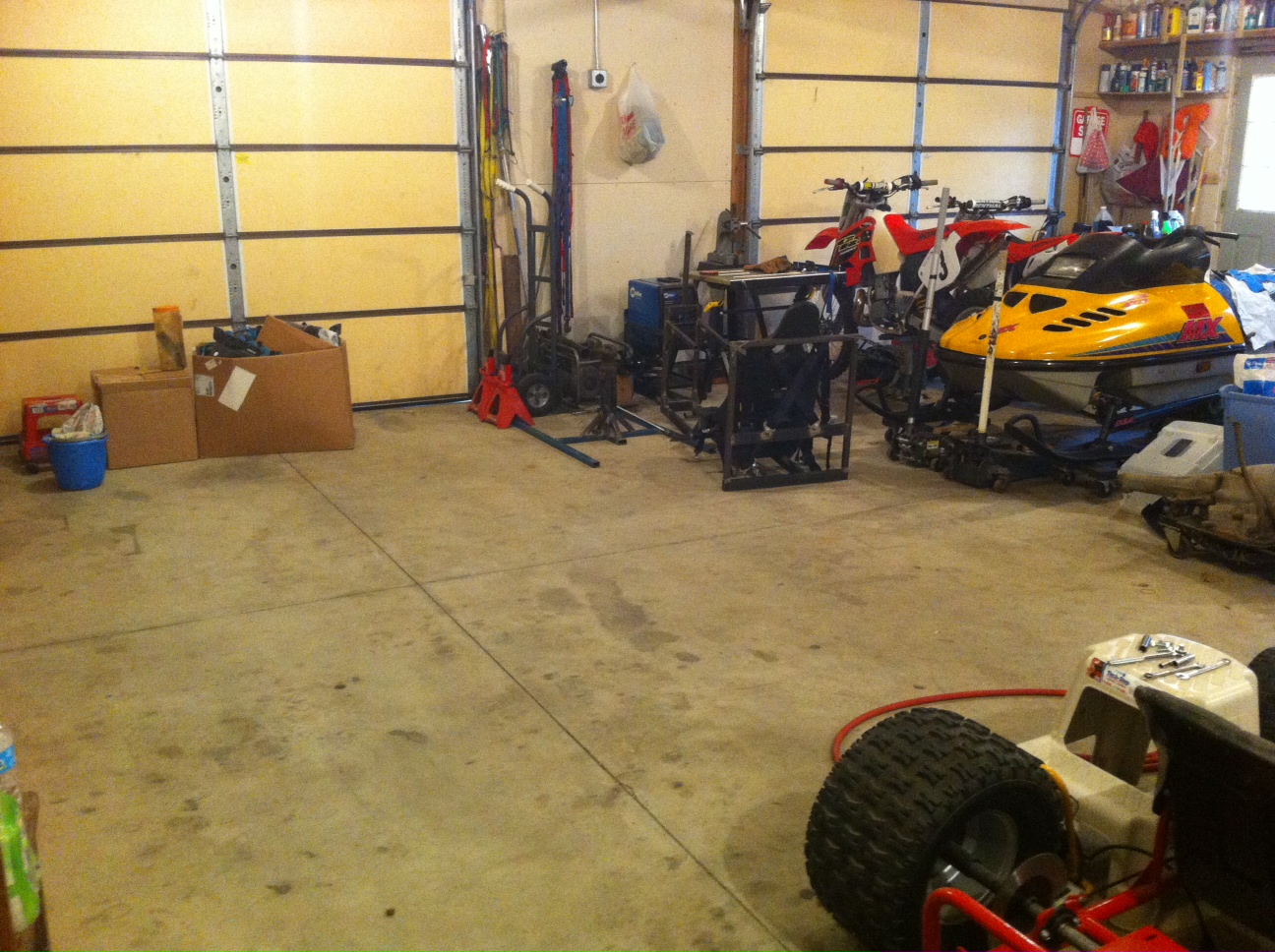

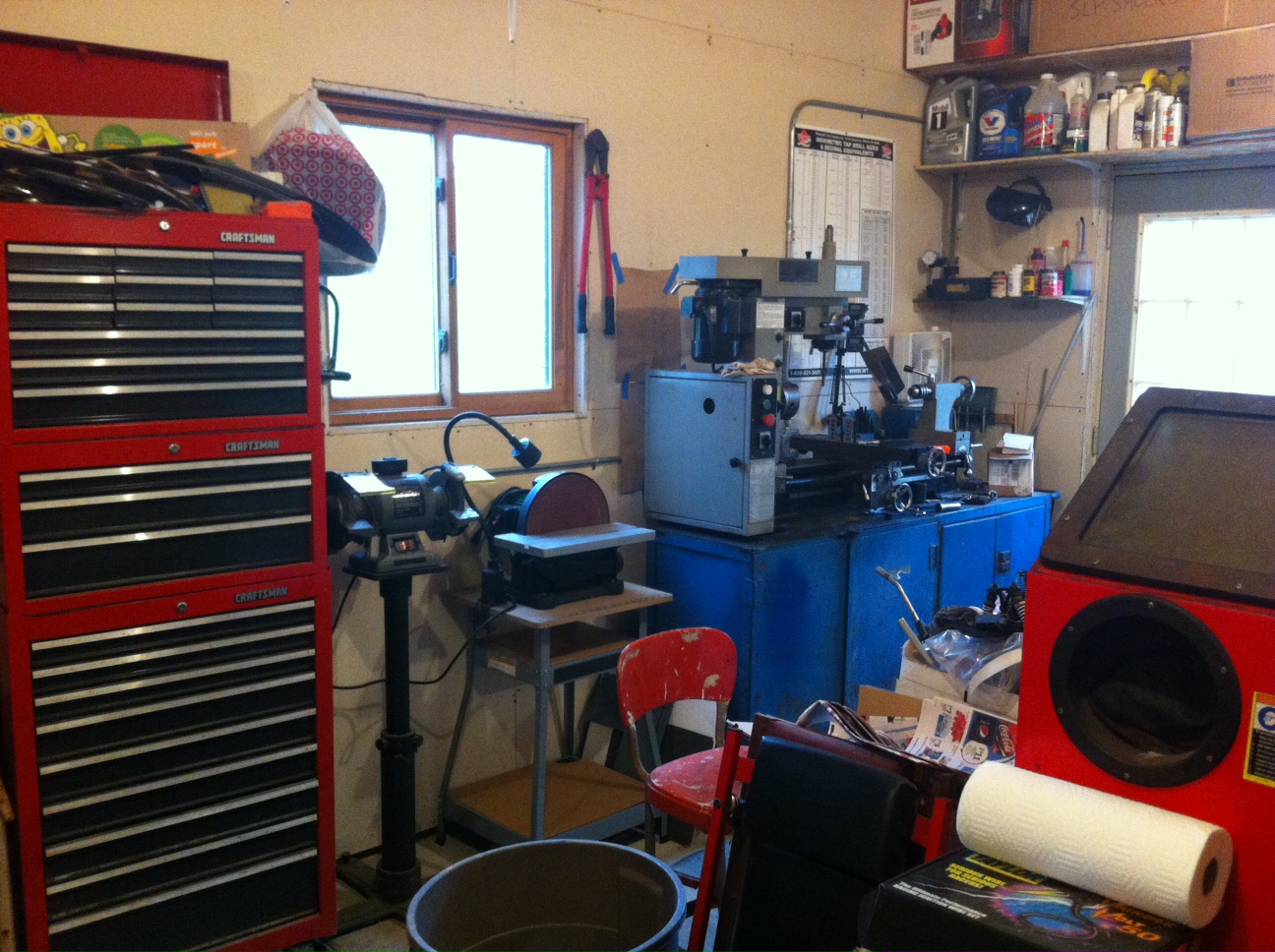

    First and foremost got the garage cleaned up a little so I can work :). Added a picture of some of the equipment. I bought a little horizontal bandsaw from Harbor Freight which has been working really well. I've been using that more regularly than the chop saw at the moment

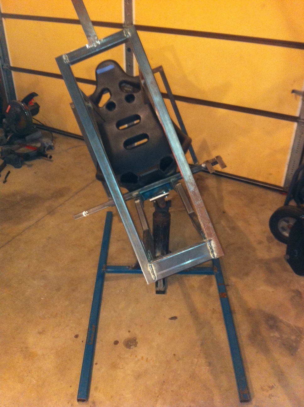

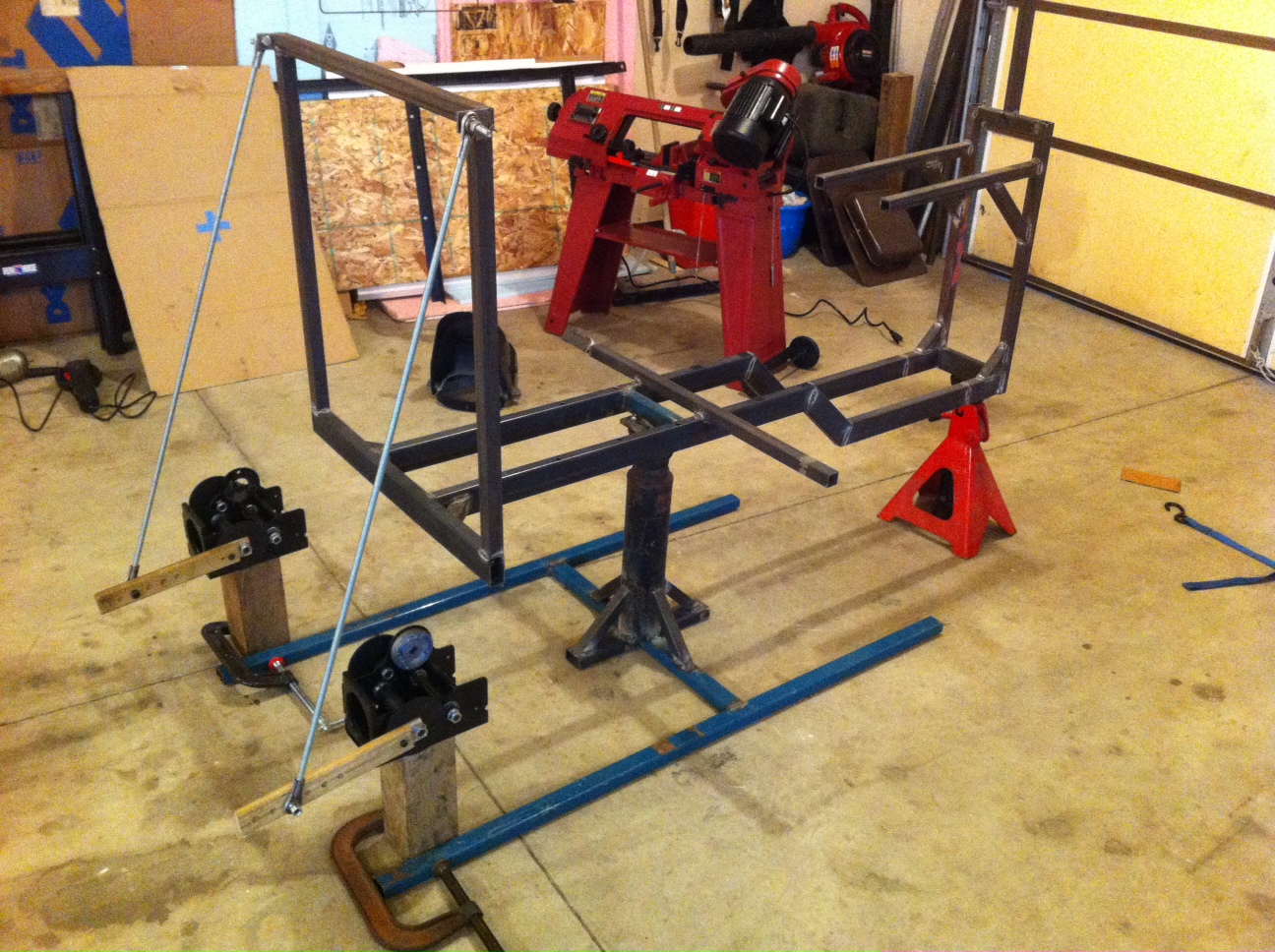

    Here's a pic testing the initial geometry. This gave me a little confidence that the thing could actually move :D There you can see that bandsaw. I think it was about $200 on sale.

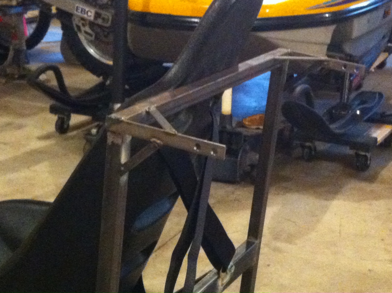

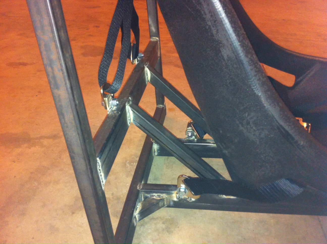

    Some additional frame work, mounting for the Oculus camera, and seatbelt.

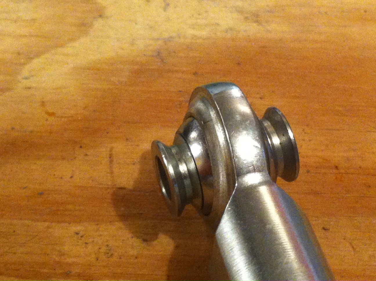

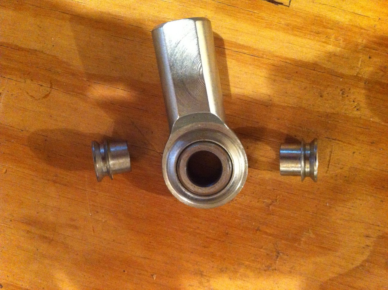

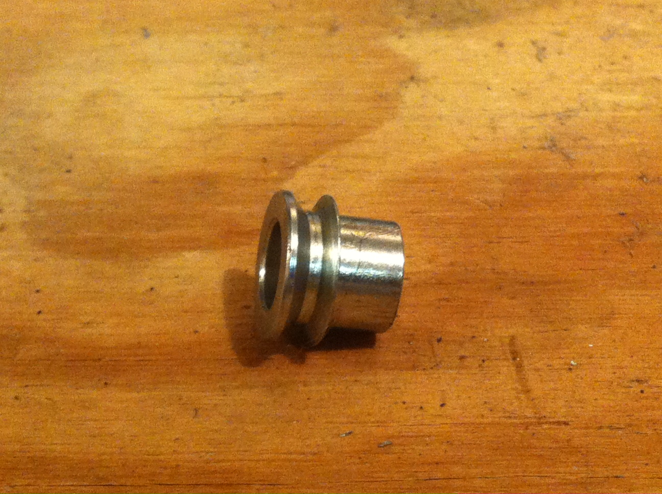

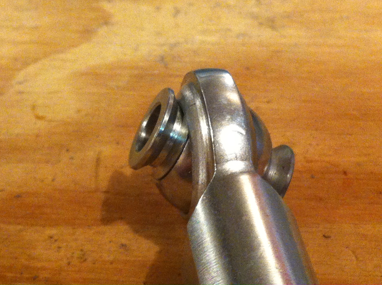

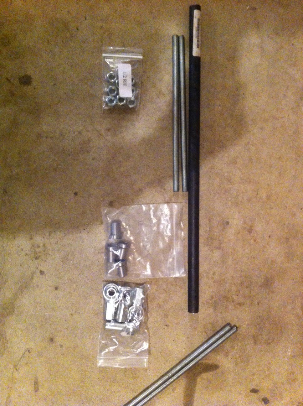

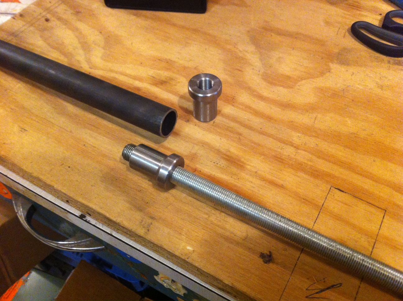

    Components for the connecting rods. ½”-20 threaded rod and rod ends using ¾” tubing. This should give plenty of adjustability for testing of the the arm length, shorter and longer. The High Misalignment Spacers are neat and allow about 29 degrees of rotation without bind.

    I would strongly recommend you re-flow the solder joint on "A" in the picture jrk-solder-1. It looks like it's only got about 60% coverage. If you can get some from any local electronics stores, get some liquid flux. dab a drop of it over the joint and put your soldering iron on it for about 2 seconds and it will cleanly re flow the solder and end up with a pro looking finish. It almost looks like your soldering iron is too cold on those joints, if you iron has temperature control make sure it is sitting at 350 degrees C or 662 degrees F. It's either too cold or the tip of the iron is too small to conduct the required heat.
    Some nice toys you have to play with, I barely see linishers in peoples sheds these days.

    You only need a tiny drop of the flux per solder joint, so I would suggest using something like an eye drop bottle.
    Flux itself is also quite messy and sticky so you will also need something like isopropyl alcohol + small hard bristle brush to clean the board after you are finished.
    By the end of it all you'll end up with a full soldering station kit :) .

    Another piece of advice:
    Use Kimwipes when removing the excess flux, ie. place Kimwipe on board then brush on isopropyl, which flows the flux from the board onto the Kimwipe.
    Don't use paper towels. If you don't have a Kimwipe, use coffee filters (the type you would use with a 4 or 10 cup automatic drip coffee maker).
    That said, Kimwipes are probably cheeper, and useful any time something requires a "lent free cloth". When removing flux, they are a god send.
    If flux gets too "icky" to remove with isopropyl and Kimwipe, you can use acetone / Kimwipe, but *be gentle*... Some china boards's solder mask aren't as resilient as higher quality boards.
