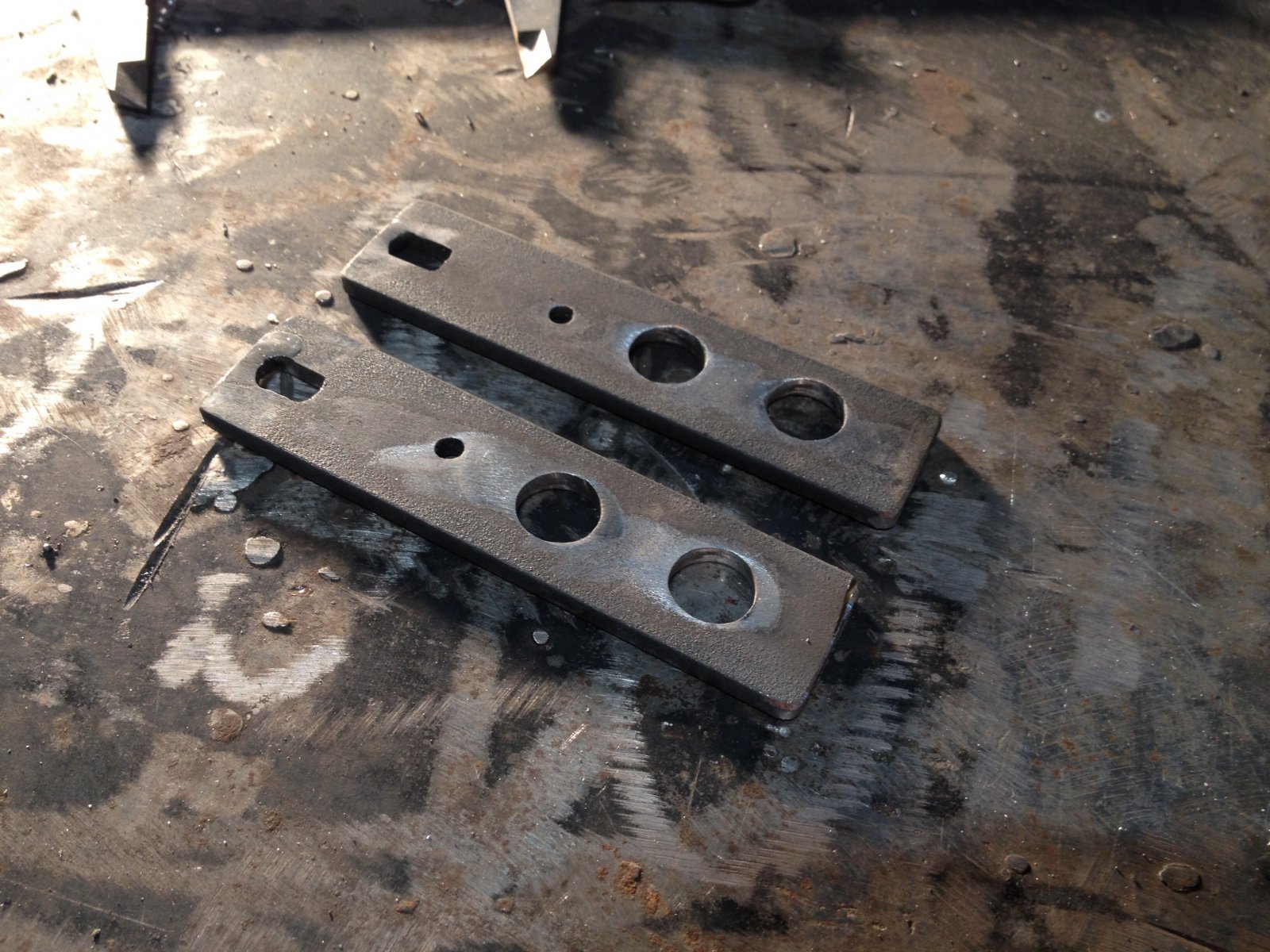

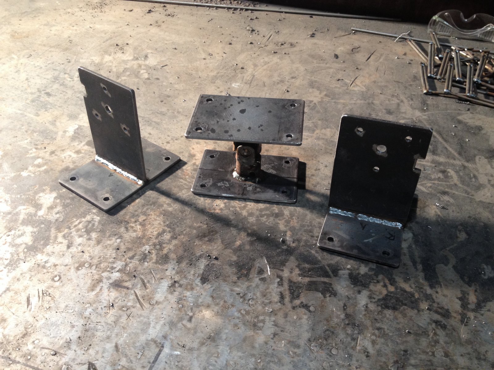

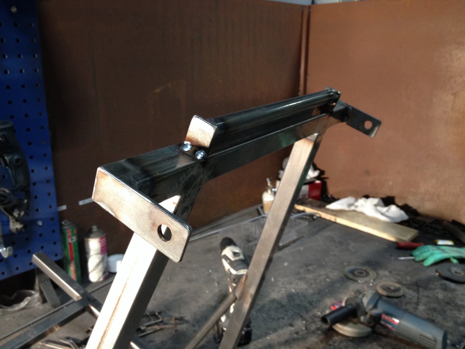

    Ok, finally started to weld metal parts yesterday. Now pivot, motor mounts, and part of the frame is ready!
    I also finished a simple software that measures temperatures from four temp sensors and displays temps on lcd. Going to add two current sensors and safety limits, when something goes out of bounds, alarm goes on.

    Nicely welded! congrats!
    Your motor supports look strong but maybe a reinforcement (triangulation) could be necessary to keep it straight under load?

    Thanks, Mat! Steel is 5mm thick, they are quite strong. But I'll reinforce them if necessary.

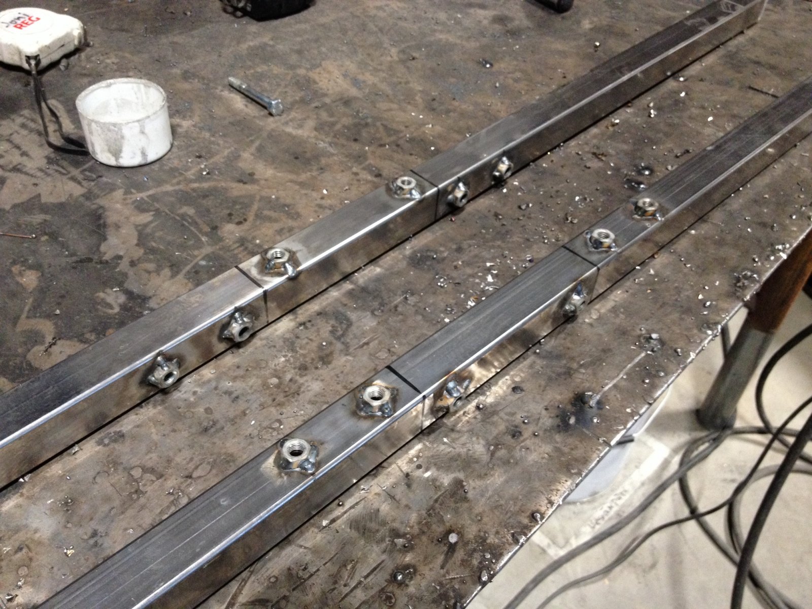

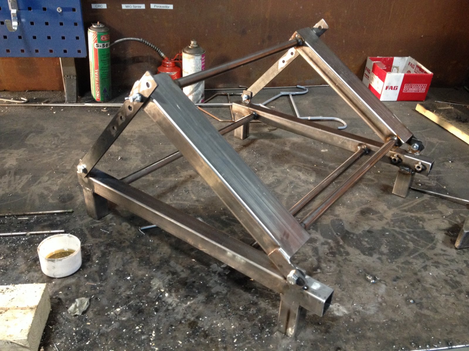

    Some progress
    Upper images are adjustment points of baseframe, it will be cut where the black lines are, then pedal and steeringwheel frames are movable over 25x25 pipe. But it is easier to build with everything still being one frame.

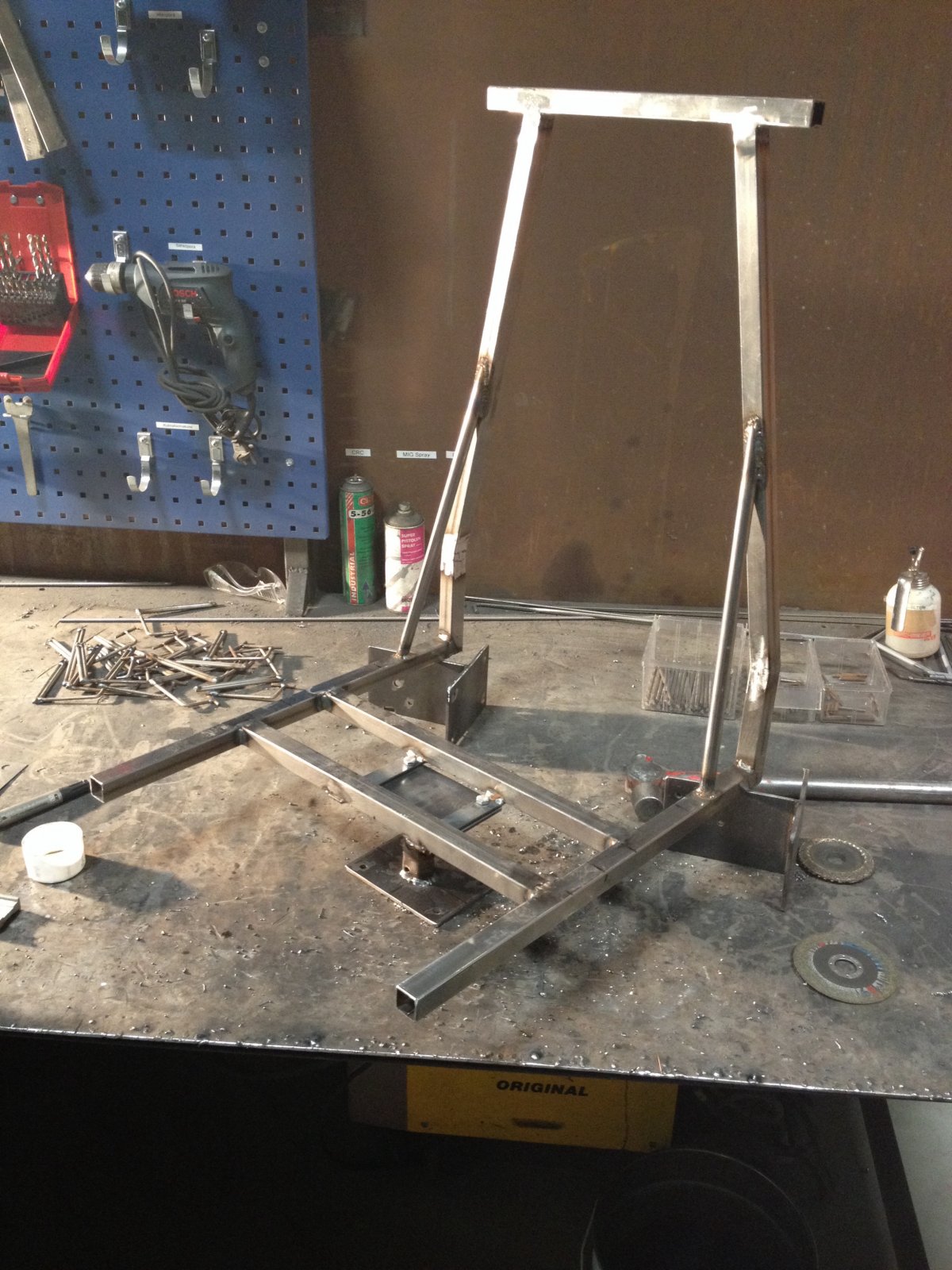

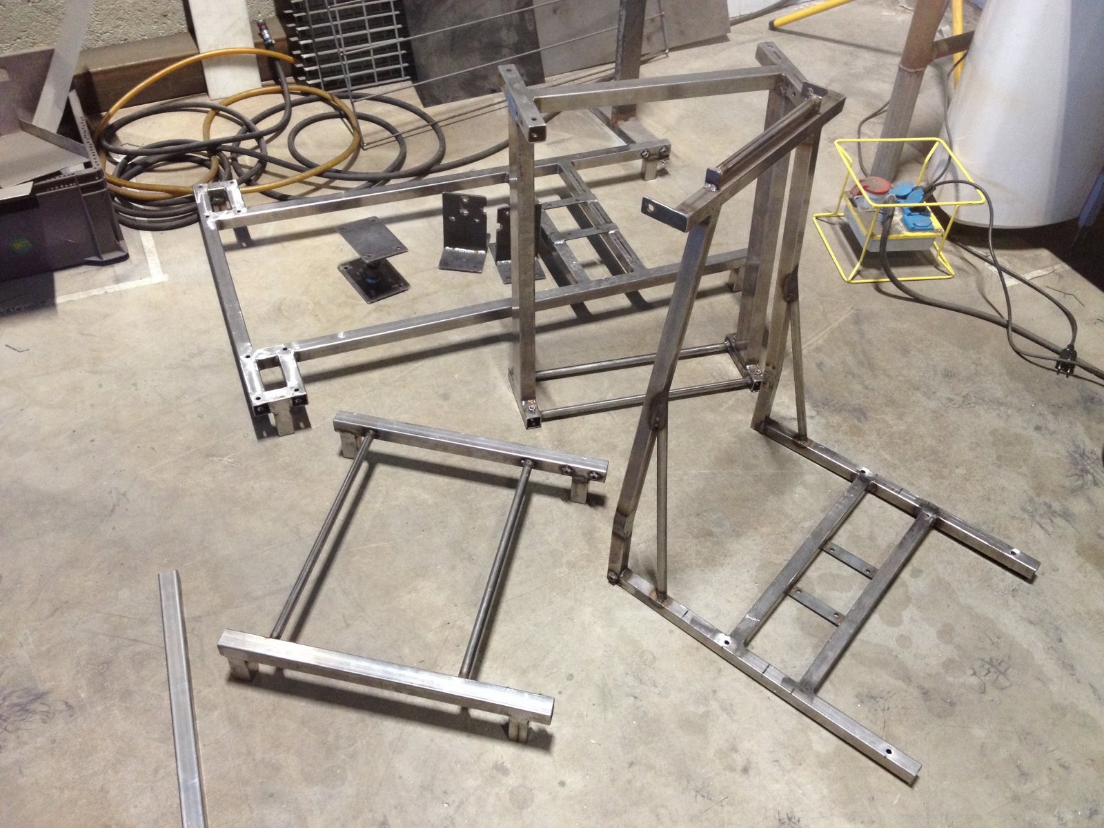

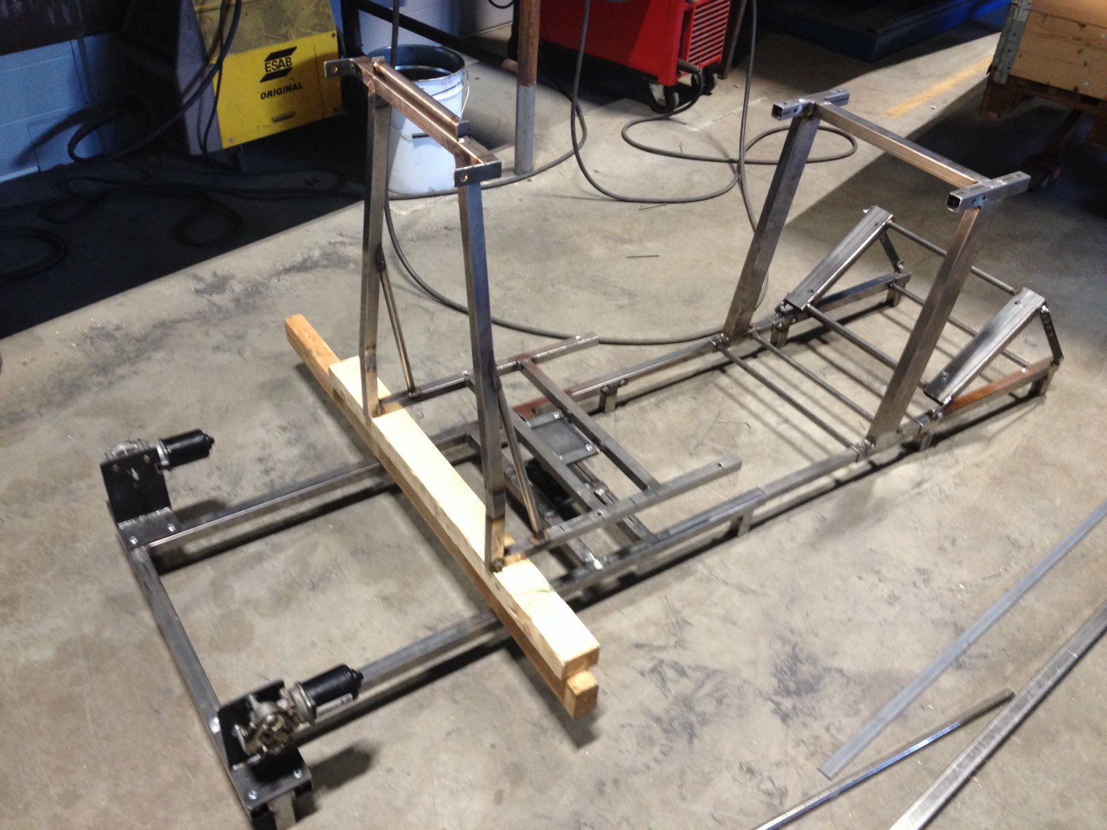

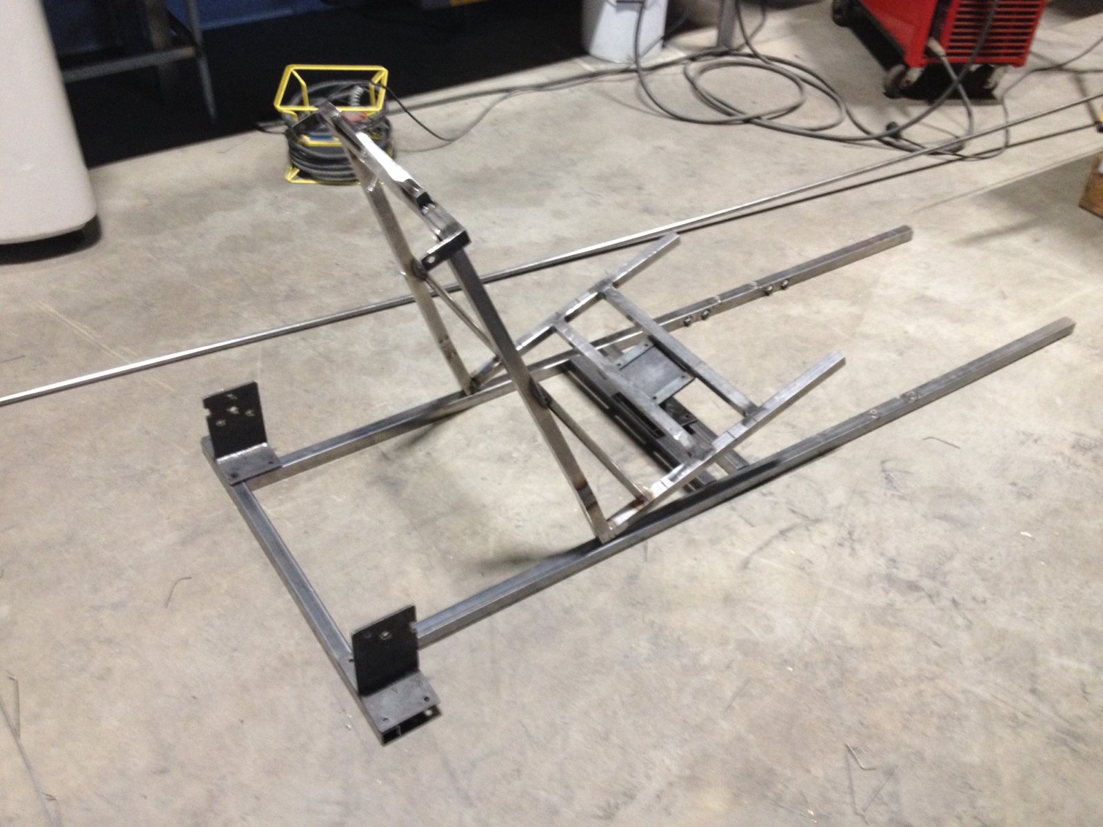

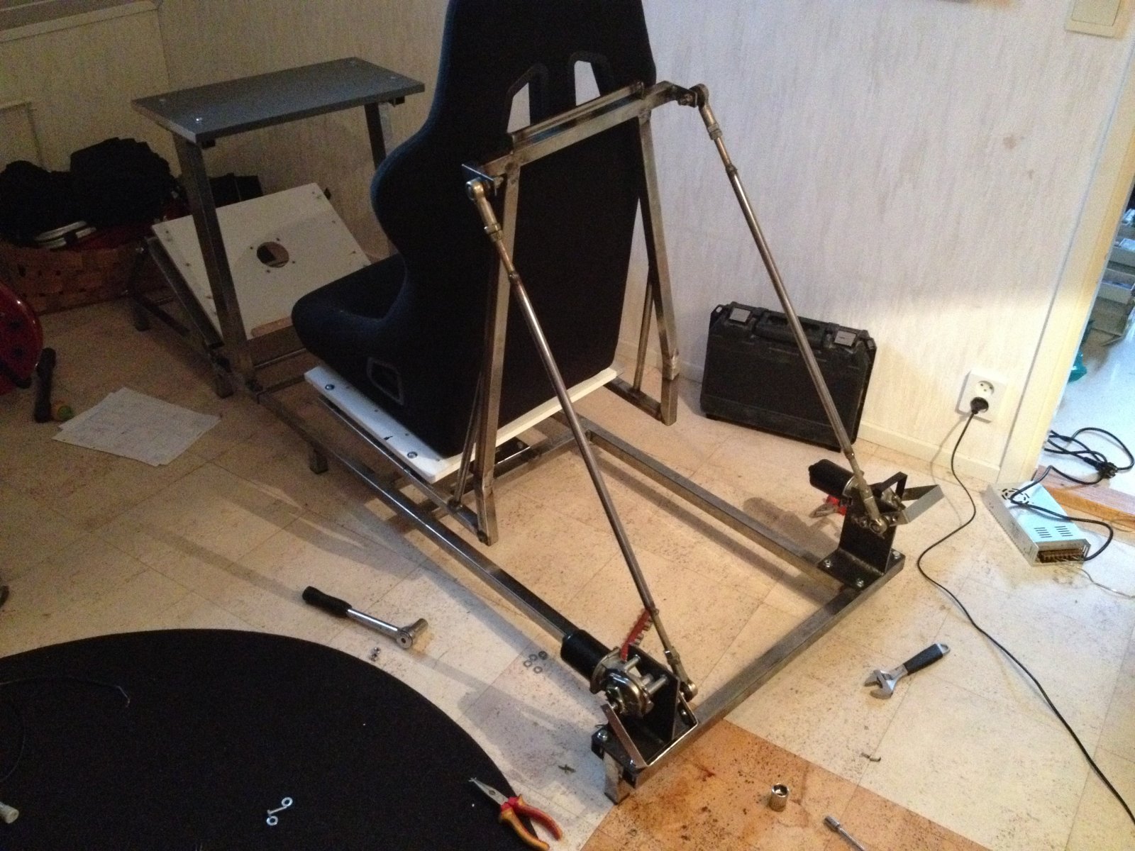

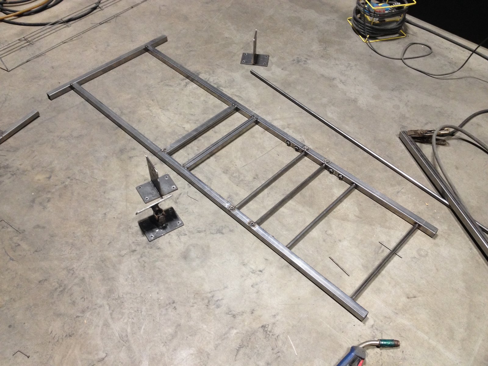

    Spent 11 hours straight from 3: 00 am, (when you have time, you must use it :D) and got the frame as ready as it needs to be for testing.
    All the parts of the frame
    Finished pedal stand
    frameparts (30x30 pipe) connected with 20x20 pipe for pedal and steeringwheel distance adjustability

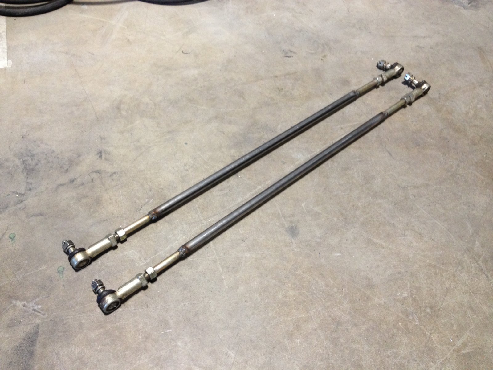

    Used steeringrodsfrom my ATV continued with 16mm pipe

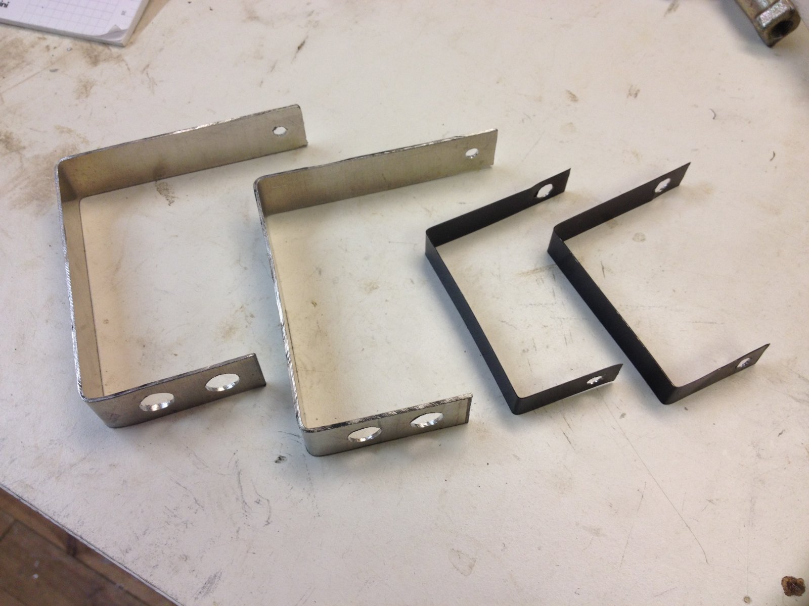

    Levers for motors
  14. eaorobbie

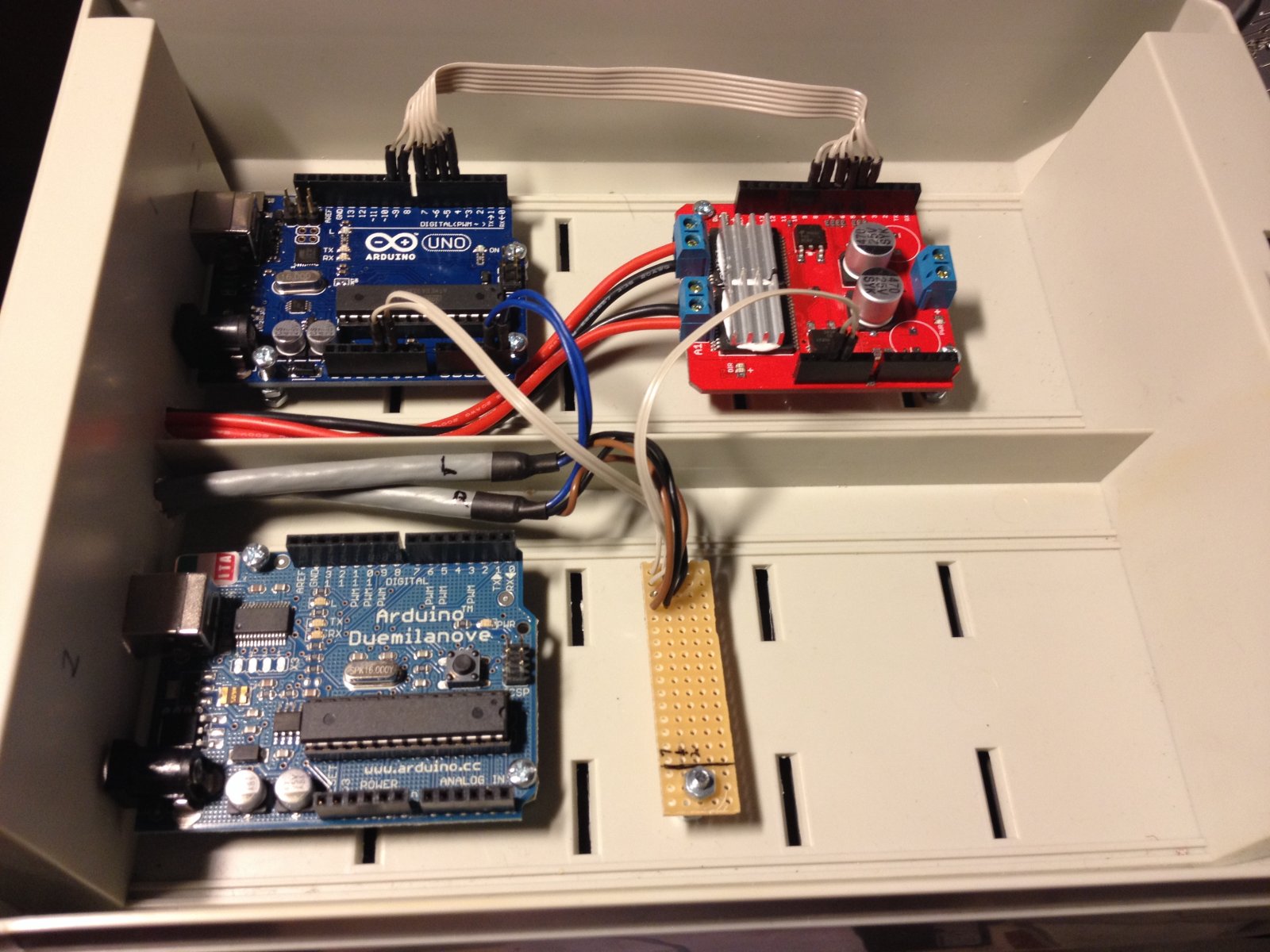

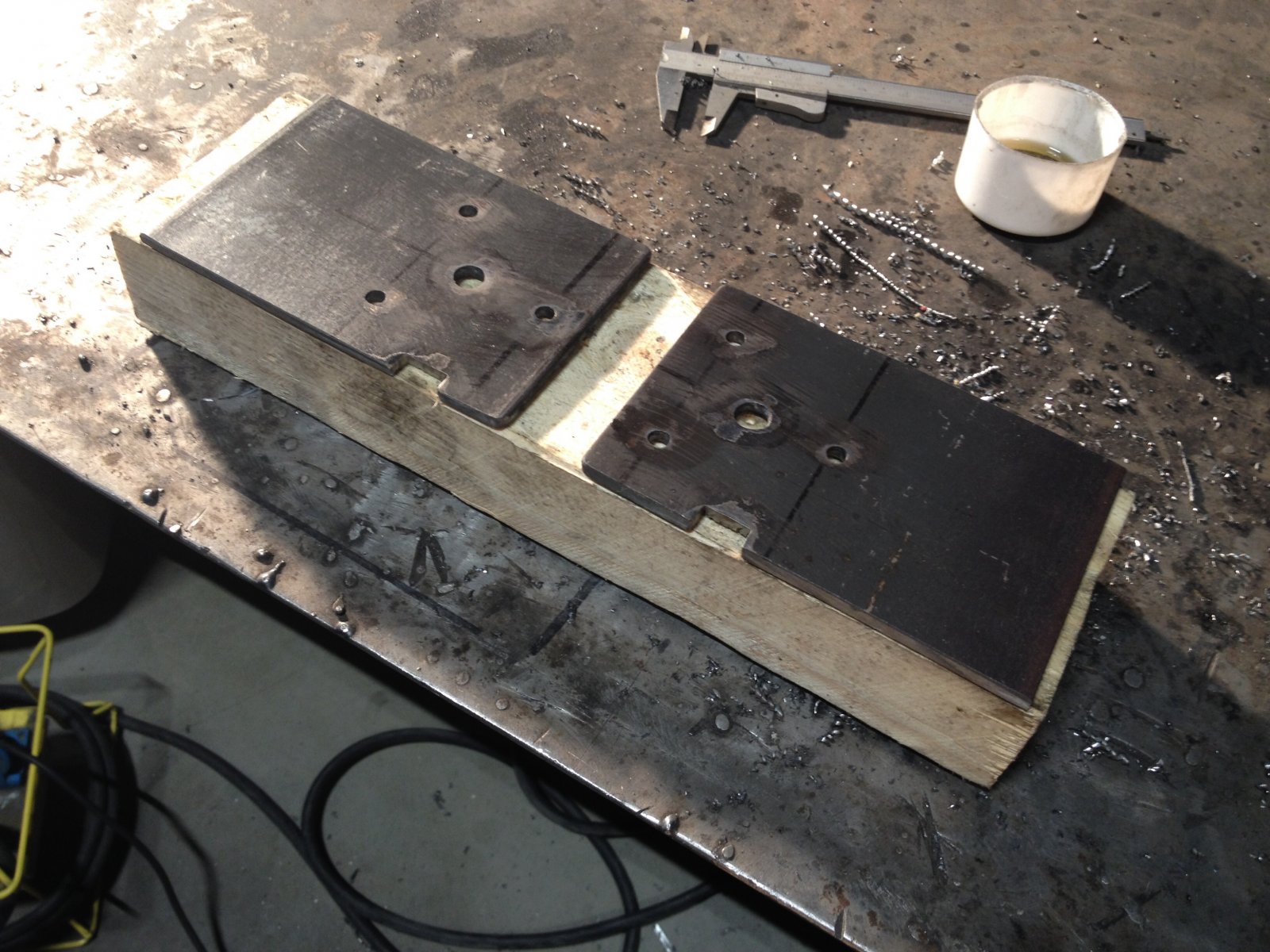

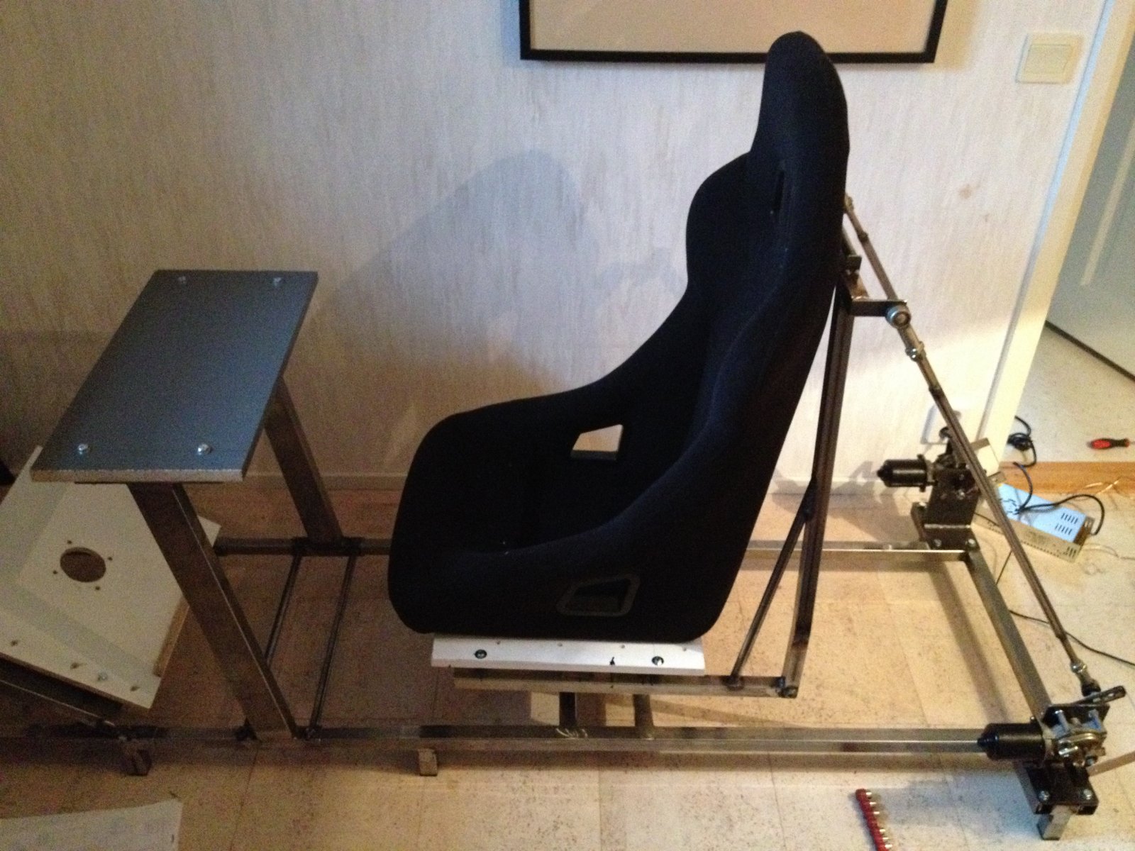

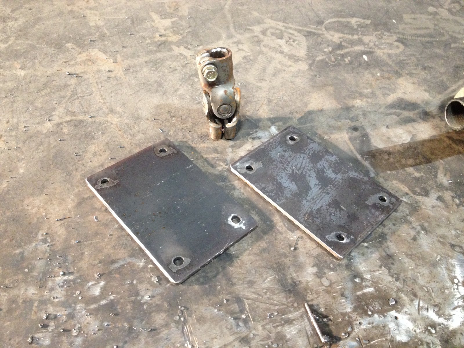

    Thanks eaorobbie, will surely post video when the time comes! Today I moved frame inside, attached seat, pedalplate and wheel plate, and most importantly got somewhat functional potentiometer mounts. There are no 360 degrees of movement available for safety, but otherwise I'm pretty satisfied for now.
    Pot mounts
    Some shots of the current state
    Next I will take some time to make/find a box for electronics and make proper wiring for them so then I'm able to start testing with the real thing!

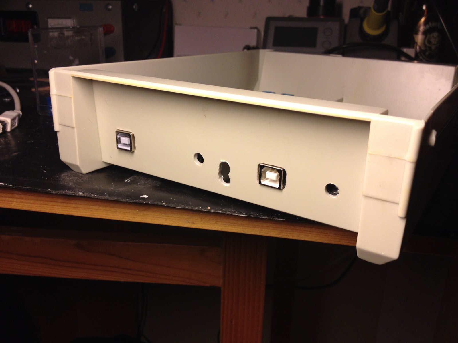

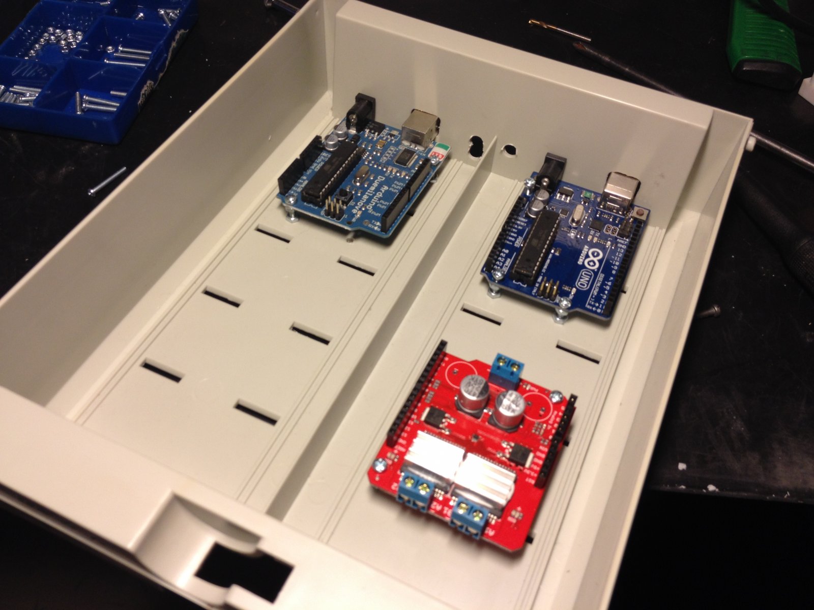

    Went to my storage to find something to use as a box and my eye caught an old diskette box and it is just perfect! :) Right size, easily accessible, under the bottom is room for bolts and center has this plate where you can organize cables.
