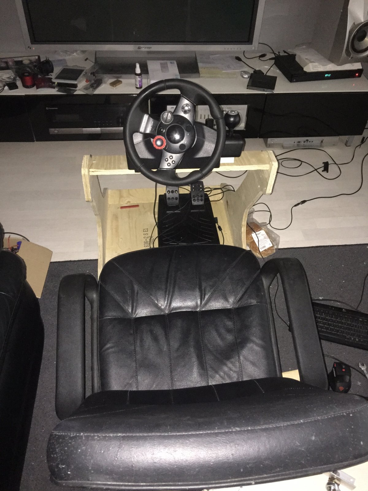

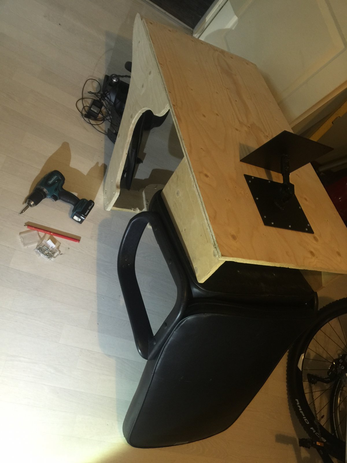

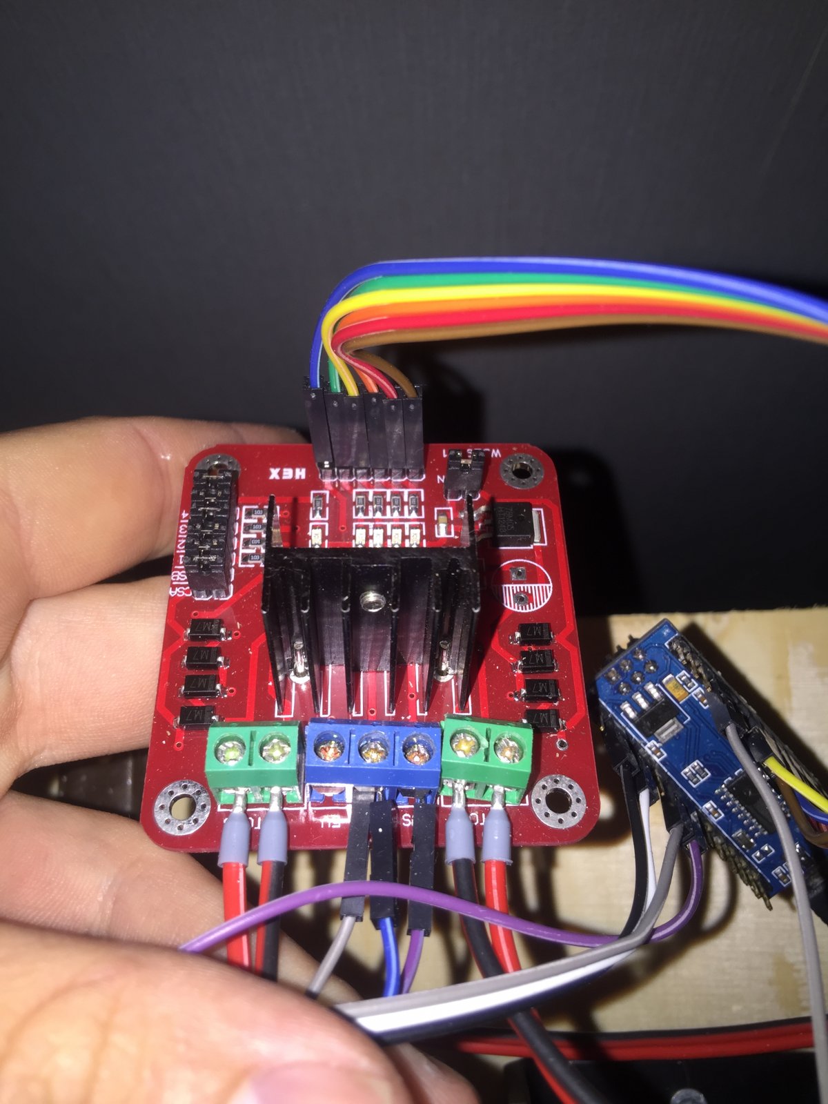

    Hello Guys, My name is Mitchell and i am from the Netherlands.
    I am a production engineer at a company which sells meteo equipment and vision stuff, so i finally got my hands on 2 used wiper motors that where laying around over here. these are 24V 30 NM.. i tested them on 12 V and felt quite strong..
    After a lot of reading on this forum i started to make a prototype.
    I got everything working now with an Arduino Nano clone and a simple L298N motor driver i had laying around.
    The monster moto is on his way from china haha, so for now i can test without load because this motor controller can only handle 4A.
    Check the pictures!
  2. Mitchell
    Mitchell Member
    May 25, 2015
    31
    Netherlands
    87Coins
    +21 / 1 / -0
    Also check out the video :

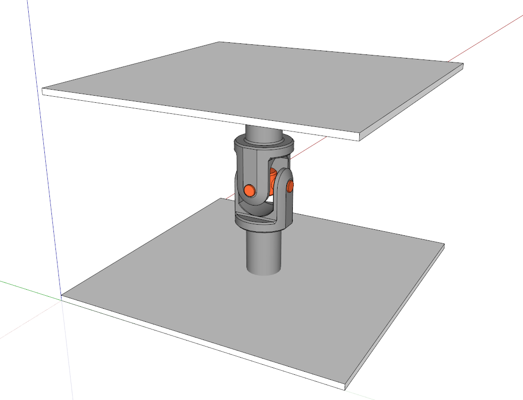

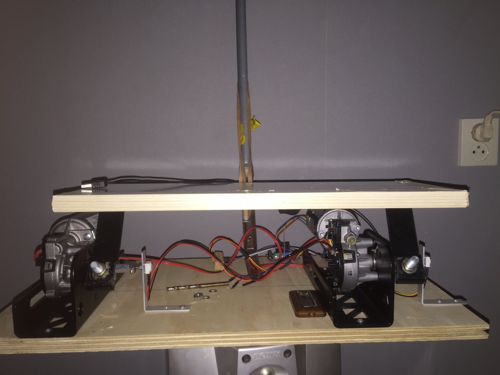

    Thanks for the description and photos @Mitchell.
    The setup does not have a pivot so I am interested in what load it is expected to carry. I would also like to understand how the the lever plates attach to the top board and motor shaft, I just can't tell from the angle in the photos.
  4. Mitchell
    Mitchell Member
    May 25, 2015
    31
    Netherlands
    87Coins
    +21 / 1 / -0
    That is correct haha.
    The prototype board and the seat are 2 different things, i still have to get a pivot from somewhere.
    Suggestions ?

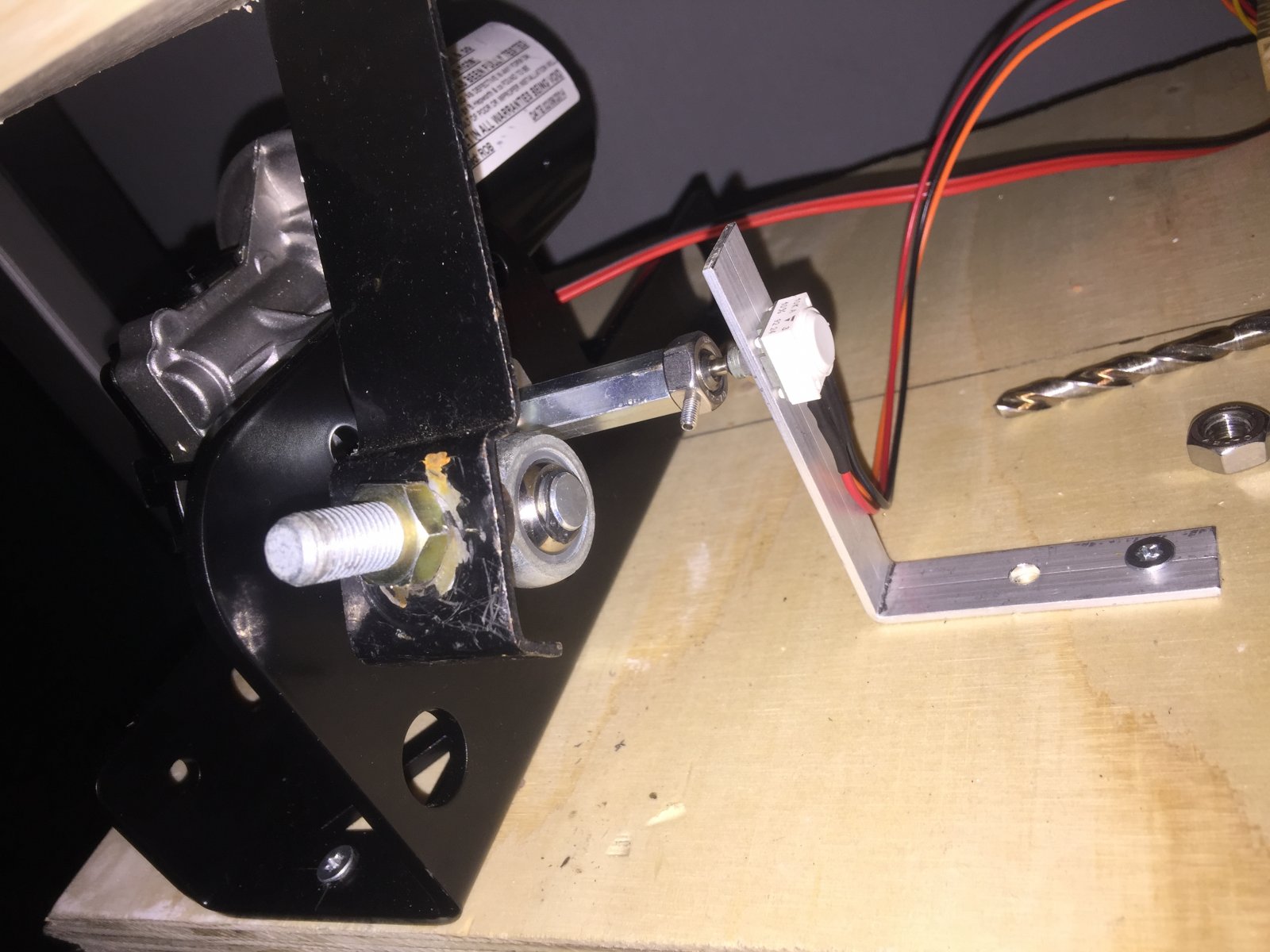

    Here you can see the brackets for motor/board connection.
    21,487
    150,542Coins
    +11,017 / 55 / -2

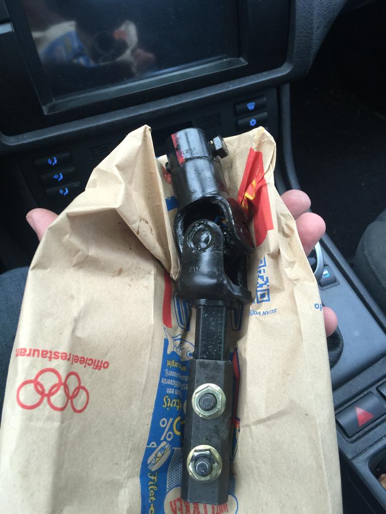

    That clarifies it then, a prototype is a useful thing to do and you gain experience with SimTools. And thanks for adding the video.
    A universal joint is much better than a CV joint for the pivot and you should plan to have it attach as close under the seat as possible. I like many others have used a uni joint from a car tailshaft, some have used the uni joint from a car steering column. Others have made a pivot joint from heim rod ends.
    I look forward to following your project as it develops.

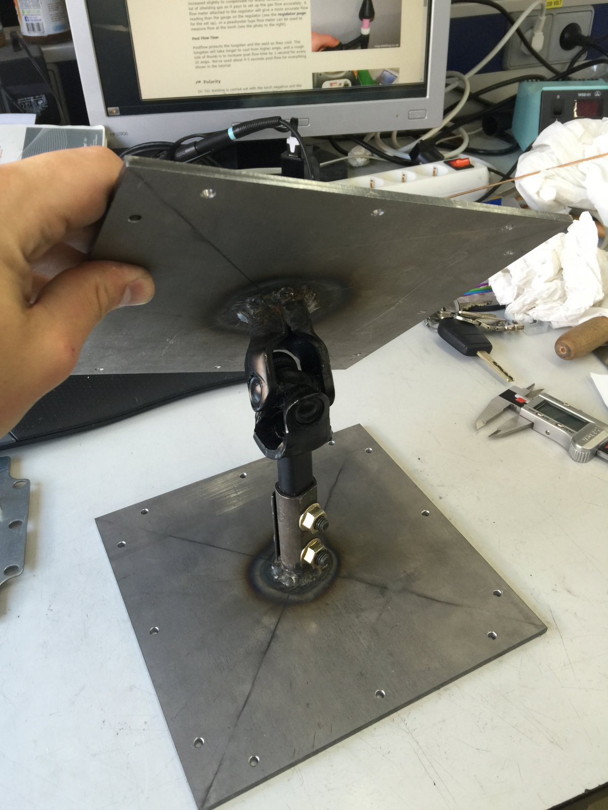

  6. Mitchell
    Mitchell Member
    May 25, 2015
    31
    Netherlands
    87Coins
    +21 / 1 / -0
    Nice! Just came from the car scrap yard!
    I'm happy.

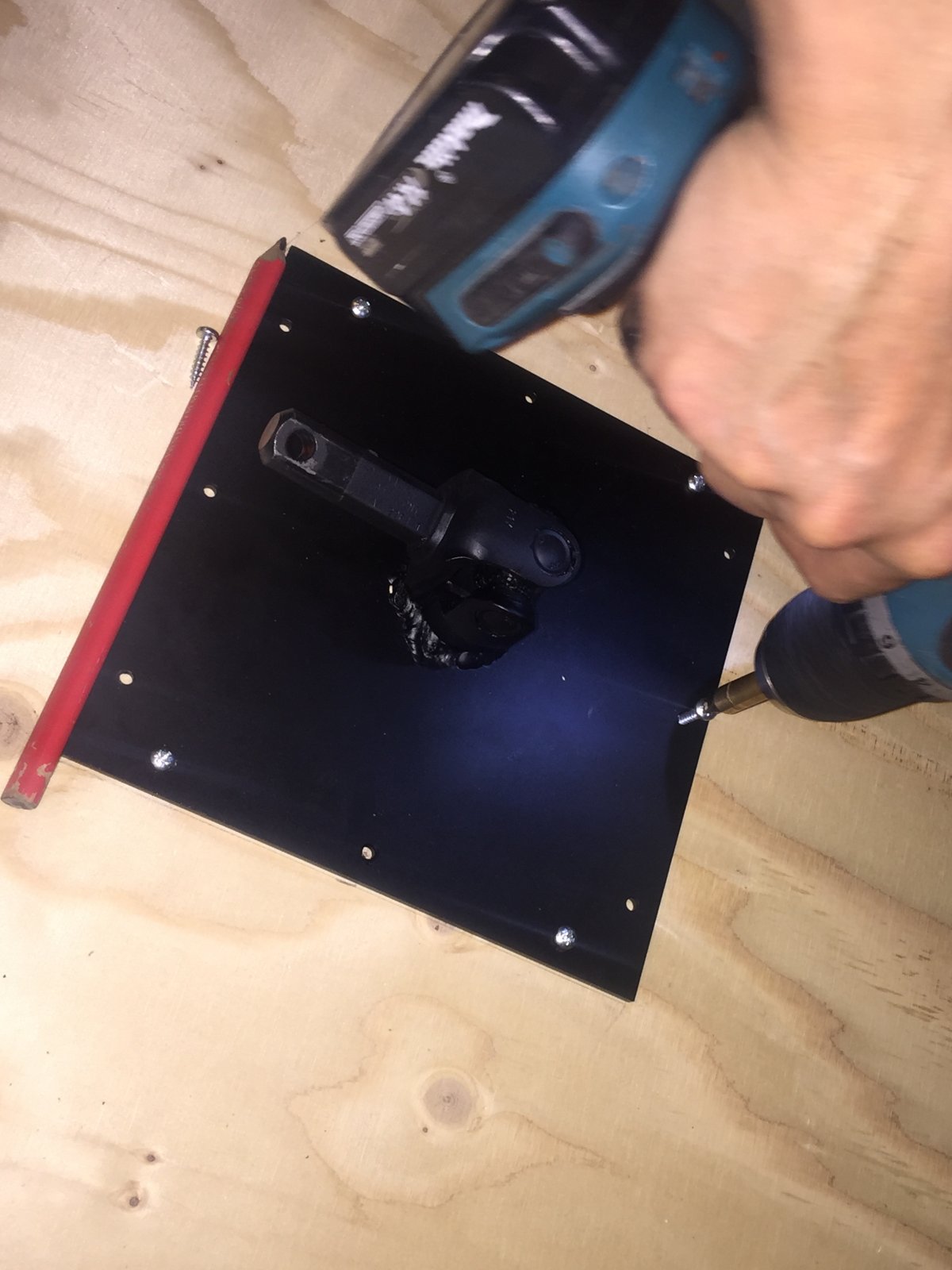

  7. Mitchell
    Mitchell Member
    May 25, 2015
    31
    Netherlands
    87Coins
    +21 / 1 / -0
    I will pickup the 2 plates tomorrow so i can start welding :)

  12. Mitchell
    Mitchell Member
    May 25, 2015
    31
    Netherlands
    87Coins
    +21 / 1 / -0

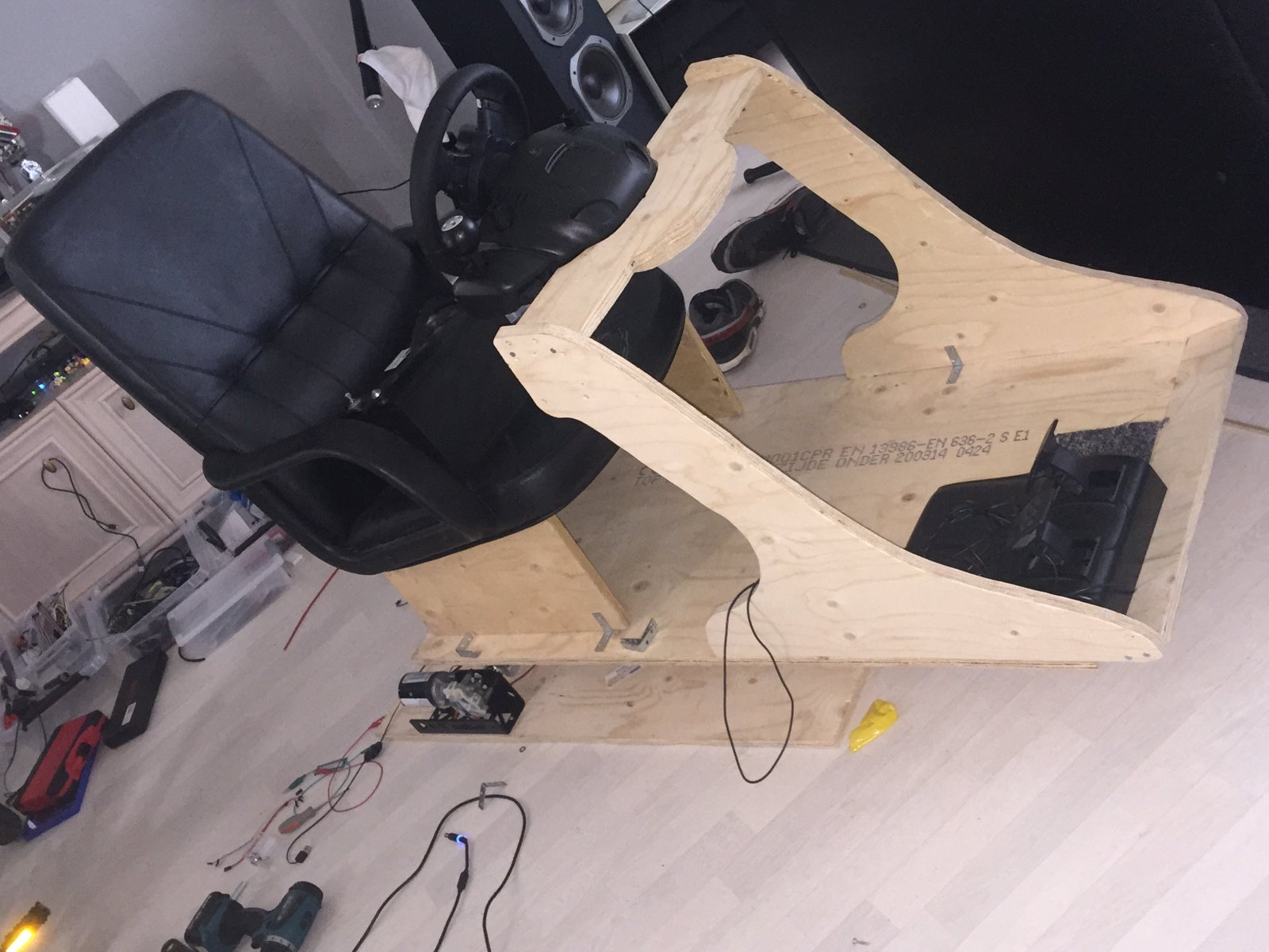

    Ok, good new.. bad news.
    I put everything together except the monstermoto's, still on their way :(
    Welding went OK, did not do that for 5 years haha but looks solid.
    I tested the motors without a motor controller, just connected it to a 12V car battery and this was the moment i got sad..
    The motors are not strong enough, these are 24V motor which now are getting 12V..
    Please see : http://www.b-hepworth.com/assets/images/Manuals/30Nm.pdf
    So... problem.. i don't want to spend 200+ euro's on new motors, so i ordered 2 of these drivers : https://www.olimex.com/Products/RobotParts/MotorDrivers/BB-VNH3SP30/open-source-hardware
    These should be able to run on a higher voltage then the monstermoto's, just have to keep an eye on the current.
    I think i will fuse them with 20A
    So, the controllers from olimex should be coming in this week.. can't wait to test
    If this isn't enough it's becoming a seat mover probably haha
  13. noorbeast
    21,487
    150,542Coins
    +11,017 / 55 / -2
    Just a thought, you could change the base board position and do a foot mount of the motors like @Archie's rig, that way you would have much more leverage for your full frame sim and a lot less strain on the motors compared to the current design.
  14. Mitchell
    Mitchell Member
    May 25, 2015
    31
    Netherlands
    87Coins
    +21 / 1 / -0
    Yeah.. good one..
    Will do some tests when i got my motor controllers ;)

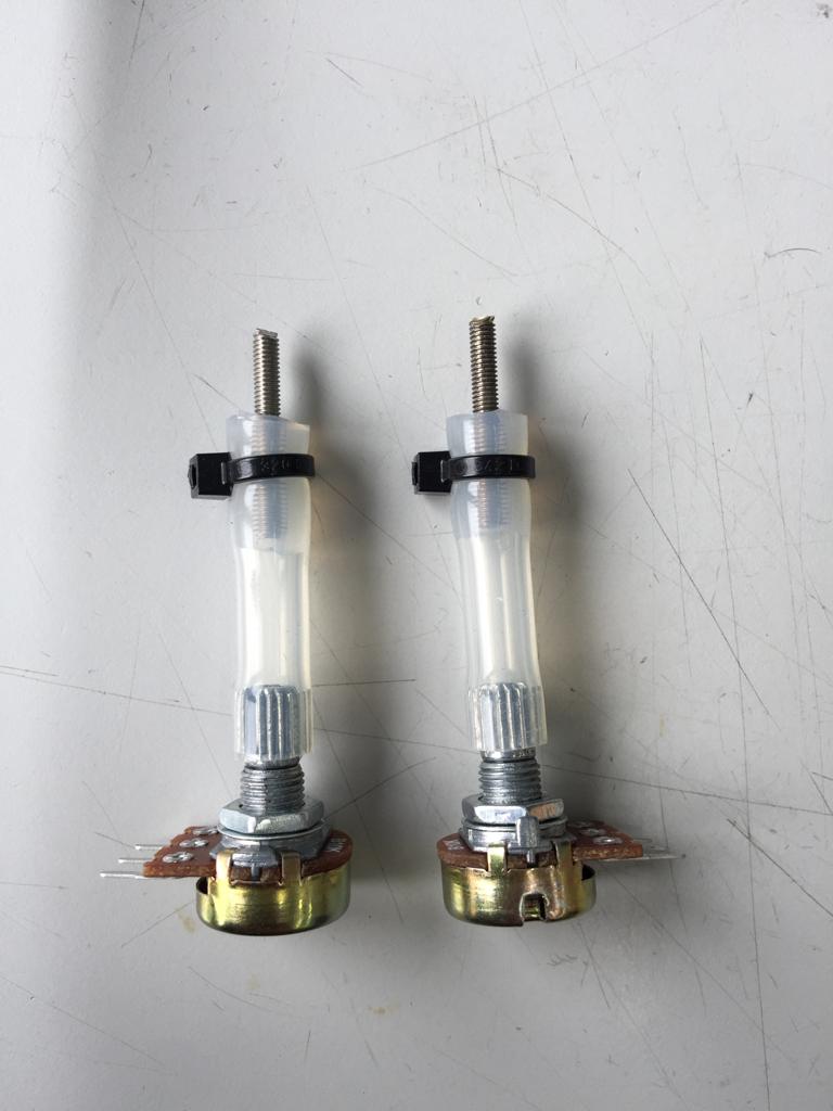

  15. Mitchell
    Mitchell Member
    May 25, 2015
    31
    Netherlands
    87Coins
    +21 / 1 / -0
    Nice, just got my controllers.
    Going to do some tests tonight.
    Also made a flexible coupling for my pot's
    I noticed the motors move a a little while operating so a flexible coupling should increase pot life.
    • Creative Creative x 3
  16. noorbeast
    21,487
    150,542Coins
    +11,017 / 55 / -2
    Having a flexible pot coupling will certainly aid pot life.
    I am looking forward to your tests to reduce the strain on the motors.

    OK, after 1 hour of thinkering i finally got my motor controllers working, i had to feed 5V to pin 2 of the controller otherwise it doesn't work. Found it in the datasheet.
    Then i finally tested the full platform, i tested on 16V and 12V and found that 12V is more realistic. When i use the system at 16V the movement are alot more jerky. 12V feels nice but isn't very quick.
    The controllers don't even get hot! i really recommend you guys these MC's!
