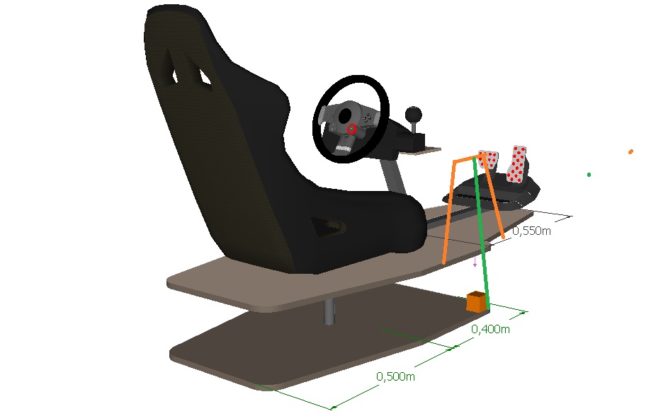

    Hi all.
    This is my 1st sim project .
    I have a limited budget (600$), because it is my thesis. But I'm optimistic :)
    I will be using 2 wiper motors, Velleman K8055, Sabertooth 2x12A, stabilized power supply 12v 500W 30-40A.
    1st 3d renders.
    [​IMG] [​IMG] [​IMG]
    Deflection +/- 8*
    [​IMG] [​IMG]
    BSFT suggest me other motor connection: 17240
    What are the advantages of this solution ? Longer arm = bigger torque ?
    Motor connection is "opened topic" i need all idea. I study electrotechnics, no mechanics ;)

  2. bsft
    As said in the other thread....
    its overcoming gravity and helping balance and improving motion overall. best get it right instead of battling with incorrect design.
    If you set them low, especially with wipers, you will struggle with the small motors, in fact, any motors.
    Best thing is make an extra bit of frame so the motor lever arm connects higher up like near your belly button level or even a bit higher.
    This was you are up near your centre of gravity and you are helping to overcome the effects of mounting the motors lower.
    It s similar principle as to why shoulder mount actuators/motors are best. They are up above the centre of gravity and take advantage of moving less mass higher up.
    After goodness knows how many frame builds, a mod like this will greatly help the motors and help improve the motion as opposed to having them mounted low.

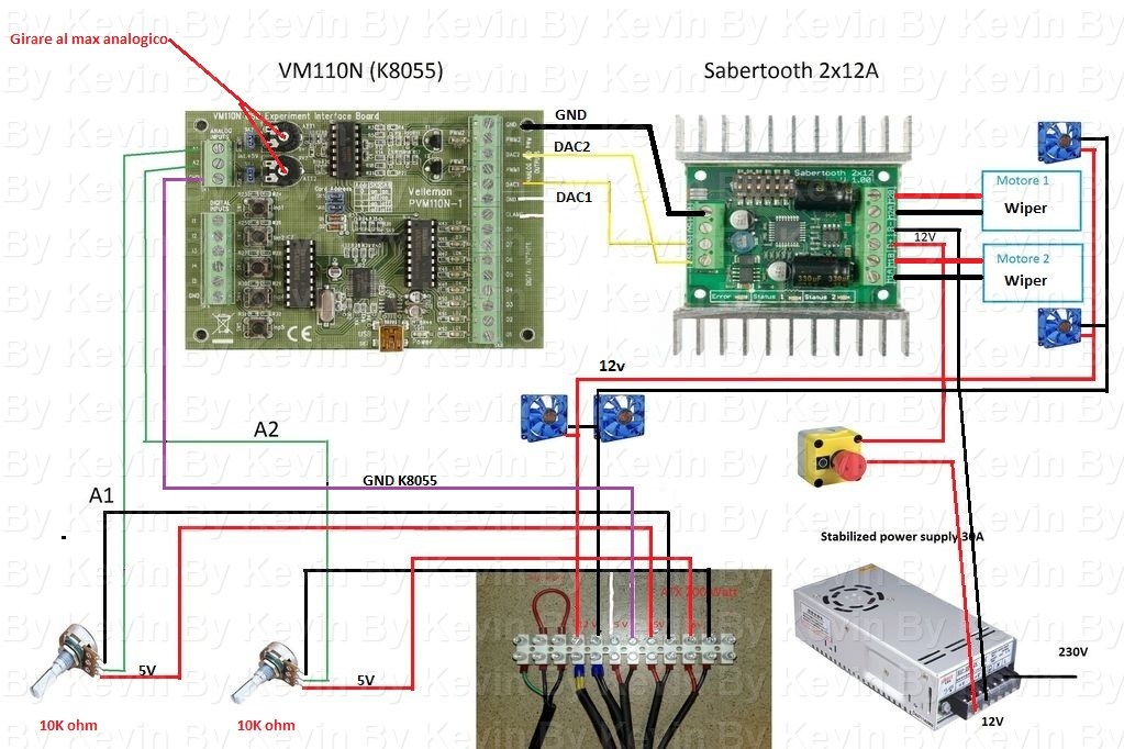

  5. eaorobbie
    20,463Coins
    +1,686 / 23 / -2
    I would advise a cheap relay to kill power to the sabertooth if power(usb) connection is lost on the K8055.
    I use a cheap relay board from DXtreame and the code uses a digital pin to engage the relay so if the pin goes low like power has been removed from the K8055 the relay trips and cuts the main power to the sabertooth.
    To make it clearer the sabertooth is driven via a DAC pin from the K8055 and it gets 0V flat out one way and 5V flat out the other way, and 2.5V is stop. So if the DAC suddenly drops too 0v as is if the k8055 is uplugged the motor goes nuts in one direction and doesn't stop, the relay catches this and stops the motor. Some use the relay to control the power switch on the psu, a better idea I didn't think of.
    Coming a long nicely.

    I sugested this wiring in my build: Today i bought Power supply (33A)
    Its bad ?? I ordered k8055n, but I thought this is it, but now i see "k8055n-2".
    I hope he will not make problem :(.
